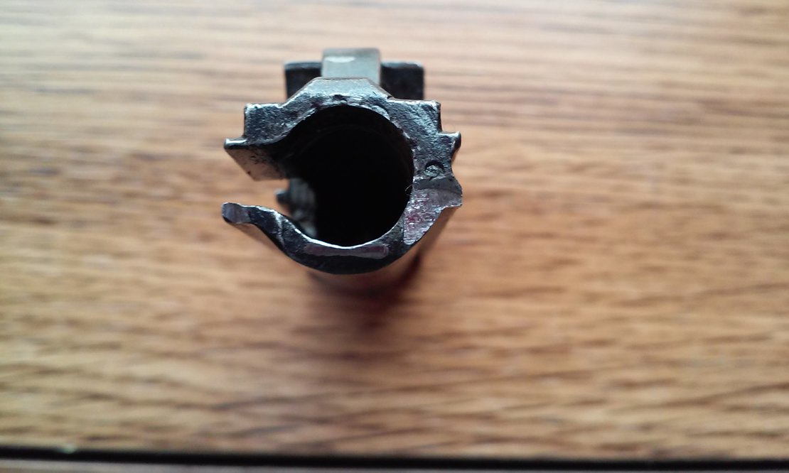

G.T. here are some better photos of the damaged breech block.
Thanks again for all of the follow up from everyone.

Well you sure blew the lips off that one Allen.

Hi Allen, it definitely shows some hard recoil, broken rear corner and such, but the firing pin retainment area looks to be unaltered? I would have to say it is most likely that the extractor retainers on the breechblock could well have failed from just a lot of use? Nothing lasts forever, and in the case of Lugers, sometimes for just a little bit? Good luck with your "NO GO" gauge and testing, I'm still here if you need any assistance that i might render?.... Best to you, til....lat'r....GT

Is that pitting corrosion around the axle pin engagement hole? Also some galling?
That would indicate moisture got inside the breech block and toggle train. Corrosion could generally weaken the entire block, as well as retard unlock and cycling by resisting rotation around the axle pin.
While the firing pin hole looks considerably enlarged (more possible evidence of corrosion inside the block), if there were no pierced primers the only path possible for high pressure exhaust gases is around the case, past the oblation ring and back into the face of the breech block before it unlocks and extracts.
That would imply that the cartridge might not be against the chamber case stop ring. Is the interior of the chamber pitted? Is there forward / rearward play in the toggle train?
Would resistance caused by friction and pitting at the breech block axle delay extraction enough to allow the blowback around the case into the breech block?

I received the "Clymer No Go" gauge, pulled the firing pin and extractor from the pistol then inserted the gauge and let off slowly on the toggle until it stopped. I then checked to see if the pistol was in battery and it was not. I applied some pressure and it would not budge. There is no question that I do not have too much headspace. I then used a sized, de-primed factory casing and added layers of tape until it would just close with no added pressure required. I measured the case at 0.764 and as noted the Clymer gauge would not lock down or go into battery even with some moderate pressure no movement. So based on the Sammi headspace being 0.754 with up to 0.22 allowance for a max of 0.776 I should be good to go on a test fire?
The more I looked at the breech and where it failed up close there appears to be almost small bubbles in the metal or more what one would see in "pot metal" or cast iron. I think as many have said the failure may have been just due to age and wear. The only issue I could see now is if for some reason the firing pin pushes through too far on a primer? The rest of the parts are all in excellent shape and the replaced "old stock" breech block looks to be new other than the number does not match.
Allen Brett is offline   Reply With Quote
