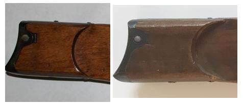

Jack: I understand why you want to cling to the idea that your stock is real. Been there, done that. But it isn't and wishing and hoping isn't going to change it.
Norm is one of the most respected and knowlegeable Navy collectors on the planet, keeper of The Navy List, prominent auctions houses have gone to him to authenticate Navy Lugers. Jerry is the foremost expert in Luger holsters, the guy we all turn to for his knowlege. As part of that he has extensive knowlege of the Navy (and Artillery) stocks. George, as a dealer, has probably sold hundreds of legitimate stocks and handled thousands of them.
Yet you cannot seen to accept their opinions.
While I'm not in their league, I have spent a great deal of time studying the German Navy pistols and accessories and building a comprehensive collection Navy Lugers and accessories.
I have offered specific reasons why your stock in not correct. While everyone has told you the brass disc in incorrect, you continue to cling to an unfortunate error in the great Sturgess books.
You refuse to accept that the wood is wrong, searching for some support for an explanation that doesn't exist. They were walnut. Full stop. There are plenty of real ones from the end of production in 1917, many never issued, all of which are walnut.
I gave other reasons, ignoring the disc and wood, of why your stock is not an original. You haven't responded to them, so I'll remind you:
The radius of the arc where the wood is recessed for the nose of the holster is too large on your stock. Real ones have a noticably smaller arc, almost a full half circle. Compare yours on the left to a real one on the right. Look at the photos of real ones already posted.
The curves at the heel and toe of your stock are too large. Real ones have a very square appearance with only a small round off.
Again, yours on the left.
Finally, others pointed out the problem with your screws. Yours are typical of what is seen in replica stocks. Here is yours compared to a real one. Yours on top.
These are significant differences. There are others, but these are more than sufficiant to demonstrate the stock is a replica.

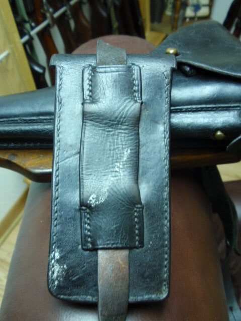

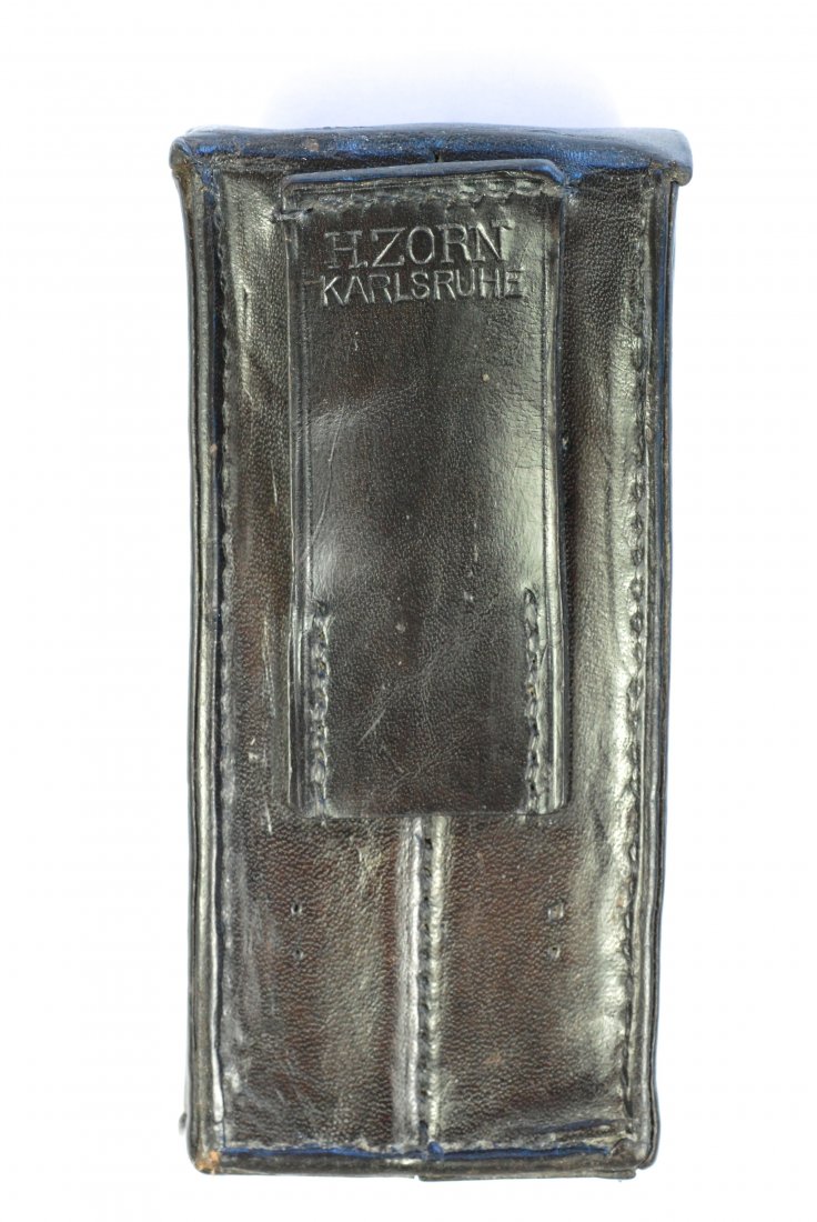

Me again, the guy who ALWAYS checks references. I read pages 31 and 32 in "The Navy Luger" twice, where does it say "not walnut"? As the keeper of "The Navy List" I am in contact with Navy collectors all over the world, and I have yet to hear of a brass marking disc on an authentic Navy stock (the List not only lists guns but stocks as well).
As to your Portuguese pouch, here is a little primer, probably wasted on you:
Authentic Navy pouches can be distinguished by their distinctive strap sheaths, 88 mm in length. Type 1 pouches (photo #1) were intended to be worn on a shoulder strap and there is no provision for belt carry, Type 2 (photo #2) were for belt wear and you can see how the stitching was modified to accommodate a belt. Portuguese pouches could be worn on a strap or a belt and they're attachment sheaths were lengthened to 100 mm to accomplish this (photo #3).
Norm

I realize I'm beating my head agains the wall, but . . .
The most recent (2012) book on handguns of the German navy, Faustfeurwaffen der deutschen Marinen 1849 - 1918 states on page 215 "After 1910 a steel marking disc was inserted in the wooden shoulder stocks."
The actual ReichsMarineAmt directive ordered that discs similar to those used on the Navy's Gew98's be used. The Gew98 marking discs are all steel. Here are two, one on a 1906 DWM Navy Contract rifle and one on a 1916 Spandau issued to the Navy.
Finally, the idea that they may have switched to brass at some point is, frankly, preposterous. Brass was a strategic war material in critically short supply, so much so that the Navy even asked the sailors to forgo the brass nameplates on their ditty boxes to conserve the metal. They switched from brass to steel whenever they could, not the other way around. Yet my unissued stock is from the tail end of Navy P.04 production, among the last made. It has a steel disc, just like the rest of the real ones and my early 1906 one.

One last comment, then I shall give up trying to help and/or educate you.
Disc aside, you still have not addressed any of the other problems your stock has. Look in "The Navy Luger" or any of the large number of photos of original Navy stocks in books and on the web. Carefully compare the shape to yours. It's the wrong shape, made out of the wrong wood, with the wrong disc and an attaching iron held on by the wrong screws.
