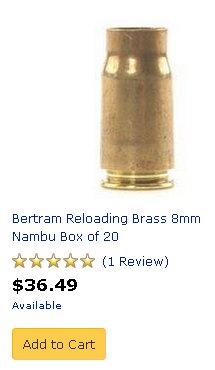

Just as a FYI, Midways has 8mm Nambu brass for ~$37/20rds...Current date is 15/16 Sept 2014..."Available"...
I only mention this because I've never heard of 'Bertram' reloading supplies...
http://www.midwayusa.com/find?sortby...ensionid=20372

Unread 09-16-2014, 05:32 PM   #64
Thanks: 2,750
Boy, at that price for the brass, one would search long and hard to locate every spent round.....approx. $185/100.
Or you could go back to the first post and roll your own...

So true. One just has to determine which is the "less painful'.

You'd be better off buying reloads from "Mr. Nambu" at a buck a piece! Cheaper, and you get to shoot 'em once before you reload!
