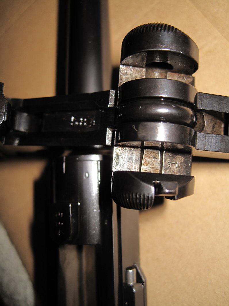

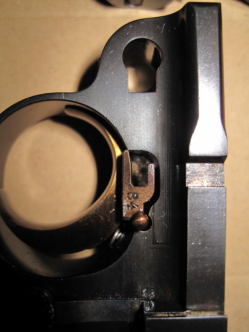

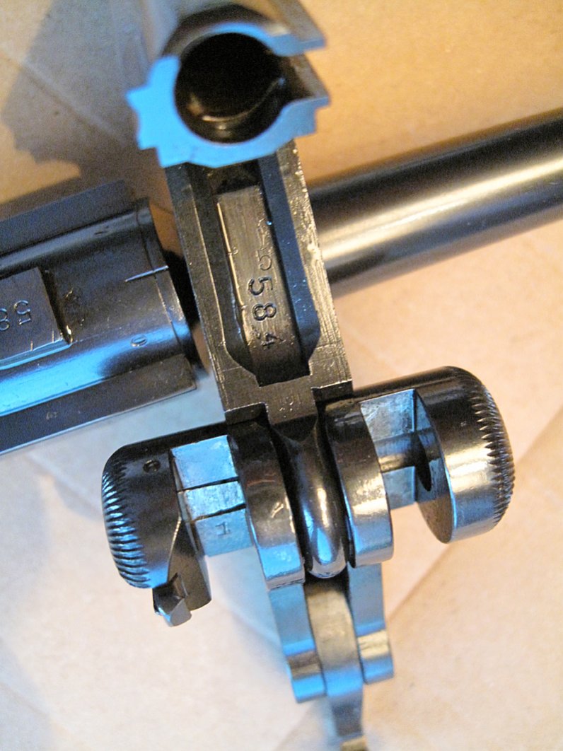

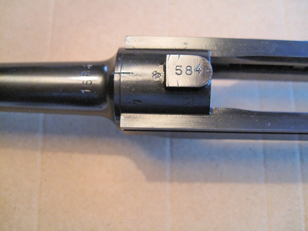

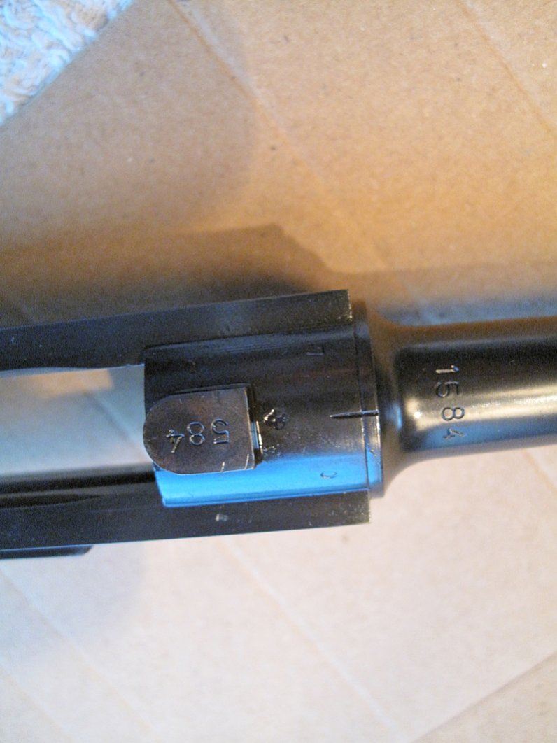

pepe
Join Date: Dec 2006
Location: portugal
Posts: 37
Hello friends
.A gun whith 72 post in the Lugerforum a is always interesting object !!
Meanwhile I dismantled it and I'll post some pictures of the marks I encountered.
Do you agree the numbers are all false?
thanks
pepe

Pepe,
I agree that the numbers are all false. It appears that the entire gun, except for the trigger, has been renumbered. I have a 1900 Commercial, #3453, which is not very far from the serial number of your gun. The numbers "4" and "5" are common to both guns and it is clear that the font on your gun is incorrect. Also, the numbers "1" and "4" should have a lower serif or "foot" which your gun does not have. If you look at the number on the trigger of your gun, you can see what the "4" should look like, and the small "1" inspector's mark on the under side of the toggle knob is what the "1" in the serial number should look like.

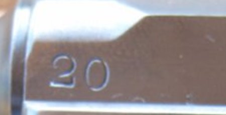

Hi Pepe
You have an interesting gun, yes it has been restored and as such will drive collectors crazy with speculations.
Many consider a restored gun to be a fake no matter what the quality, it is hard to discuss possibilities with thoes who see things only in that light.
Your gun has several issues, Ron says the numbers are not correct and I agree with him, but this is common to many restorations
What is the 20 number? It could be an inventory number from a school, a police department, a special security guard force, guns hand selected for a special purpose from a larger batch. It could have a dozen or so reasons for being.
I would try and find some connection, go back as far as you can in its history of ownership, you might find the answer.
The made in Germany stamp is not just a one way stamp, often we find guns that have come originally to the USA and then back overseas. We sometimes forget that we had marketers who would have sold guns not to just the USA but to oversea contacts as well had the opportunity given itself.
It was all about making money.
Don't give up on your gun, it is very nice to look at and could have some historical importance. You may never be able to prove it however.
I noticed something in one of your pictures that I did find interesting, there is what appears to be the remnant of a Crown B at about the one o'clock position near the 20.
Hard to see but I think something is there.
Thanks for posting Pepe! always interesting

Vern,
I believe your observation is quite possible as there appears to be the remnants of a crown at that location. It would seem appropriate for a gun of this vintage.
