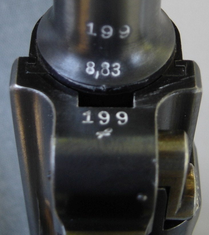

I also have a question on the marking on the barrel. Normally I see 8.82 on the barrel, but 1911 sn 199f says 8.83
I know it is only .01mm difference, and I know about manufacturing tolerances. But why then mark it on the barrel?
Piet

Any comments on the 8,83 marking on the barrel (see previous photo)
Does our reference to 9mm parabellum means the exact caliber is 9mm, or is it 8,82/3 mm?

Piet,
8,83 is the land-to-land measurement of the bore of this pistol, within acceptable tolerances for 9-mm Parabellum cartridges.
Don

Don,
Does land to land means - not groove to groove?
Piet

Posts: 1,429
Thanks: 67
Exactly!

Piet, looking at about ten 1910, 1911 and 1912 P08's the measurements are 8.82 with a few 8.83.

Piet, another way to look at it is that it was the bore diameter before the rifling grooves were cut.
