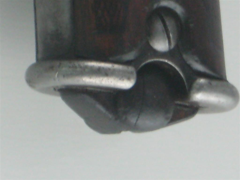

Here is a Loewe over the chamber with a stock lug. This rig is for sale.

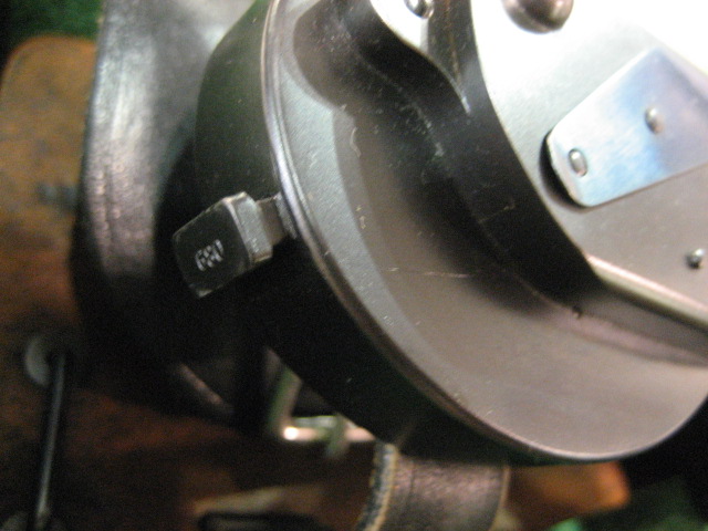

Close up of stock lug.

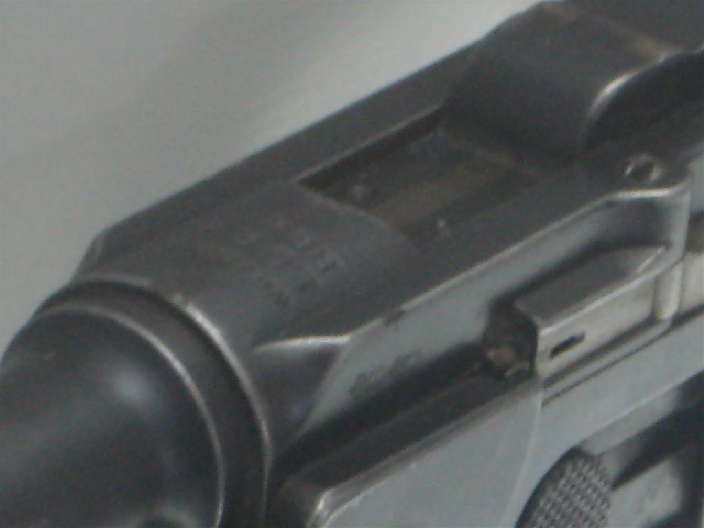

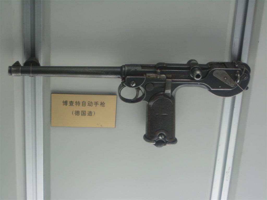

A Loewe Borchart in Beijing Military Museum. Enjoy.
P.S. -- By reviewing those pictures, I am not sure.... halo on chamber marking??
Unread 03-24-2008, 02:25 AM   #75
Alvin,
Thank you for the link to the Beijing Military Museum Borchardt. It is obviously a Loewe piece. Is there any indication of the serial number?
Unread 03-24-2008, 02:33 AM   #76
Ron -- The lighting is poor, and it's locked in a glass cabinet. I will carry a telescope with me to visit again to find the s/n..... in a few days. Will also try to take clearer pictures.

The placard says "Borchardt Automatic Pistol (Germany Made)". There are tons of Broomhandles, 1911s, HP35s, Nambus, S&W revolvers, etc in the Museum, but only a single Borchardt. Interesting enough, there are also four Lugers: a 1920 commercial, a DWM Army 9, an Artillery, and a ?? (I cannot remember), all 4 Lugers are in 10% shape.

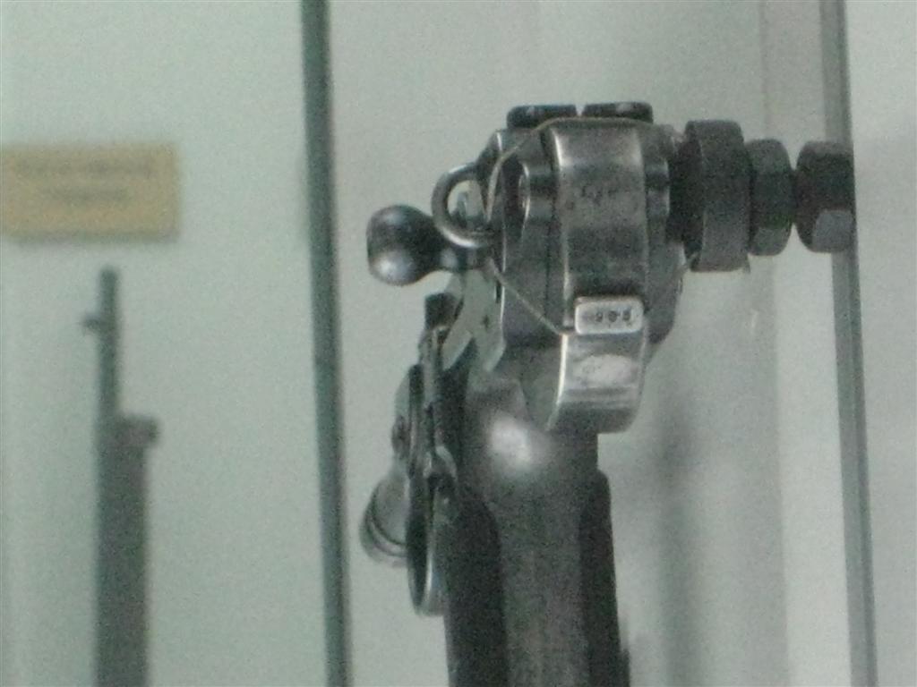

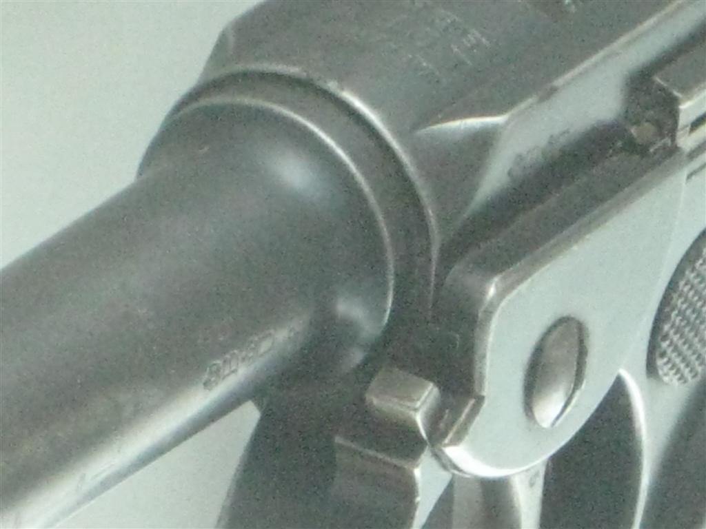

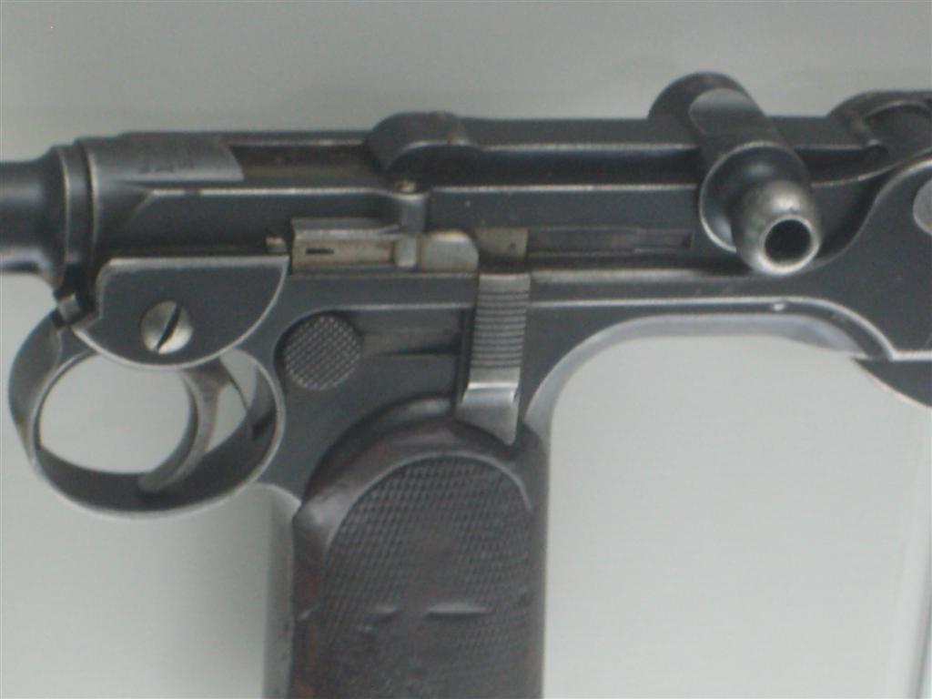

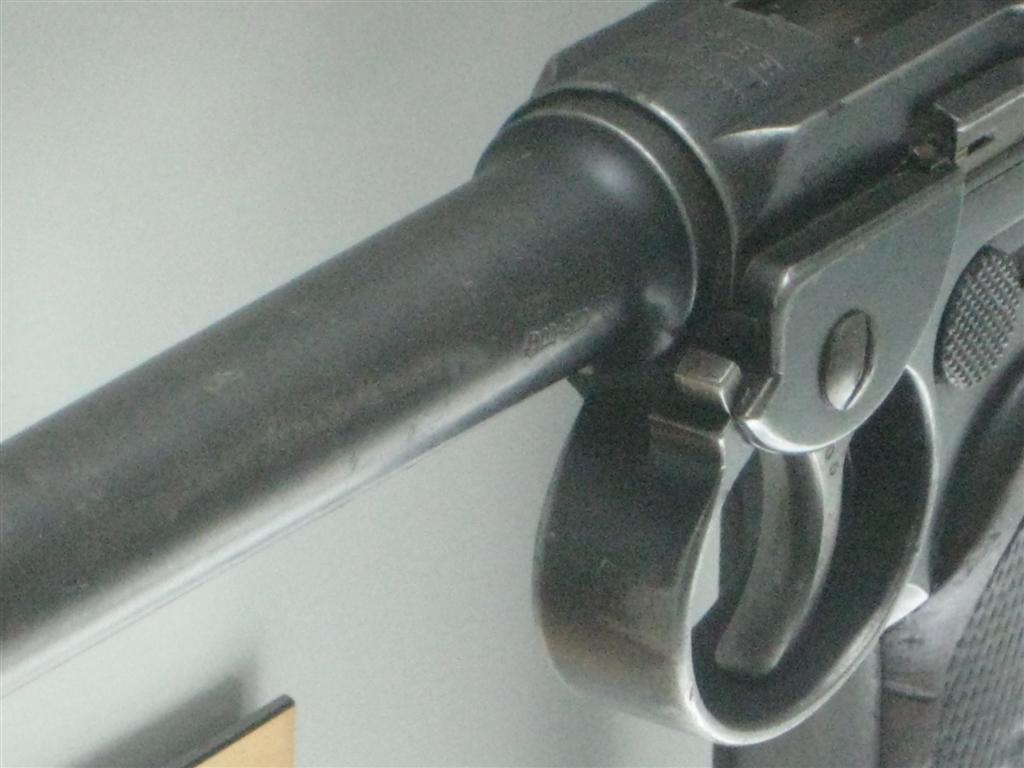

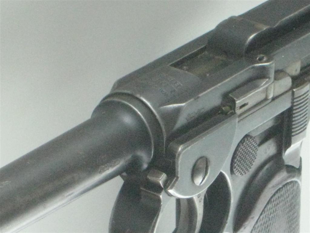

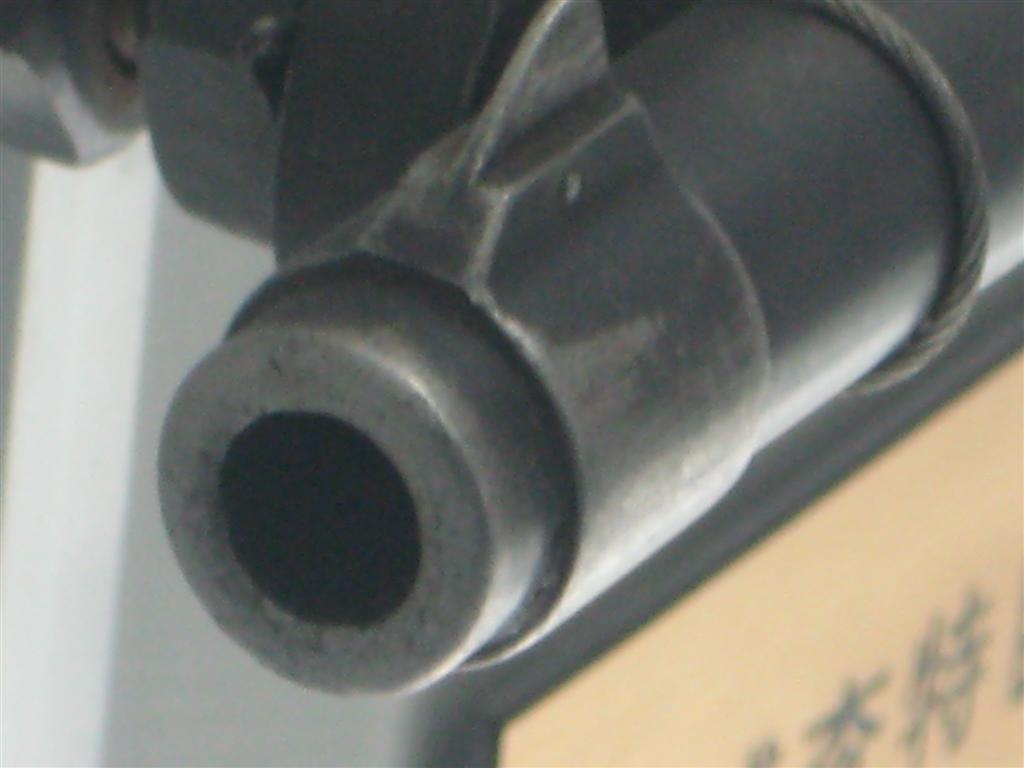

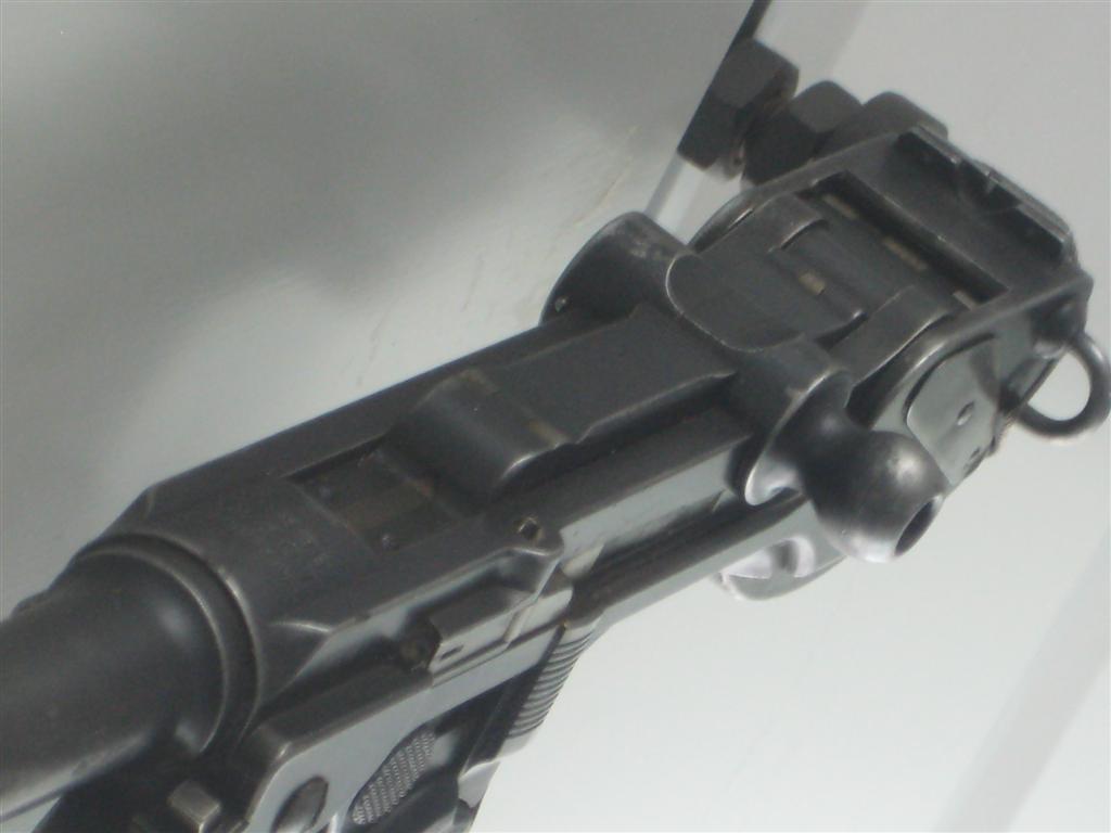

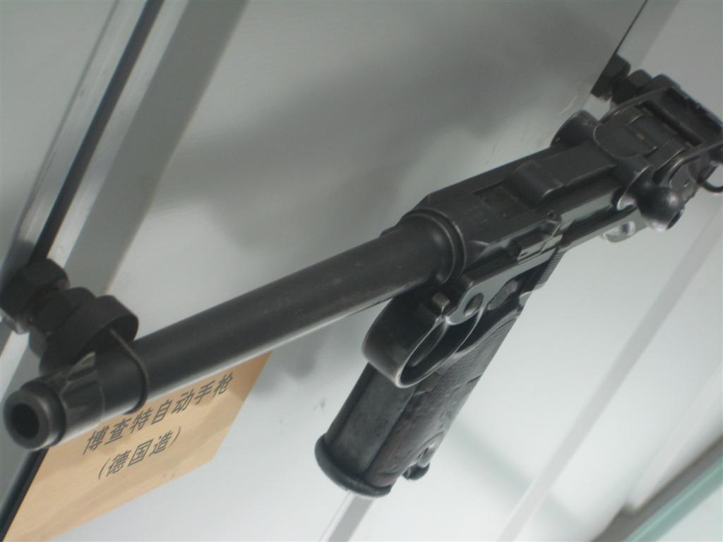

S/N is 905.
I did my best, even spent $12 to get a 10x binocular. People must feel funny seeing a guy standing 3-4 feet away from the gun and watching it with a binocular. Unfortunately, it did not help at all. I could not focus the lens. I took 200 pictures, the following three are the best quality ones that I could create.
The same camera did a little better this time. s/n is 905. The middle 0 is unclear from the first picture, but it's visible on the trigger.
Two more pictures showing the BUG on barrel, and BU on receiver. For some reason, the camera did not catch C/G clearly, but it's there.
Two more pictures... same thing, but might be better (??)
