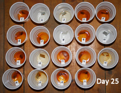

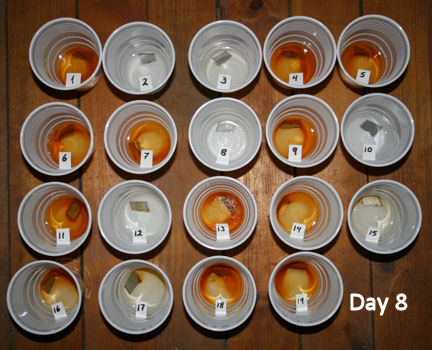

I'm now back from a Jakarta Indonesia. For those interested in how things are going after the flooding one month ago, for me things seemed mostly to be back to normal. Though there is a large contrast between rich and poor.. help is still needed.

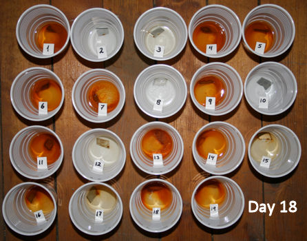

Anyway, here is how they looked when I got back yesterday. After 18 days.

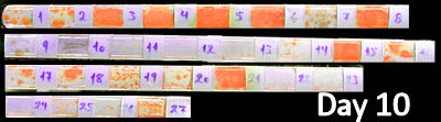

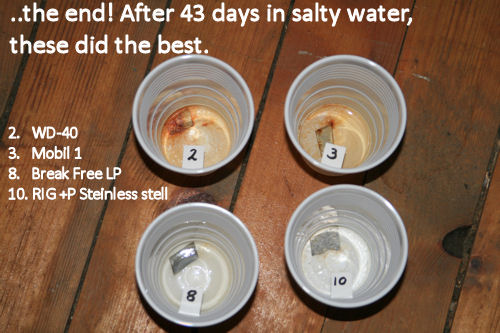

Days have come and days have gone.. This is a final update on the results!
Even after 36 days, it was still hard to seperate "a winner". ..so I did a little shake to speed things up.
Stubborn as I am, I don't stop there..
Will come with an update later on, when I find the time.. Have a nice weekend!

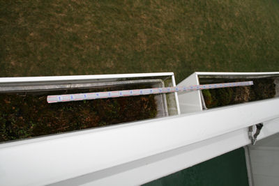

It's a rainy day outside my Oslo appartment, so the brave test subjects got a tough start
..ever wondered what those boxes outside the porch is for? Well.. I think I found the answer

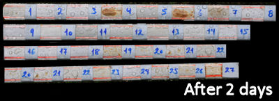

After a rainy night, rust is starting to show
..it's quite impressive that #4 'Aluma Guard' and #6 'Hoppies oil' actually makes the sample area rust faster than #27 wich is without any, just as they did on the first test..

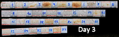

After another day, with a combination of snow and rain.. this is how they are doing;
If I should try to range them from bad->good, it would be something like this; #4, #6, #27, #19, #26, #25, #21, #7, #1, #20, #13.
The rest, is still going strong
*update*
..third day in a row with rain..

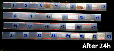

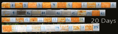

The last 24 hours has not been kind to the samples!
Some has gone from almost no rust to all rusted within just 24h..
It has been a foggy day.. and this is how they look now;

Interesting results. Faith in my trusty gun oil is somewhat restored

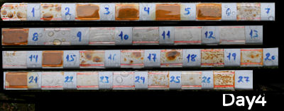

Yes, the results are quite different! ..Think this test is a little more relevant, think (and hope) that you guys are not storing away your luger in salty water
I will be away on a work trip until the middle of next week, so there will be no update until then. Take care and have a nice weekend
*new update 3th May*
*taken 13th May*
From good to worse; 12, 24, 13, 22, 9, 10, 11, 23 and14 ..the rest is hard to seperate..
