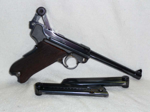

Unread 01-25-2009, 11:02 AM   #68
cz75bfr
Join Date: Jan 2009
Posts: 5

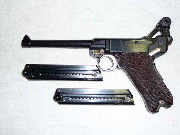

Hi,
I am new here.
Hope someone can give me more info on this weapon.
What is a likely date of manufacture what is the value?
Seller says bore is perfect, pistol is perfect, blue is perfect, only the grip safety has some loss of blue.
Seller did not give me the serial number.
Thanks in advance
Fred
cz75bfr is offline   Reply With Quote
Unread 01-25-2009, 01:18 PM   #69
Well, it's post 1972 but we cannot give a detailed date without the serial number.
If the gun has the antler Ulm proof mark, a year code either in letters or numbers should be present.
Most likely it's a 1973 pistol.
Value also depends on box, accessories, test target, manual, etc... being present.

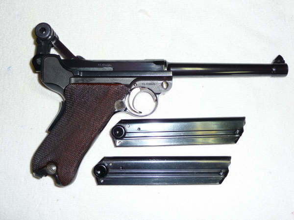

Unread 01-25-2009, 01:22 PM   #70
mauro
FIREARM HISTORIAN AND AUT
mauro's Avatar
Location: Belgium
Posts: 1,535
Thanks: 106
Hello Fred,
Your pistol is a so called 06/73 model.
Without serial number it is difficult to estimate when it has been produced but most of them have been made in the 1973-1975 timeframe.
You can see some of them for sale with the related price in the Simpson web site (see link & resources).
Have fun,
Mauro
Unread 01-25-2009, 02:46 PM   #71
lfid
Location: Wichita, KS USA
Posts: 453
Thanks: 573
Thanked 96 Times in 53 Posts
Fred,
grips on this one look much nicer grain and color than most Ive seen
recent auctions for these P08 frame MP on gunbroker have been $1000-$1200 , the $1000 after redo auction price reduction sold and was a 30 cal 6"
Bill
Unread 01-25-2009, 03:05 PM   #72
cz75bfr
Join Date: Jan 2009
Posts: 5
Seller tells me Serial is 11014xxx
No box, Test target, just nothing exept for the two magazines.
He wants 1300$ is that over the top?
Some more pictures:
