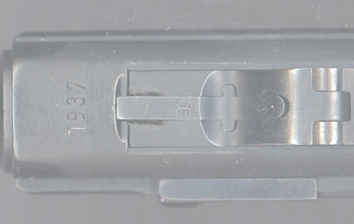

Thanks: 1,342
Default Thanks Mark
Hi Mark and all, I think the only reason for the stops being there in the first place was to reduce over and repeated full compression if the extractor spring? Thanks again Mark, til.....lat'r.....GT...
Unread 12-26-2021, 09:25 AM   #47
Under normal operation, those little projections do not touch the breech block itself.
Grinding them off intentionally is a practice I've not heard of before - I don't think such was ever an "approved" practice, JMHO.
If the projections did not serve a purpose they would not have been included in the design or would have been eliminated during production- they would simplify mfg. of both the extractor and the recesses in the bolt quite significantly.
I believe such purpose is to aid in retention of the extractor in the breech block; without them there is nothing to prevent the extractor from moving forward and out of the block except the curve of the projection under the cross pin. Of course later on the Swiss altered the design to a full circle for the pin- did they eliminate the forward projections ?
I don't collect Swiss lugers, so can't check an extractor for its shape; GT ? Luger doc ?
The chips in the picture are a well known type failure, but not one frequently encountered - it can only be caused by a major malfunction = a punctured primer/ruptured case and the resulting significant gas leak.

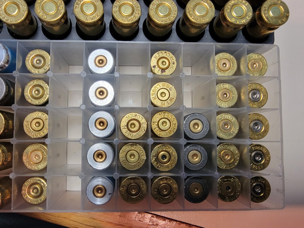

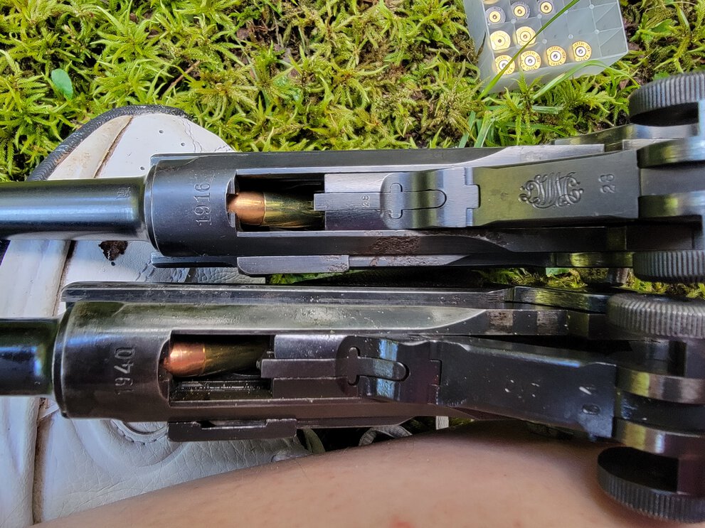

German Blue practice ammo, did what I expected. It was my test of ammo which should test that the firing pin works. It goes pop and the little plastic bullet hits the target. It doesn't have enough power to move an action. (If something was seriously wrong with firing pin or action or...it is the safest way to know.)
Remington worked just fine.
WinWhite Box works just fine.
Wolf steelworks just fine.
Norma, Fiocchi..Unreliable at times. I am guessing they are too powerful and the action is moving to the rear and coming forward too quickly. The bolt doesn't hit the rear of the cartridge. See Photo.

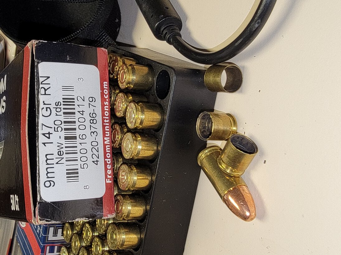

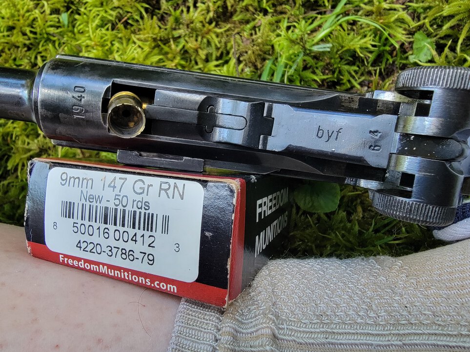

Then I tried some Freedom Munitions.
I have never seen stepped brass.
I have never had head separation in a pistol round.
With Freedom Munitions, I had both.
First round ran fine.
Second round left half the brass in the chamber.
I spent today chasing Freedom Munitions around and trying to get the brass out.
Freedom declared bankruptcy taking no liability, but selling the name to the next company by what appears to be the same people.
Perfectly legal, but not ethical by any means.
It appears I also had a 90 days to tell them there was an issue with the loaded ammo. So if you don't shoot your ammo every 90 days, you are screwed.
OK, off the box...
If anyone else has this issue a 3/8s drill bit hand turned with plyers is how you remove stuck half brass in 9mm. It is perfectly sized for the brass and not hitting the chamber.20220908_180630.jpg
