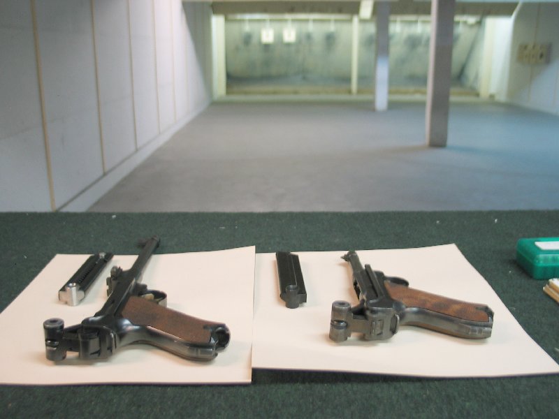

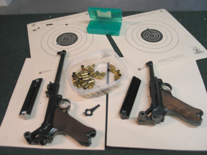

Surprisingly, yes. No stovepipes, no failure to feed, no hangups, great ejection (back and to the right this time). It did take me the better part of a box of reloads to get anything on paper. I need to hold down and to the right to hit the black. <shrugs>.
Those lighter grips do appear a bit chunky and like they really don't fit too well.
The bottoms are thicker than anywhere else. Looks ugly. I'll stick with the Numrich grips for now.
The shooter Luger shot quite well, didn't have to hold anywhere off paper. I shoot 6:00 o'clock sight picture. Shooting it after shooting the heavy long barrel took a bit of adapting. But after I got it where I wanted it and ran a couple magazines through it, I did manage to get 5 in the black. Not all from the same magazine, but hey, I'll take it.
I shot 115gr FMJ ahead of 5.25gr of W231 in both Lugers, left over from many years ago. Probably too much powder for a Luger. My Hornady book shows that combination @ ~1175fps...

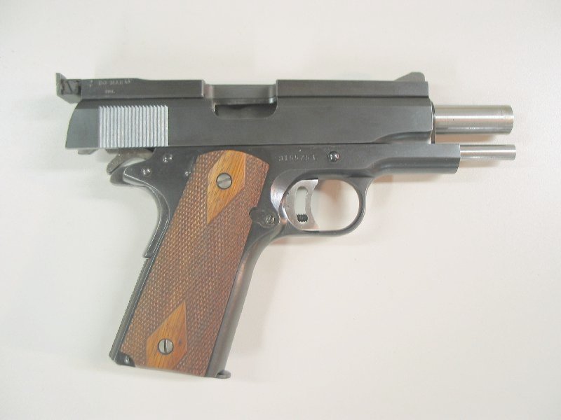

Unread 02-09-2019, 03:25 PM   #45
This section is a continuation of the 'Full Length Guide Rod' fabrication that I left off on page 2 post #38.
I had finished the guide rod itself, but still needed to fabricate a guide rod plug. Here's a 1911 plug being machined (same process as for the Commander).
1. Turning down a piece of CRS to the required diameter and length.
2. Drilling out the plug; two size holes. One for the recoil spring, the other for the guide rod.
3. Using a parting tool to cut the plug to the desired OAL.
4. Finished guide rod and plug.

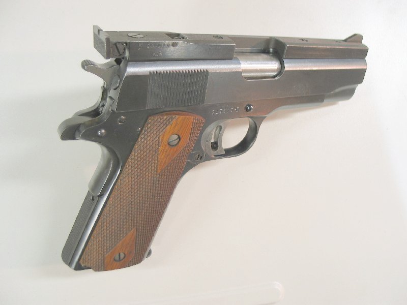

I've had a Colt Combat Commander slide and frame that I acquired 'in the white' back sometime in the 1980's. I finally decided to build it up with a Sarco 1911 'parts kit' a year or so ago, and Charles Danner blued the parts for me. I had been browsing eBay and noticed that a seller had an original Bo-Mar full-length rib for the Commander, so I acquired that and mounted it on the Combat Commander. I assume everyone here knows how to drill & tap holes in steel, so I didn't bother to take pics of that. I did substitute #6-48 screws instead of the supplied #6-40 screws. This gives me an extra thread in each hole plus a slightly larger base diameter for each screw. I changed a couple other parts, like one of my skeletonized triggers and a flat checkered mainspring housing. Just because I liked the looks.
It actually came out pretty well. I find it humorous that Bo-Mar actually made a rib for the Commander, incongruous as it may seem.
The rib seller included the original 40 year old instruction sheet, stored in the original plastic 'cigar tube' that Bo-Mar shipped the rib with. I'm including it here for any 1911 enthusiasts who contemplate attaching a rib to their 1911.
I have another 5" 1911 with an attached rib, I plan on taking both of these ribbed .45's to the range and see how well they shoot. I had taken the Combat Commander out and shot it before the rib and was once again surprised how well it grouped off a sandbag. It shot 4" low and 6" to the left, I'm hoping it's a bit closer with the rib.
