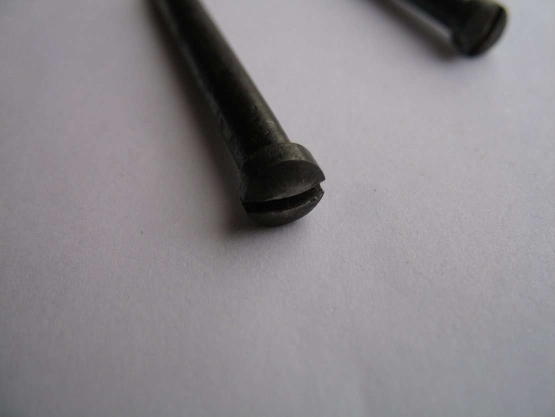

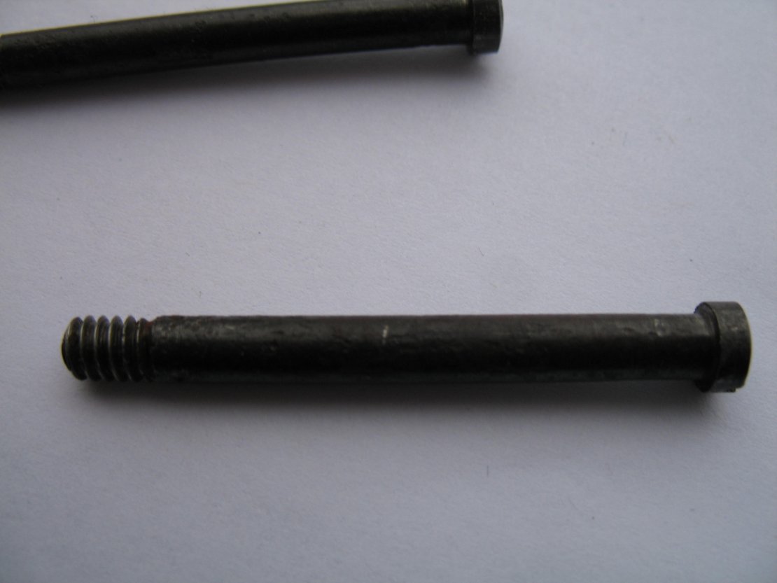

Hopefully, pictures of the stock iron screws I got from Patrice are attached. They are very good for original screws and they fit the iron perfectly. The overall length including the head is 1.592". The diameter of the shaft and thread O.D. is 0.151" which is a little less than 4 mm. The head diameter is 0.212" which is a little less than 5 mm. The length of the shaft and threads is about 1.5" with the threaded portion about 7/32" long.
I did not have a thread pitch gage, but I measured across 6 thread peaks which is the length of 5 threads and got a result of 11/64". Admittedly this measurement is quite hard to read. Five threads at 11/64" equates to 29 threads per inch. I have never seen a screw pitch that is an odd number. Also the 5 thread measurement I took would vary less than 1/64 between a pitch of 28 and a pitch of 30, so I can only say for sure that the pitch is 29 +/- 1 threads per inch. This is very different from a 4 mm thread which is about 36 threads per inch.

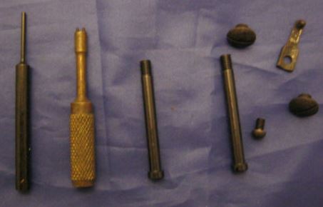

I offered eBay seller $55.00 for the stock lug screws and was pleased with the purchase. Only place I know that you can also get the Artillery front sight adjustment tool included. Seller has eight more combo's available.
http://www.ebay.com/itm/Luger-WWI-St...item3a7cdd140c
