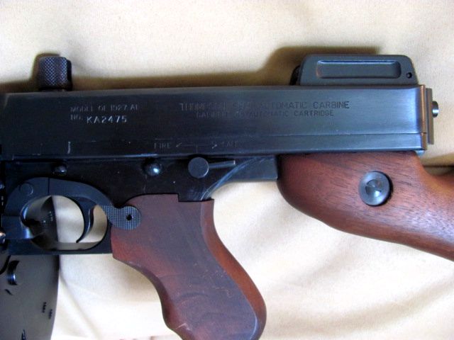

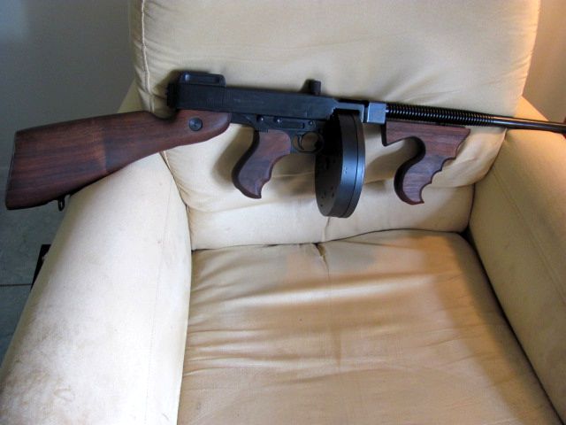

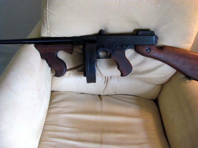

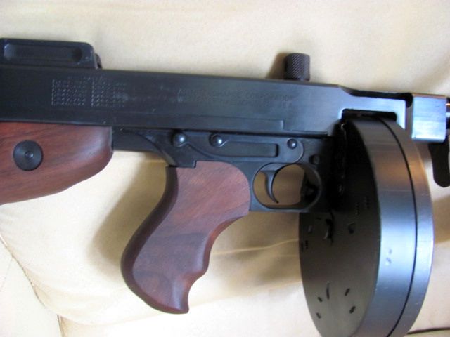

Default Unfired Thompson
Ive owned my semi for years and never fired. I could barely pick it up unloaded to take this picture. It is way cool The must use plastic one in the movies! Eric
