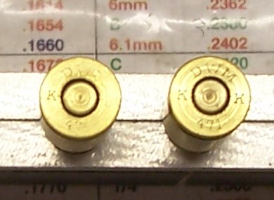

I searched my junk cartridges box looking for that other 9mm brass-bulleted cartridge; couldn't find it...but I did find two 7.65mm Luger cartridges (pretty cruddy until cleaned up) with unusual (to me) looking bullets...(copper???)...
Headstamp says -
DWM
K K
471
And the primer looks to be brass...

Postino,
The photo is a bit small, but they are a nice pair of commercial DWM Karlsruhe made 7.65 Para rounds. Bullets can be nickle plated, usually with a steel jacket underneath. Brass primers are pretty much the standard on DWM rounds. 471 is the DWM model number.
Unread 01-14-2010, 11:05 AM   #59
Postino,
Thank You!
I couldn't get my digi-cam to focus that small; so I scanned them...I try to keep a sample of all calibers for reference; I found out the hard way that most reference books have misprints...Not what you want when you're reloading...
Lemme see if I can get the other camera to focus that small...Here we go...BTW: they're unfired...What looks like a firing pin dent is the machining (or polishing?) marks on the primer...
