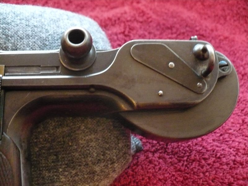

I did not see a stock lug on mine, nor any place that it appeared one might have been.
I have seen them on the back of the overhanging hump, (mainspring housing), on other guns, but mine lacks this little lug.
I do however have a lanyard ring, but it is on the left side.
I was wondering how they got a stock onto this beast.

Any ideas about the lack of stock lug?
Or am I just missing it, and it is a side mount or something?

the Lanyard ring on the patent drawing is quite pronounced on the rear around where the stock lug should be. The absence of a stock lug on your Loewe is interesting too. Maybe this is part of Mr. Lugers fiddling around. A lanyard ring mounted on the left side is not shown on the patent diagram. Time for me to keep my mouth shut for a while and to listen to what others might have to say.

I don't see where any of you Borchardt owners have answered Star's question about the location where she should find the stock lug on her gun. I am completely ignorant where these guns are concerned... but I sure am also curious about a Borchardt without a stock lug.
Unread 02-13-2008, 09:40 AM   #54
Thanks: 1,119
I am a little embarrassed to admit that I didn't notice the absence of a stock lug right off the bat. It should be located on the rear of the mainspring housing, so either it has been removed or never had one (unlikely). It is fairly small and sticks out where it could be easily damaged, so I think an examination in good lighting from several angles may reveal that it has been removed and the housing nicely refinished.

Hmmm, well no evidence of a lug ever having been there, not any refinish to cover.
Odd.

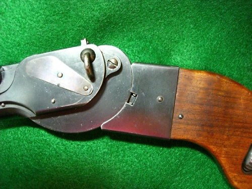

Under magnification the lug appears integral to the housing, all machined from one piece of solid stock. I see no reason why a replacement couldn't be easily fabricated. The trick is attaching it to the housing. Silver braze would probably be strong enough to allow attachment of the stock. I am not sure it would hold up to firing (not much chance of that anyway). It could be strengthened by pins integral to the lug placed in corresponding holes drilled in the housing and, in addition to the silver solder, peening the pins over on the inside.

Other than possibly one or two early pre-production pieces that may have been produced with the lanyard attachment where the stock lug eventually was placed, I am unaware of any Borchardts that were made without a stock lug. But, I haven't seen or have had reported to me all of the Borchardts in existence, so I can't say positively there were none.

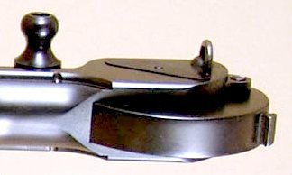

Fig 1 of the October 1896 patent (D.R.P. 91,998) shows a unusual spring housing as well. In the stock lug's position, it has a lanyard ring, but not like the lanyard ring eye as appeared in the original C93 patent (D.R.P. 75,837).
According to patents and surviving samples, there are at least three types of spring housing:
(1) Lanyard ring eye in the upper position;
(2) Lanyard ring eye in the lower position. Also, a different shape;
(3a) -- nothing -- (questionable, but not impossible);
(3b) Stock lug in the lower position (most common).
Hopefully, I did not miss a configuration, did I?
For (1) & (2) listed above (visible on patents), there are virtually two lanyard rings per gun. What could be in Borchardt's mind to put two rings on the gun.... any suggestion? Thanks.
