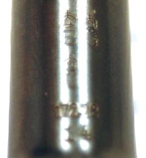

When I saw that pristine M1900 Swiss commercial, initially, I was stunned with the thought of "how can a gun 105 years old" look that good" ???
The photo that swayed me to the "original" side of my internal debate was this barrel photo which seems to indicate barrel "halos" which usually do not survive a re-do well...
Although the owner was selling off most of his collection, this SN 14 was remaining in his safe.

Pete -- I noticed the halo earlier. That's on the barrel though and the barrel on Parabellum is removable (I don't know how hard it is). The witness mark looks good. I'm lost here.
This gun must cost 5 digit..... Is the bore minty?

I think Pete posted that photo for you to sink your teeth into, and I believe you did so correctly and made very good observations. Lots of Swiss Lugers have been restored/refurbished, usually by the Swiss who took pride in their firearms and had no qualms about keeping them in top mechanical and cosmetic condition. This Luger is no exception...it has been restored but that does not diminish its status as a fine example of a very early Luger. I have no problem with that just as I would never accept it as being "factory original", the apparent barrel halos notwithstanding.

The owner of SN 14 and I never discussed price/value and I did not learn of the bore's condition. But I think Simpson LTD has had them for over $ 14K in the past year or so.

BTW...the BU proofs along the left side of SN 14's receiver flat are very strong and deep stampings...you usually loose those even to some Swiss refurbishments, don't you...?
I still want to believe SN 14 is all original (i.e. DWM original...).

Unless there is damage, it is not necessary to remove metal for restoration, just remove the old blue and a *very* light sanding to restore "grain" and remove residual oxidation. Also, most of the points that Alvin made about #14 are directed at the frame, the barrel receiver may not have been refurbished. Notice the domed appearance of the internal portions of the crowns, the B and the U. If they had received any extensive refinishing there would be some flat spots, so I will accept that the barrel/receiver may very well be DWM original. I don't think the three "dots" are of any consequence, handling marks that small could happen at any time during final finishing and not necessitate any remedial action.

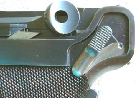

Hi, why beneath the thumb safety is white and not blued. Was there a time that Lugers were blued that way? Thank you all.

I heard that area was polished intentionally as a visual help to the user -- if he sees that white area being exposed, the safety is on. Obviously, it's a better design than the later German word "G...." (I forgot how to spell it)... it's hard to guess the meaning of the word for non-German-speaking users.... safe? danger? take a chance.
One thing I am trying to figure out -- when was this feature canncelled? Was it dropped when the "New Model" appeared? Thanks.
Unread 02-03-2008, 04:25 PM   #55
Generally...the "polished" safety area (of the thumb safety lever) was used on the M1900 Lugers...M1906 Lugers appear with both polished and "marked" indicators such as "Gesichert" and others in other languages...and the "marked" Geischert safety indicator predominates with the M1908 Luger...
But many exceptions abound...take for example...the Swiss Lugers...they stayed with the "polished" safety indicator all through their M1900's, their M1906's and their '24 Bern Lugers...only changing to a "S" indicator for their M1929 Bern Lugers.
It is not a "black & white" issue on when the change occured...

The first "safety" marked Luger was the 1900 Bulgarian, although, like the later Bulgarian and Russian Lugers, it was marked "fire" instead of "safe" and the gun was ready to rock and roll when you could see the marking.

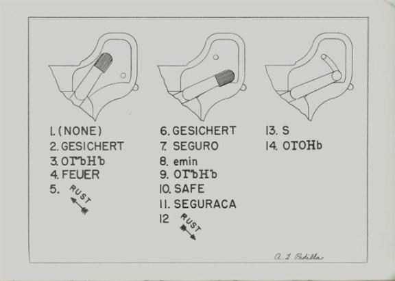

Here is a safety marking study Harry Jones had in his book "Luger Variations" on page 240 :
