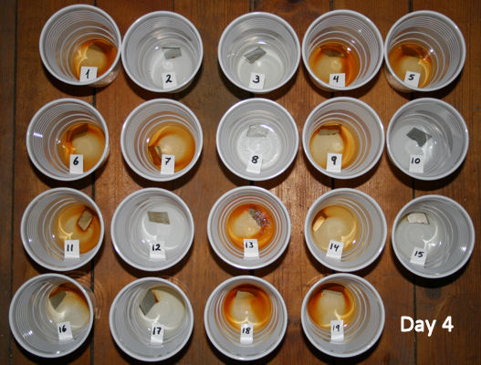

Day 4 (+6 hours) ..some are still holding up!

It looks like picking the winners and losers is not going to be tough!

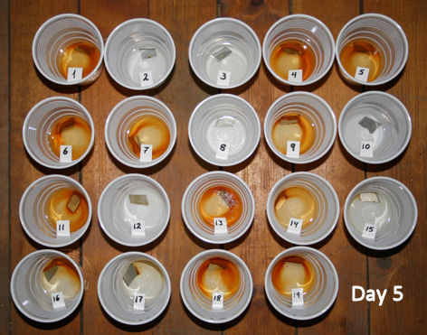

Here is todays picture;
I now also have Kroil, two types of X-tend (a new norwegian brand) and three types of various military oil. These will also be included on the next test later on. Have a nice day!

I'm feeling self-righteous already.
I've used WD-40 since the early 60's. Lately, popular wisdom has been that you should never use WD-40 on your guns.
I'm glad I ignored them.
