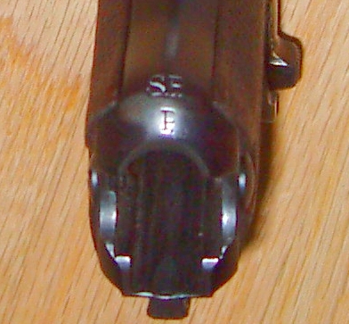

Typo! I goofed. The letter in question is 'P'. Sorry, Don. I was trying to get it out before I left work and my brain malfunctioned. I'm looking at it now and it is definitely not an 'S'.

Now we're getting somewhere! This almost certainly is from Plauen, a city of 111,400 in the western part of Saxony. Yours is the only example I know of from this city. I will be especially interested in seeing a good photo of it and would like your permission to use the photo in a future research article on Saxon police unit marks. I will credit you on the photo unless you prefer that I not. You may send me your full name (as you would like it listed) via email to donmaus1@aol.com. Congratulations on having purchased a very unique Luger.

All right Don,
This is the furthest I've taken it down so far. I have a lot of pics like this at hi-res from different angles that are too huge to upload unless I crop them to pieces like this 'S.P. P.' shot. I can e-mail to you as many as you say or tell me where to concentrate attention. I appreciate the interest in this weapon you and the others have shown.
Sincerely,
Russell

You've been busy! I would like the best photos you have of the S.P.P. mark and the front of the grip strap. If you can avoid the glare from direct light, it will greatly improve the pictures. I have found that taking photos outside on an overcast but bright day works well. It also helps to use a background that is not too light to keep the automatic exposure from underexposing the dark gun.
You can email photos to me at donmaus1@aol.com.
From what I can tell from the photos you have posted, it appears that there is a period between the S and P and that the grip strap has been ground. Do you agree?

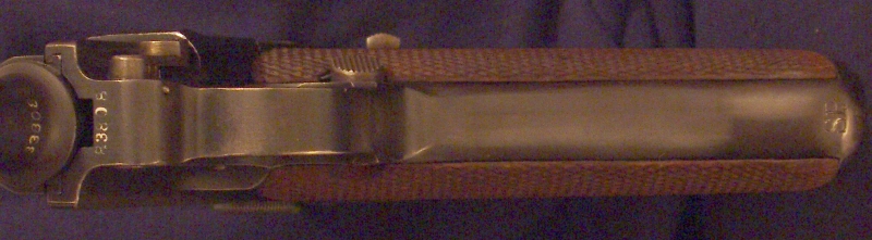

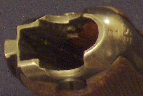

Busy indeed!
I looked up Plauen, Saxony on the map and realized it was part of East Germany. Is it reasonable to think that a Russian may have taken possession of this Luger after the war? Granted 25 years had passed by then and the weapon in the hands of a Nazi soldier could have found its way all the way Normandy or Africa or anywhere in between where allied troops could have captured it. Can one trace such movement of individual arms?
Anyway, here are some fresh pics of the underside. The front strap is smoother and shinier than the rear strap or the rest of the blue. The gray area around the lower 'P.' appears to be holster wear. There is no period between the 'S' and the 'P.'

On April 16, 1945, U.S. forces of the 87th ID occupied Plauen before driving on to the Czech border. I don't know how long they were there but it is plausible that this pistol was "liberated" by a GI from a Plauen Schupoman before the Russians took over and that it never was in German military or Russian hands. I'm no expert on Russian-captured weapons but I believe that most of them have an "X" marking on them. Perhaps someone more knowledgeable on this will comment.
On the other hand, the removal of the sear safety may indicate otherwise. Since only the police used these devices, it may have been removed as a result of being pressed into German military service. I believe the Russians also removed sear safeties from the P08s they captured. As tacfoley says, "Enjoy wondering."
From looking at these and the other photos you sent me, it appears that the front grip strap either was not ground or else someone did a very good job of it. One more test is to remove one of the grips and look at the inside surface of the front grip strap. If it is a bit "lumpy," it would suggest that there had been a mark stamped on the front.
I am convinced that this gun is a genuine 5-digit commercial DWM -- what Jan Still calls a "20 DWM" in Weimar Lugers, pp. 12-18. It was probably manufactured in 1920 and was sold to the Saxon police, who added military-style serial numbers to the small parts. It was also property-stamped "1920." This makes me feel that the other "1920 dated" pistols listed in my posting above were very likely similar and don't belong in the same category with the others listed. I do feel the "1921 dated" Lugers with serial numbers 8XXXX and 8XXXXa are anomalies and the puzzle is unsolved for them.

The inside of the grip strap shows only magazine ware; it does not look or feel bumpy. What would grinding of the strap reveal? I'm guessing it would have been done to remove old markings.

Thanks for checking the inside of the grip strap. Based on all this info, I don't believe there was an earlier Saxon State Police mark on this pistol.
