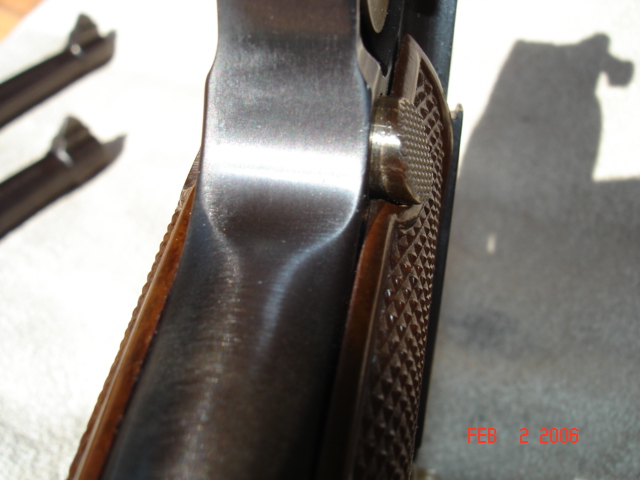

If I have not totally alienated Jerry and Jack, I would like to prevail upon their good graces and ask for an additional photo. I would like to see the frame where the trigger guard meets the front grip strap.
I am not ready to write this one off as a "build up" just yet. The sear safety plug and the WaA66 are troubling, but the toggle logo leads me down a different path. I do wish that John D. would wade in on this.

Unread 02-02-2006, 06:41 PM   #47
hqbmw
Join Date: Jun 2005
Location: Mesa AZ
Posts: 228
Ron,
At least your question was completely valid. Here is a shot of the area you asked: where the trigger guard meets the th front grip strap.
Hope it doesn't give you "Bad vibes" because they are just not good for one's health.

My vibes are good most of the time regardless of the situation! And, by the way, although the shine makes it a bit difficult to say 100% for sure, the triggerguard does appear to have a Krieghoff flare. Thanks for the extra photo.
