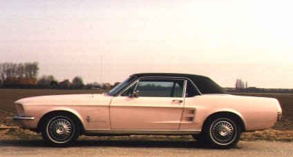

Never been there, but my former 1967 Ford Mustang came from a Scottsdale, AZ dentist.

Yes, the Mustang's sheet metal was great and rust free. But the rubbers were toast.
Interior was ok, and it already had a replacement Mexican 302
Stick shift, 3-speed. Interesting combination to drive, along with drum brakes and no brake booster.
I no longer own it, but it is still registered with a enthusiast over here. There's quite a large USA classic car scene here.
