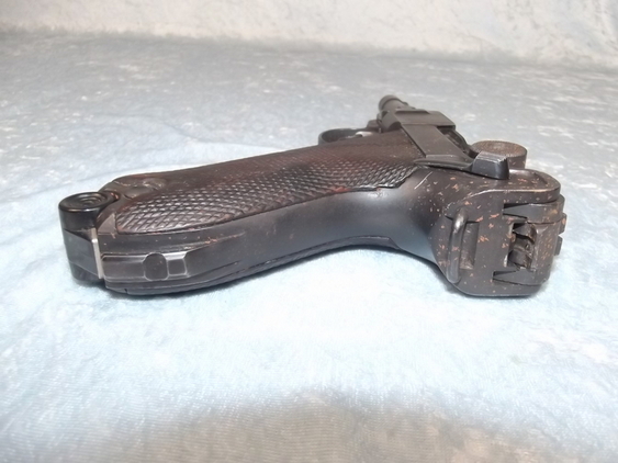

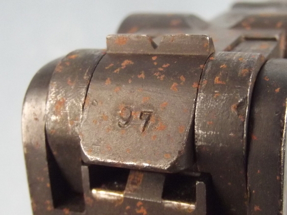

You've inspired me to dig out my Finnish Contract m/23 Luger and have a go cleaning it up with some 00 steel wool.
Keep me occupied tomorrow morning anyway.

Use 0000 steel wool or, better yet, bronze wool. The finer the wool, the better. Lubricate well with oil and don't press too hard.

Thanks, it is not as bad as it appears in the photos. I have some 000 steel wool ready and this evening I have stripped it down and I am soaking the parts in oil.

I really like the bronze wool idea Doubs ... Will have to track some 0000 bronze down.
I use 0000 steel wool with a touch of Ballistol or a fine gun oil .
I do not use 'scrubbing' motions but rather 'light' straight passes in one direction on the area that needs attention and like Doubs I don't press hard. Take it slow, stop and look then carry on as needed in small steps.
