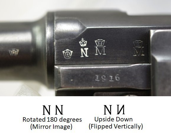

The serifs on the N show it to be upside down; the crown is too precise and too finely detailed; the crown is too far away from the N; the proportions of the stamp seem subtly wrong and it seems to be too large. This last is an intuitive impression and can only be confirmed by direct comparative measurement.

I didn't say backward, I said upside-down. The issue is not the thickness of the legs, but the position and direction of the letter serifs. Thickness difference in stamping can be attributed to uneven positioning of the stempel during the stamping stroke.
SPECULATION: the marking under discussion is the result of two different stamps, the N being held in the wrong orientation and the crown being a separate, more finely detailed stempel.
Fakers are very often...well, I want to say stupid, but let's just go with ignorant, or just unobservant. This is the characteristic which allows us to catch them out.

Spending a little more time with Norme's posted GB photos, some examples I have, and your explanation I can see what you are talking about. I wish it was not whited in, but I can see how you come to your conclusion. I don't know about being so emphatic about it, though.

Not to put too fine a point on it, but technically the "N" of the Crown/N impression is not upside down...it is a mirror image. That is what happens when you hold the stamp upside down to apply it.

I goofed. Rich (Sheepherder) pointed out to me that my illustrations and text were somewhat in error. I was correct that the "N" stamp on the gun was the result of rotating the stamp 180 degrees so that the resultant stamp is upside down, therefore the left example is a correct representation of an inverted stamp, but not a mirror image (scratch out "mirror image" in the text and example image ).
Here is what a mirror image would look like (and it isn't what is on the gun).

No, that is apples and oranges. The first illustration in my original post "Rotated 180 degrees" is the correct illustration, it just should not have had the additional "(Mirror Image)" notation because it isn't a mirror image. The correct orientation of the "N"should be with the two serifs on the left vertical stroke and a single serif on the right vertical stroke. Since the stamping tool was rotated 180 degrees (stamp held upside down) when the impression was made on the subject Luger receiver, the N on the receiver as shown has the two serifs on the right vertical stroke, therefore incorrect.
OK, I deleted my incorrect pic.
