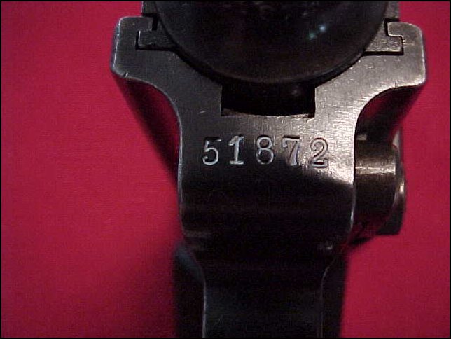

Hello alls
I just indicate that on the bottom of the frame there is a "french" number stamped :Manufacture Fran�§aise code
N�°45425 in 30 :2209
N�°47601 in 9mm:115

Unread 06-13-2005, 08:49 PM   #26
Default French # 51872

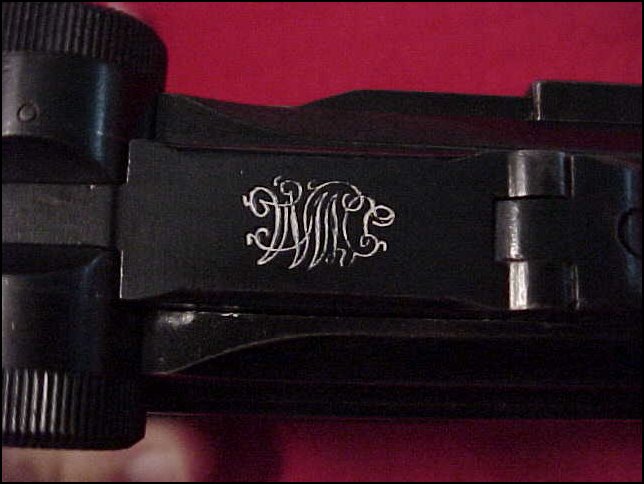

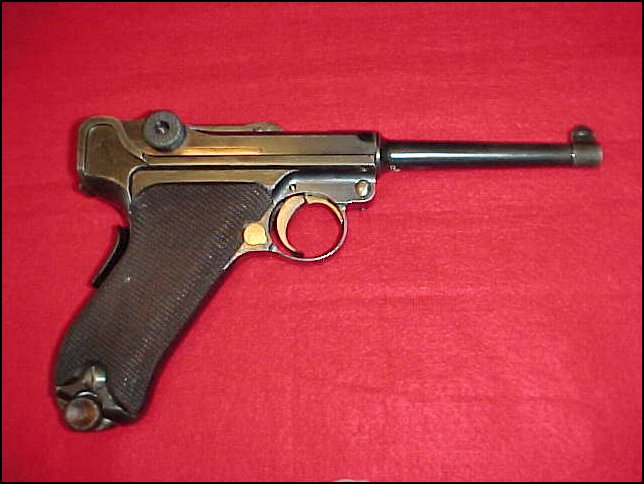

French luger # 51872 for sale again...(...or still...?). I do not know who the A-A seller is...
This one was previously listed for sale with Shattuck/Etwoski at WOL/PIA...see postings, above.
http://www.auctionarms.com/search/di...temnum=6737354
Photos from A-A :

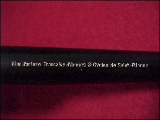

Unread 10-31-2005, 04:24 PM   #33
bonjour messer cosica, je achete le 1906 pictured above, are you aware the presence of 'charge' both on the 1906 and 1903, et jai livere messurs herotins book avec un picture or drawing of the 'sunburst' i dont parle' francais, but as courtesie and a stepchild par vitre, its a pleasure hearingg from you,great minds seek truth, un queste , jamais complet s.v.p. email mess-up ERIC BRUNING,772-336-5312 OF SNOOKEM13@AOL.COM, FOR THE 1903 WITH APPROVAL
cirelaw is offline
Unread 10-31-2005, 08:06 PM   #34
Eric,
I am not sure if I am interpreting your question correctly. To the best of my knowledge, only the 1903 French transitional Luger and one solitary example of a 1906 Commercial Luger with a fleur-de-lis chamber marking have the CHARGÃ?? marked extractors. I believe that the 1906 model Lugers with the 'Manufacture Francais d'Armes & Cycles de Saint-Etienne' barrel marking were standard Commercial models with a GELADEN marked extractor. The barrel markings were applied in France by the importer/distributer and not at the factory.
