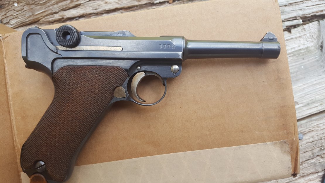

How do you handle lighting? I find this is often the most important factor!
I took it outside on a sunny day, in the shade, and just started taking photos with my phone until I got clear, defined, and well-lit shots I angled the firearm towards where the sun was and shot them off to the side, not to get in the way of the natural lighting.

I have found that the following works well:
Photos taken outside, on an overcast day. Clear skies are to be avoided... as is direct sunlight. Lighting is then bright but diffuse, with shadows kept at a bare minimum.
This lighting should work very well with most smartphones,
I have to admit, even though I have a iPhone, the Samsung photo quality is, I think, somewhat better
No flash of course
Pretty close to yours Sky Zero... your photos are good

Good idea! I'll try the overcast day when my next one comes in, which should be in about a week and thank you for the compliments! Glad to know I'm doing a decent job of showcasing these pieces
