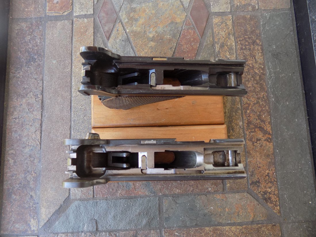

Unread 08-19-2017, 10:48 AM   #22
How do they avoid some areas plain and other blued? It seems like a time consuming process~
Unread 08-19-2017, 01:37 PM   #23
It is a time consuming process. The rust blue solution is hand swabbed onto the gun avoiding the bright polished inside, whereas the hot salt blue process involves dipping the entire piece into the bluing solution thus everything gets blued. Moreover, the rust blue process requires repeated application of the bluing solution, with boiling and carding of the surface between each application of the solution, until the desired darkness of color is obtained. The hot salt blue process requires only a one time dip so it is many times faster (but not nearly as attractive to my eye).

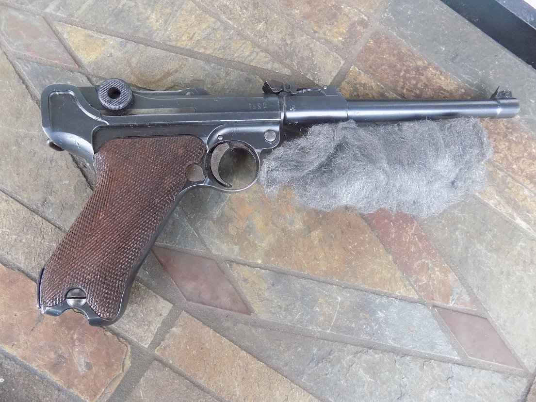

Unread 08-20-2017, 06:32 PM   #26
What is the safest way to got rid of old little bumples. Or leave it alone~

Unread 08-20-2017, 11:18 PM   #28
Leave it alone!!!!
Get that steel wool away from that pretty luger- you can't improve it.
Oil it and , leave it alone.
Did I say leave it alone?
