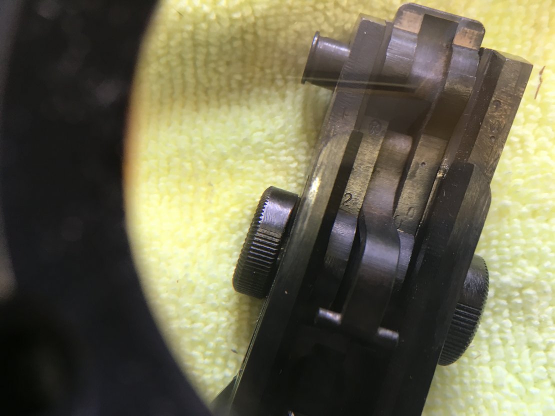

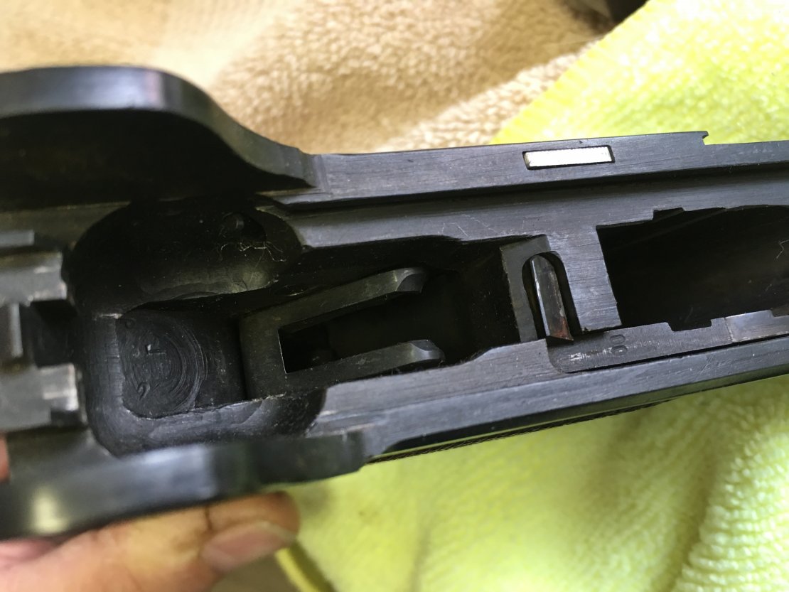

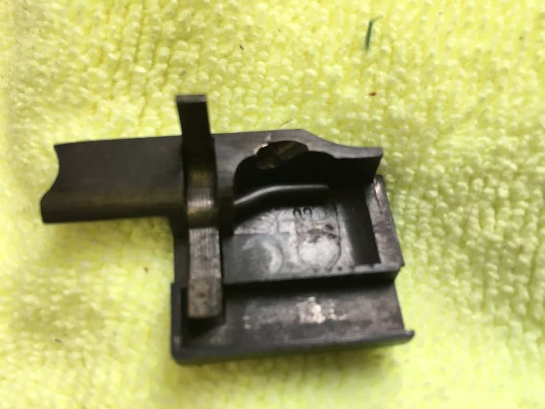

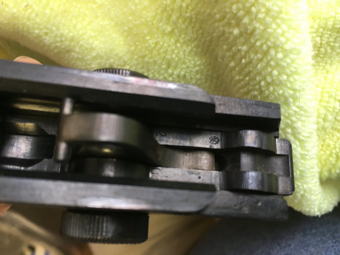

All righty then,
taken apart, wiped off, photos, lubed and reassembled. The toggle hold open still doesn't work with or without the mag. Nothing apparently broken or loose. ???
More pics of the innards.
I guess the "straw" color of some parts doesn't apply to this one? Should I reiterate all the info from you guys when I list it for sale, or would a serious buyer be savy enough on its info...other than the photos?
Is listing on other sites advisable (in terms of viewers)? Should I disclose the toggle issue, or is that normal for this piece?
Probably some dumb questions, but thanks for understanding!
......and..ALL your help and input is really appreciated. I'll be glad when this is over!

Put a little oil on the hold open and work it up and down- it is probably just stuck by old grease/oil/rust?

If you put the magazine into the gun with the upper half OFF, you should see the hold-open bar raise up a bit just as the mag. locks into place on top. The button on the magazine is what pushes it up. You'll be able to see if the mag. raises the lever. If not try a different magazine as your hold-open lever appears intact.
It's a nice gun, collectible and correct, and you're doing well.

You can actually push it up and down with your finger just to see if it moves. The flat piece just behind the magazine should raise/lower just a bit to catch the toggle on its trip forward.

It does.....

I'd say that's a pretty strong indication of a magazine issue, not the actual hold-open. Minutia.
What else did you need to know before moving forward?
