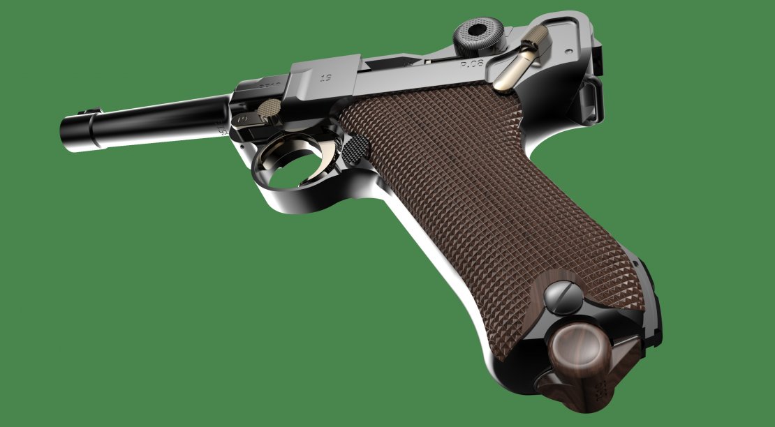

Hi Guys,
I promised you a look at the finished "gun" - attached is a Keyshot rendering:
Dave
9x19 is offline   Reply With Quote

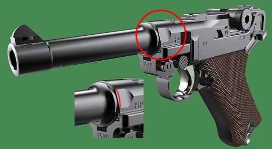

Looking good, but suggest a correction...the chamfer on the forward receiver needs to have the same radius as the rest of the receiver in that area, not a straight line.

I have corrected the gun thanks to your kind comments. I expect that I will create a cross- sectional view, although the model of the Colt was see-through not sectional, it means a bit of work to create multiple sections, but as/when I do I will let you know.
Dave

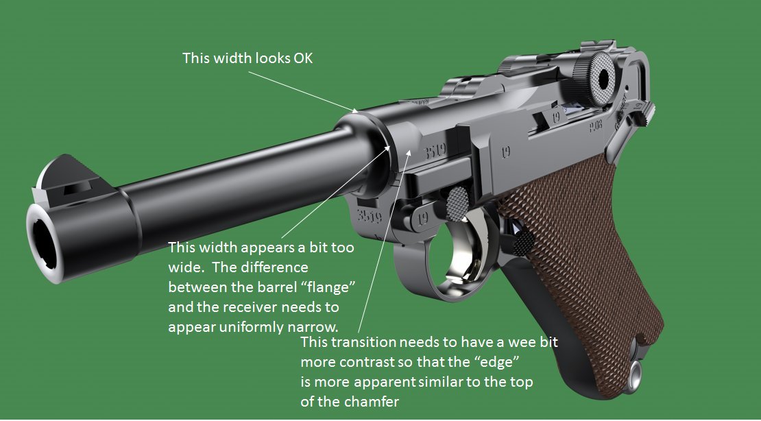

Almost there...a couple more suggestions if I may

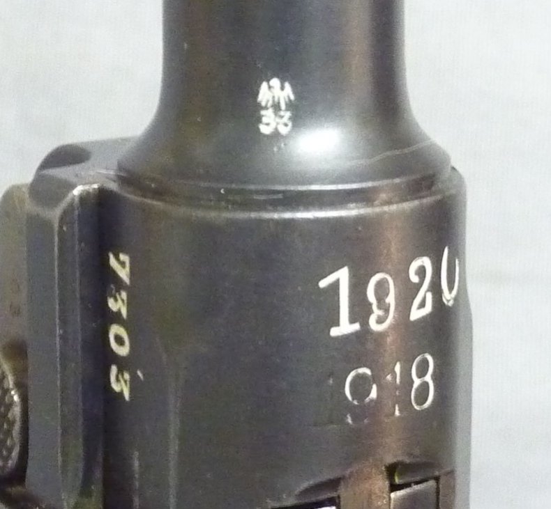

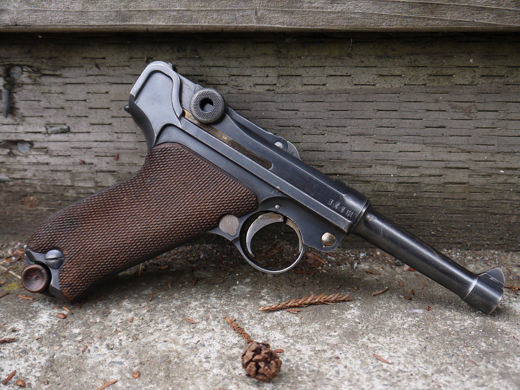

Perhaps these pictures will help; less the defect of course.

That was Don, not Ron, that posted the photo of the Luger marked 1920.
"In fact I have seen examples where the "grooves" do not match from side to side"...those "examples" didn't leave the factory that way, Lugers are symmetrical.
"Interestingly enough I have drawings of a horizontal groove cut in the top front edge of the slide (forward of where you see 1920 on your gun) that does not appear to have any use"...that groove was to accommodate the rear sight of a LP08 ("Artillery") Luger. Obviously the drawings you saw were of a LP08 that was rebarreled and no longer had that rear sight or was of an Erfurt Arsenal made Luger produced after 1914, all of which were made with that groove simply because the arsenal didn't bother to change the tooling.
The Luger in the image you posted is a very nice example, but as you can see the transition of the lower part of the chamfer is a bit more apparent than on your rendering, as I attempted to point out.

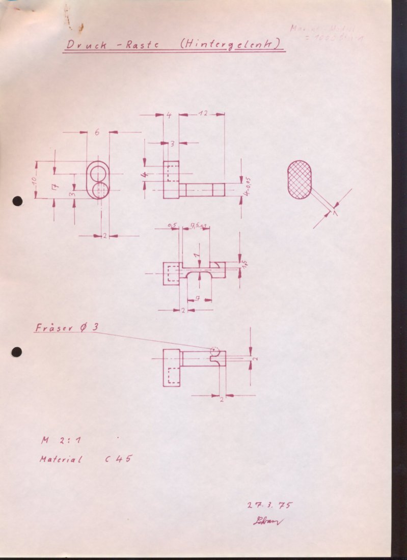

About the rear sight: These might help
These drawings were (re)done for the production of the commemorative Mauser Parabellum / Navy version.

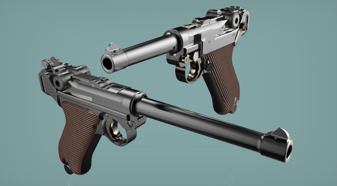

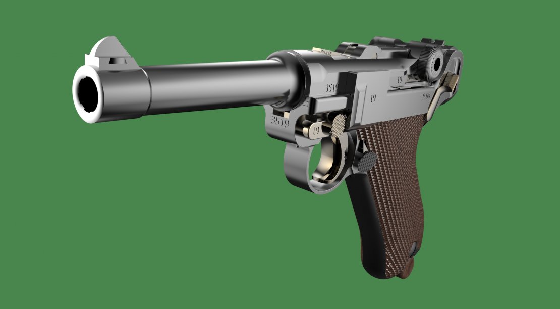

To bring you up to date, I have almost completely re-made all of the models that were used in my Luger assembly.
I had been forced into downloading someone else's models from the internet to complete my assembly, I got these off one of the web sites that I have used before.
Unfortunately 99% of the stuff I used was incorrect. I only found this out when I bought a full set of "cleaned up" drawings from John Sobato (of this forum). To cut a long story short, it has taken me until now from my last post on this forum to remodel virtually everything.
I am going to make 3 different variants of this gun and render them in one image. I will let you see the finished article when it is done.
Now that I have at last got a "sound" standard model with a 4" barrel, I intend making a 6" version (not the Naval one as I cannot find any details of the adjustable rear sight anywhere) and an artillery version made from the barrel drawings that Rich B. very kindly sent me.
I have the barrel already modelled, but I am short of some parts e.g. drawings of the dovetailed sight base, the adjusting toggle, details of the elevation spring and assembly, etc.
Does anyone have these details on drawings in their collection. I would be most grateful for a copy, if you wouldn't mind.

Finally, the reason that I made my first post on this forum - I have finished the Naval version of the P08.
I have just the Artillery Luger rear sight and stock to complete and I will be a very happy chappy
I can then address the chequering on the grip
Regards all,
Dave
