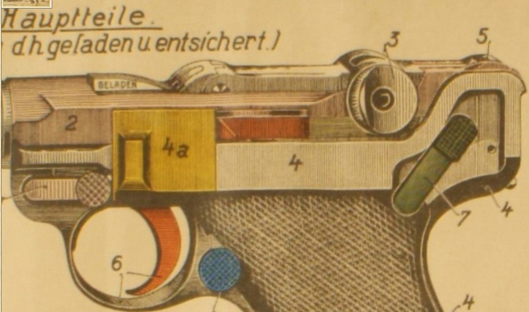

Dear all,
If you look close to the BoB picture mentioned above you can see the loaded chamber indicator is visible and it reads on the side GELADEN.
Sorry that this brother could not read German so much..
Attached another nice sketch.
bigbuck

The pic shows a M1900 style toggle and safety with a New Model frame and breech block with its "chamber loaded indicator" extractor.
