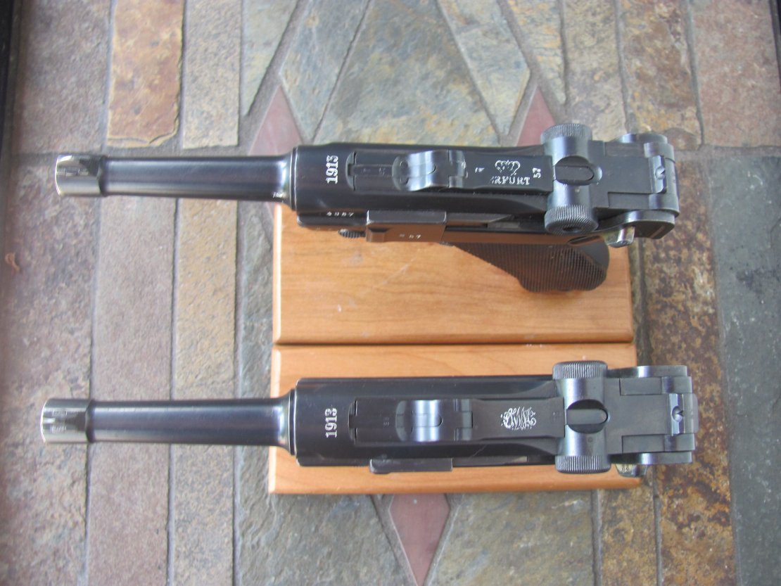

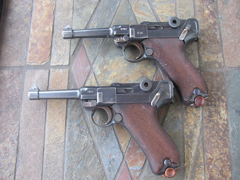

Both 1913, DWM #2533a, Erfurt #4857n Each has hold open~
