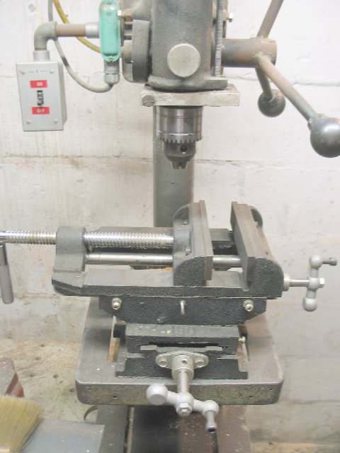

I also have an old Harbor Freight drill press vise that allows movement (about 4") in the X and Y axis. I'm not sure if I'd trust it to steel, but it works satisfactorily on wood, plastic [Delrin!], and to a degree, aluminum.
All could be used for simple tasks like dishing out magazine knobs, small milling of wood holes/slots, etc.

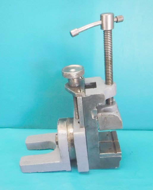

Gerry, back in the 70's/80's, before I bought my Bridgeport [now gone], I used a tool post milling attachment for my South Bend 14 1/2" x 60" lathe. There's a couple on eBay right now but pretty high price and kinda small...
But they can bridge the gap between a lathe and mill until you can find/buy a milling machine. I used mine for milling out reliefs for Bo-Mar BMCS low-mount rear sights, dovetails, S&W micrometer K frame sights, etc - all in 1911 slides. It was also good for making small parts. It adds 360º adjustability to the lathe, plus an extra 'Z' axis.
(Just to be clear, you mount the end mill in the lathe chuck and this attachment to the tool post!)
If I didn't have the mill in my Chinese 3in1 machine I'd buy this attachment.

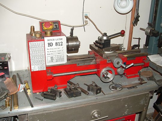

Unread 06-02-2017, 08:53 PM   #36
Aren't you the guy that thought books cost too much?
Unread 06-02-2017, 09:10 PM   #37
So that's where you store the lathe chuck key! I wondered where to keep it so I wouldn't lose it.
And the power strip is a handy way to keep all your power cords together.
I swear, there's not a day go by that I don't learn something new!

Not good practice in a lathe used by more than one person, maybe marginal if you're the only one in the shop!
