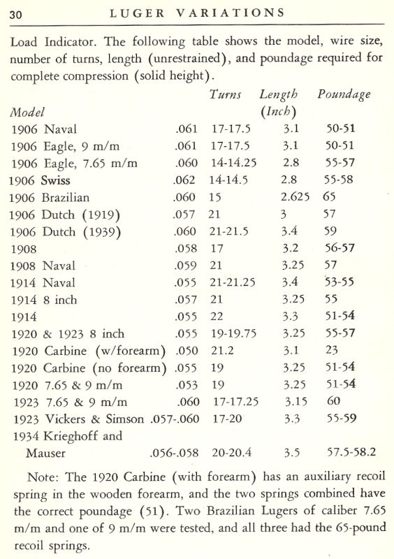

Lots of "myth" out there about main springs.
Perhaps this chart will help sort it out,
Unread 10-09-2015, 11:21 AM   #23
A valuable resource; I have it posted on my shop bulletin board.
I only wish that Jones had noted the later WW II springs as well.
In any event, this chart would make a good addition to the FAQ.
Unread 10-09-2015, 04:54 PM   #24
I would not think any significant changes would have been made after the 1934 information listed.
