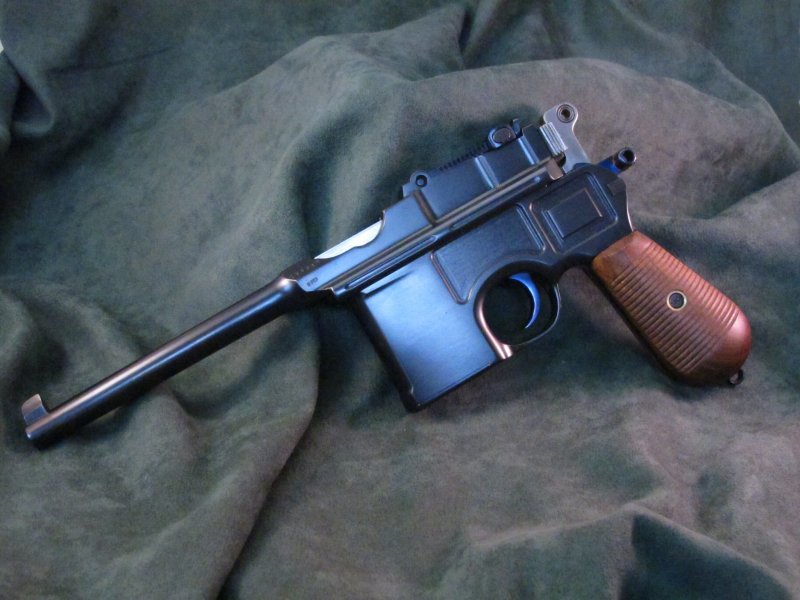

It wasn't too bad overall, but the grip frame was very rough. It was actually to the point where I thought I had to do a transplant to get it back in any workable condition. I didn't take any detail pictures before I started working on it, but the whole perimeter of the grips (including about 1/8" up on the sides) had to be TIG welded and filed back to the correct shape. That was the worst part, the rest just needed a few spot welds.
Anyway, it was an interesting excersise, haven't restored many "oldies" lately so I really enjoyed it. I found some .30 Mauser ammo at the show, so now I just need the springs and it will finally be time to shoot it.

Update: Got it done this evening, just in time for the gun show tomorrow. I'll be selling guns together with a friend of mine, so I hope it will make people stop and look at our stuff.
This gun was pretty rough to begin with, and needed quite a bit of welding, filing, shaping etc. The grip frame was severely rusted, so the only thing I could do was to weld up the edges and call it a day. There's still pitting under the grips, but it should hopefully be in a more stable form now after being boiled and soaked in oil. The grips are repros from somewhere overseas, they needed a lot of massaging to fit and they are still not perfect, but at least they look decent.
I would like to thank Paladinpainter for his role in the project, he was gracious enough to send me his special bluing formula, and he also did some of the nitre bluing. The barrel was relined by Redman's, and all that's left now is to install a new recoil spring and it will be ready to test fire. I should have ordered that spring before I even started working on it, but....
Anyway, here she is:
Looks great. But remember the most important spring in a C96 is the main spring. The recoil spring just closes the bolt.

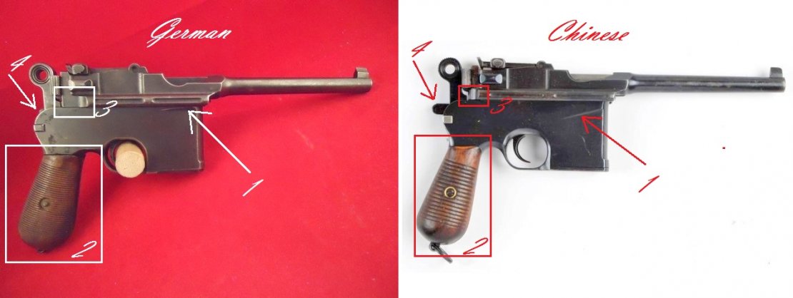

Really, with all those Chinese clones floating around, it would be helpful to have some kind of "buyer's guide" showing the typical differences. I have been very close to buying clones, but was saved from getting burned simply by finding anomalies like misspelled words or funky characters. For example, I have seen a few with fairly convincing stamps, but with a backwards "S" in "MAUSER". Those things are very easy to spot, but there may be more subtle differences that the novice won't notice until it's too late.
It doesn't have to be very complicated, just a side-by-side picture with arrows pointing out the typical differences. Anybody willing to do that?

The two most significant features on most Chinese C96 that I have met are these two:
1) On C96 magazine well design, the front of magazine is narrower. But the two rails on top of grip frame are parallel. To make the magazine well front narrower, Chinese copy is usually (but not always) different from that of German's.
2) Maybe it's not obvious on this particular picture, but Chinese C96 usually has either smaller grip (but bigger than German Bolo), or thinner grip panels. Asian's hand is smaller, holding a big grip is not comfortable.
Applying those two, you can tell most copies. Of course, there are other delta. But those are more variation specific. Use Large Ring as an example,
3) German Large Ring Hammer had short receiver rails. Chinese copy usually had long rails. Chinese actually copied German standard C96, but changed the hammer to a Large Ring Hammer.
4) The most copied safety lever functions like a German Standard C96. It's relatively rare to see Chinese copy has early safety, or M1930 style safety.
Of course, if apply s/n and feature correspondence, then, there are numerous minor detail difference. But by applying 1) and 2), you can tell at least 90% copies.
Finally, below German picture "borrowed" from gunbroker.com, it's a reblued gun with replaced grip panels. Probably a nice shooter. The Chinese picture "borrowed" from Morphy Auction, it's also a reblued gun (Morphy mis-identified it as Spanish). On small parts side, it not very rare to find German parts on Chinese copies.

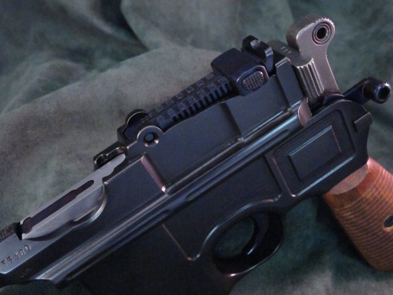

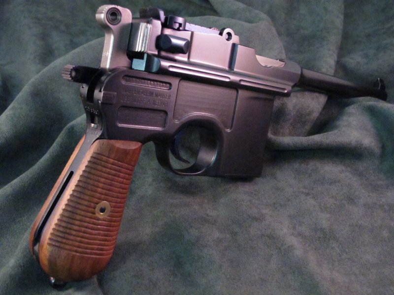

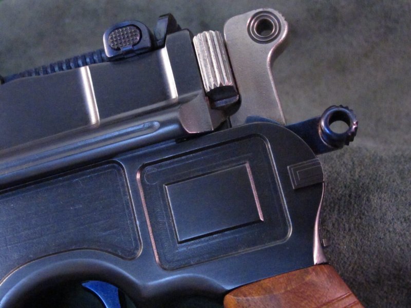

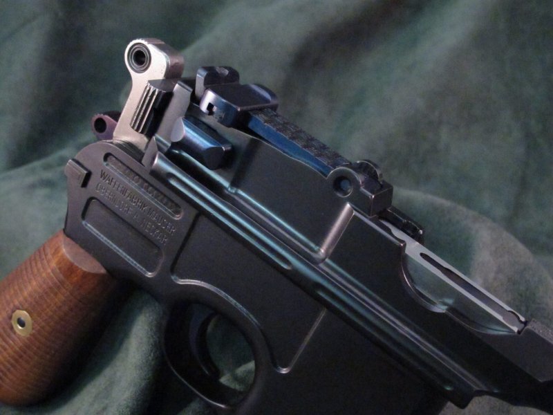

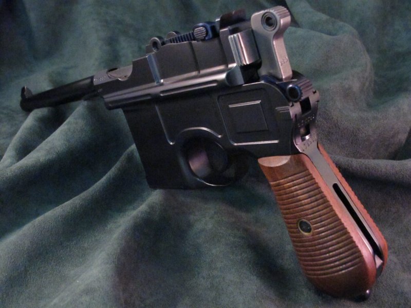

I had the camera and the photo tent set up today, so I decided to take some better pictures. I'm not entirely happy with the grips, but haven't been able to find any better. I might stain them a bit later to make them look old, but they will do as they are for now.
I have always wanted a nice C96 shooter, so I'm pretty happy with how it turned out overall. Also got a Bolo that needs some attention, so I guess that will be the next project. Might even convert that one to 9mm.
