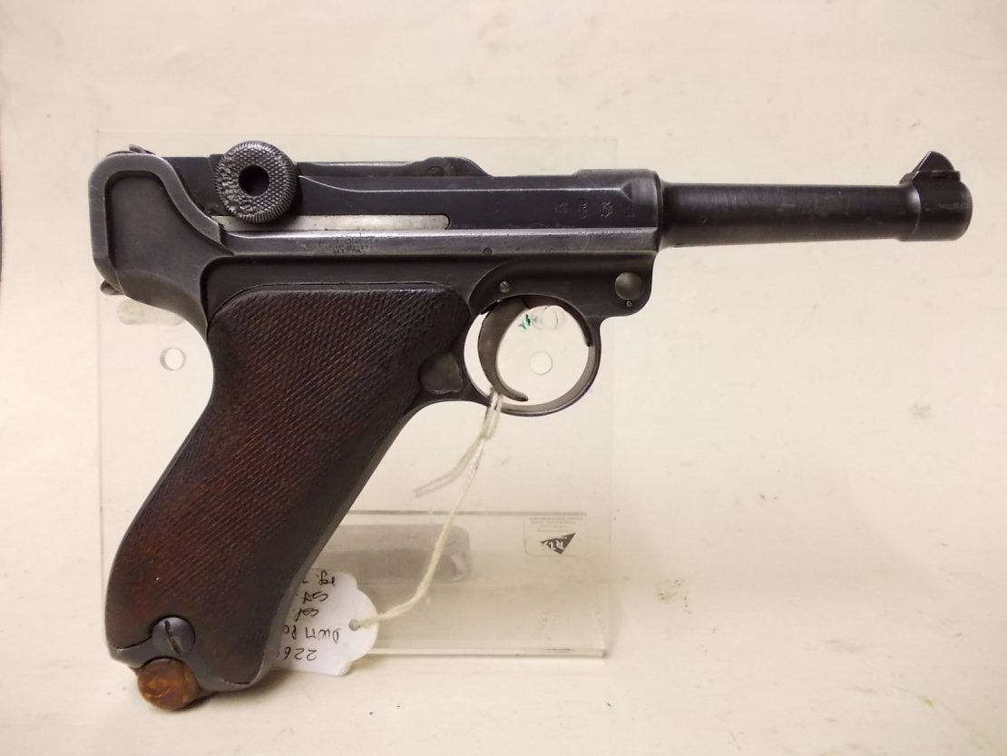

By the way Dan, that is a beautiful Luger. Are the photos of your gun or the one you found on line?

It is indeed a great looker, but as you point out, he may not have it in hand.

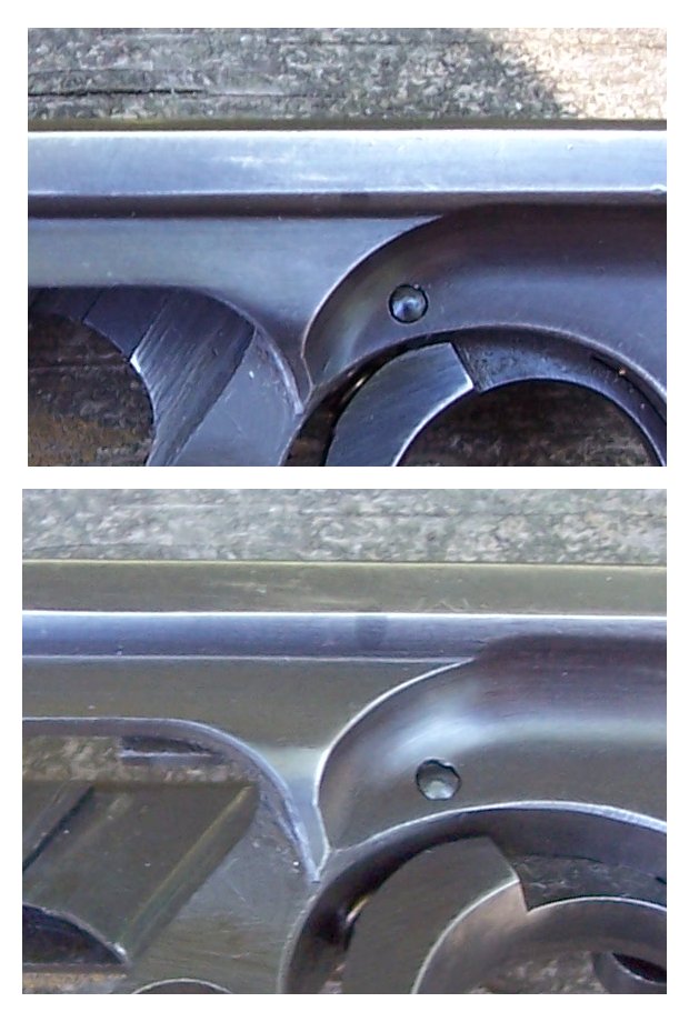

No. All Lugers with the hold-open will have the pin hole, but the factory assembled/finished Lugers are so well done that you really have to tilt the frame this way and that under a strong light to make it out...It helps if you take it apart and eyeball where the pin goes through and then look under a magnifying glass to see it.
There is no other way to drill the hole; the opposite frame rail is in the way of drilling a blind hole.
...and also do all the retrofitted guns have the Erfurt inspection mark near the pin hole?
As commented above, they all should have the Erfurt mark if they were retro-fitted...
Here's a good example of a pin hole in hiding...The top pic is taken straight-on; the bottom pic is with the frame tipped up...Both the same frame, but the hole only shows up if you know where it is...

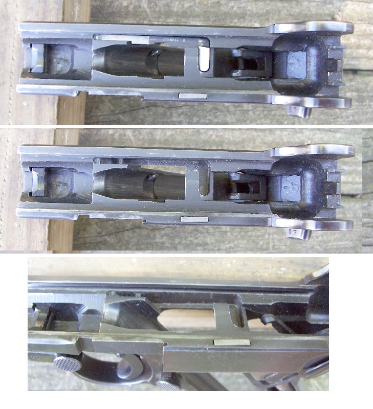

Here's a pic of the holdopen installed, removed, and removed/tilted...You can see the pin better from the inside...

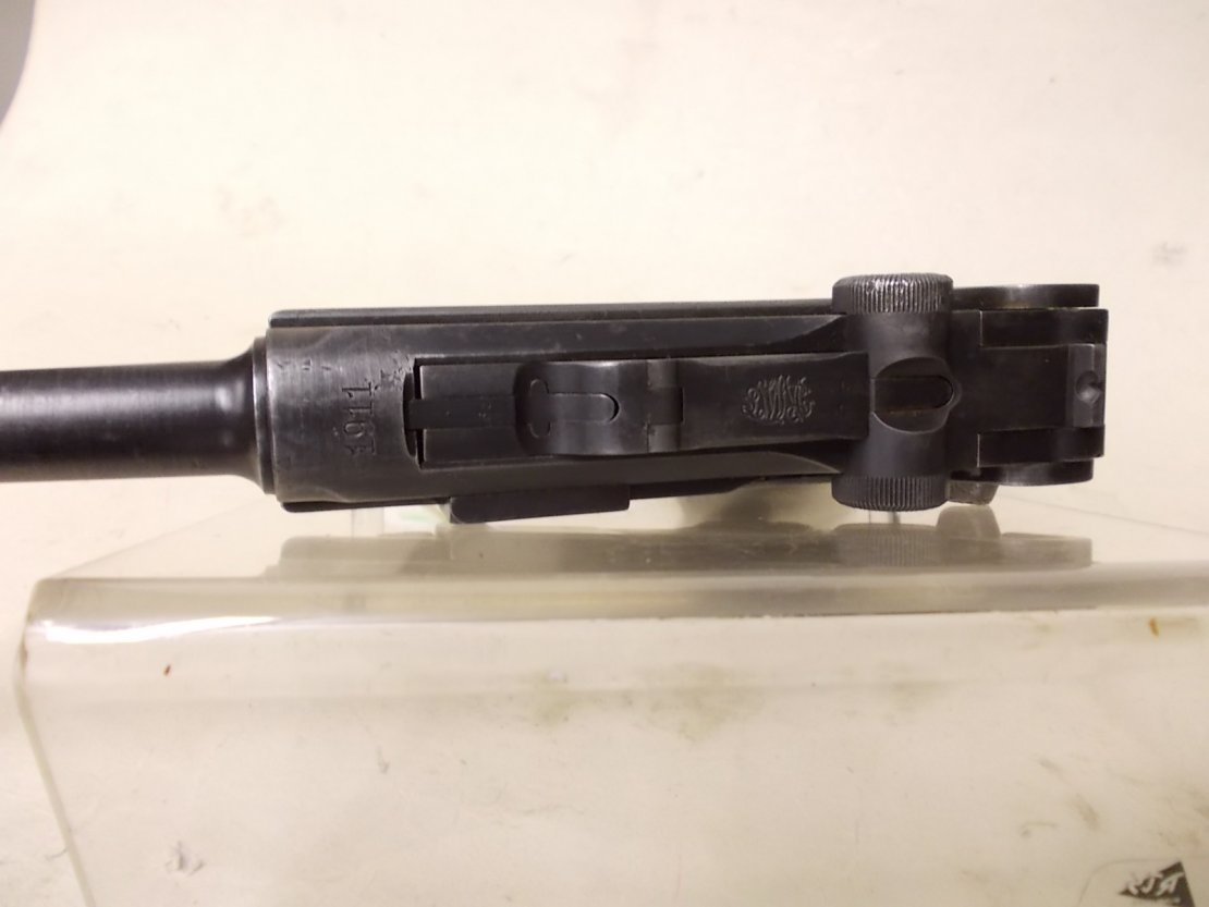

Unit mark is:
Bay. 3. Train-Batl., Sanitätskompanie Nr.1, Waffe 237.

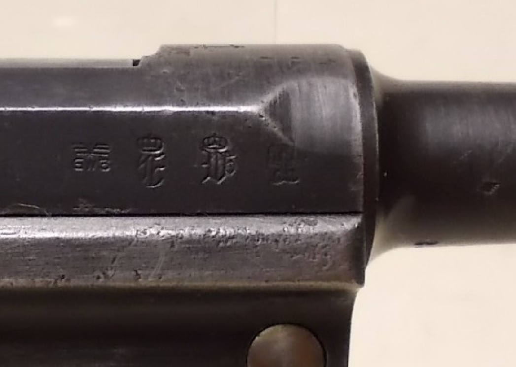

Just for S&G, here's what your Erfurt inspection/acceptance mark should look like...

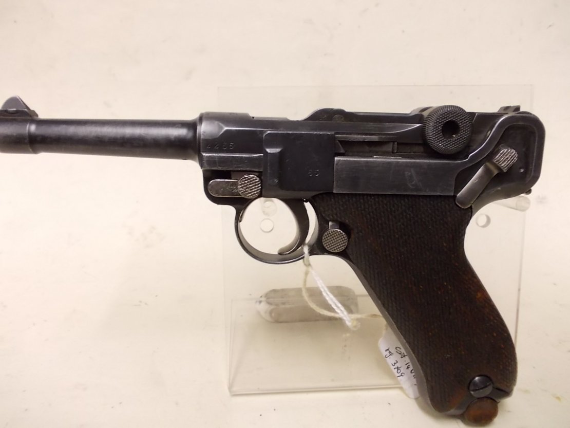

Not to harp on the same string BUT herebelow I enclose some pictures of a nice 1911 DWM reworked (I assume by Mauser though) with the pin quite visible.
All the best
Sergio
