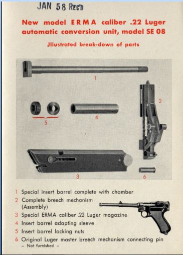

My only reference to proper ammo is attached:

Unread 07-15-2015, 11:24 PM   #32
Do you know the date or period of the statement shown?
Obviously it is not for the SE 08/2 as it says just SE 08.
Unread 07-16-2015, 02:20 AM   #33
Not sure when published.

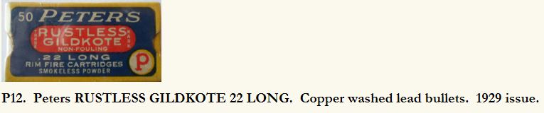

I believe that you will find that Peters ammo is quite a bit older than 15 years. I still have some of it from back in the 1950s. I don't know exactly when it was dropped. Wow, this is really making me feel old!!

I did a search last night. I don't think it's made any more. Peters developed the.22 lr round at the turn of the last century

Here is some from the 20's
Unread 07-16-2015, 10:14 PM   #39
My box is not that old.
I'll have to take a photo and post it!
Who would have thought anyone would care?
Unread 07-16-2015, 11:48 PM   #40
Old ammunition boxes are cool...'Specially if them gots boolits in they's...
