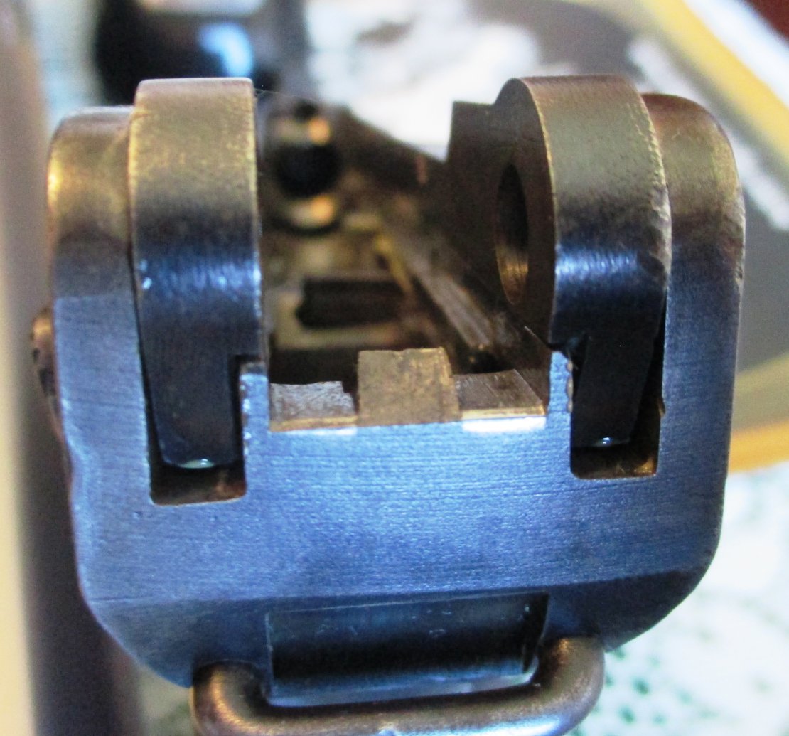

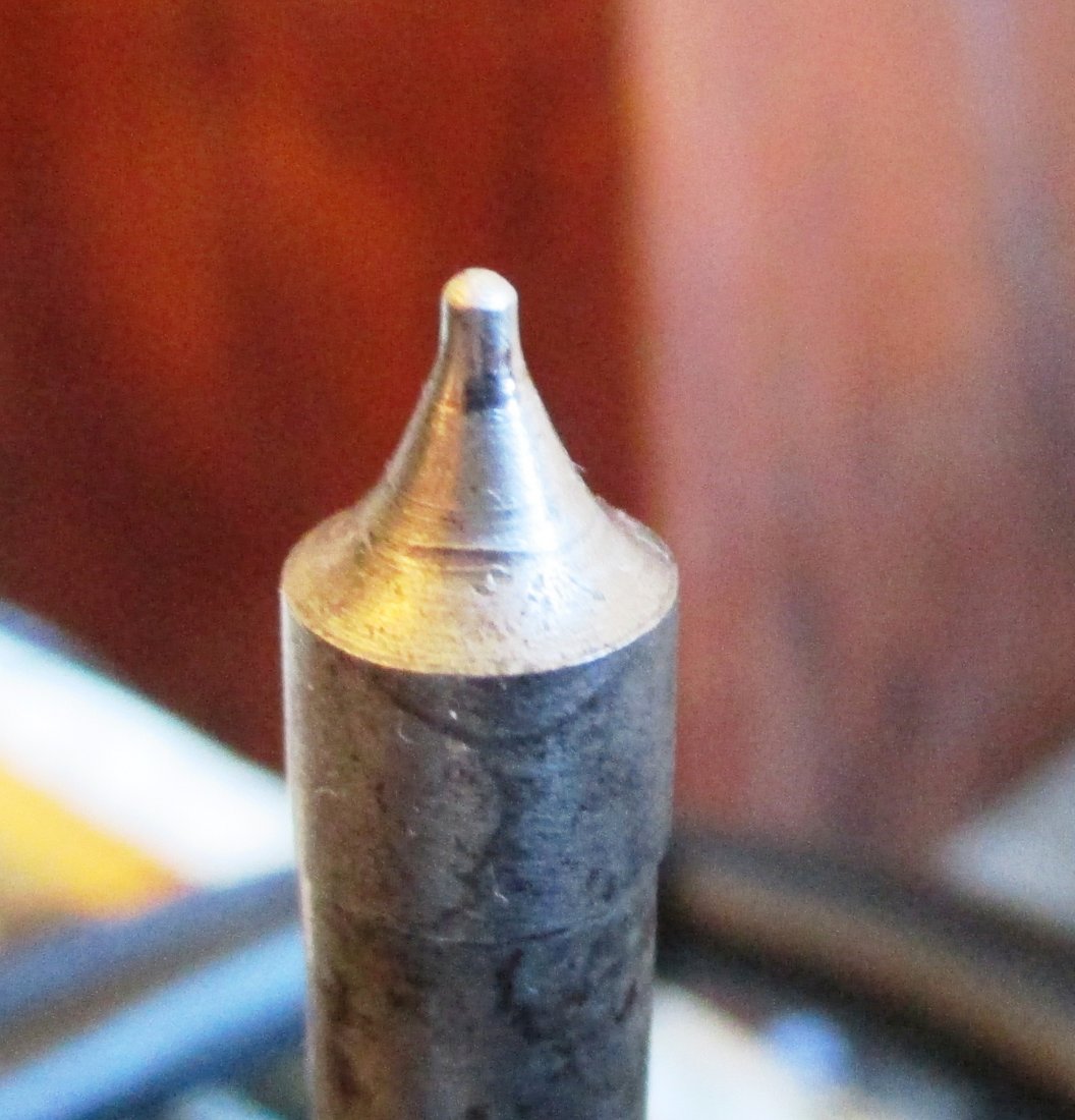

Hello Gents
Got some more pics of my gun.
1 pic is back of frame-no sign of the toggle hitting hard?
2-pic of extractor and firing pin in breech block
3-pic of firing pin tip
Thanks again for all the help.
You folks are the best!
Bob

In photo #2, it really shows the breechface depression.....unless the photo is tricking my eyes.

How about if it was extensively dry fired, and the owner tried to remove the resulting 'ridge' by use of a round stone in a drill...or even a drill bit...
It all looks smooth and regular, although a slightly different color than the rest of the flat surface there. I'm doubting a rotatory stone or burr..maybe a drill bit sharpened at a verrrrry shallow angle (which, itself, would be hard to center?), but a long time ago because the area does show some "age" in the pics. The base of the cone of the f.p.'s tip looks a little gnarly in the pics, how much dry firing would be necessary to achieve this?
Perhaps an experiment is in order. Pounding a sacrificial firing pin repeatedly into a sacrificial breech block would answer a lot of questions. As I understood it up until now, the damage risked by dry-firing was that the tip of the f.P. would work harden and become more brittle--enough to snap the tip off with the shock and momentum involved in the dry-fire. I'm still skeptical that a cone pounded into a cone would produce the mushrooming/upsetting around the hole.

I'm my opinion it's very unlikely that an expanding primer can cause the indent in the breech face.

I have a hard time visualizing dry firing causing this deformation. I would think dry firing would have caused the deformation to be convex not concave.
