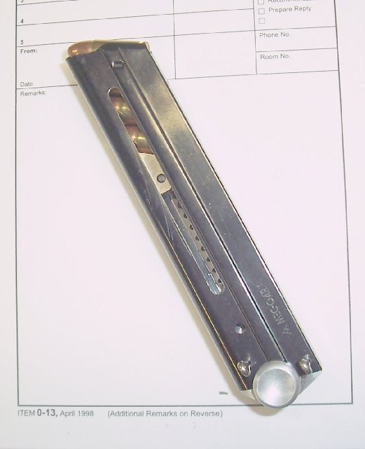

Hmmmm...The Mec-Gar button is black, my follower is 'gold'...It shows up pretty well without the extension...

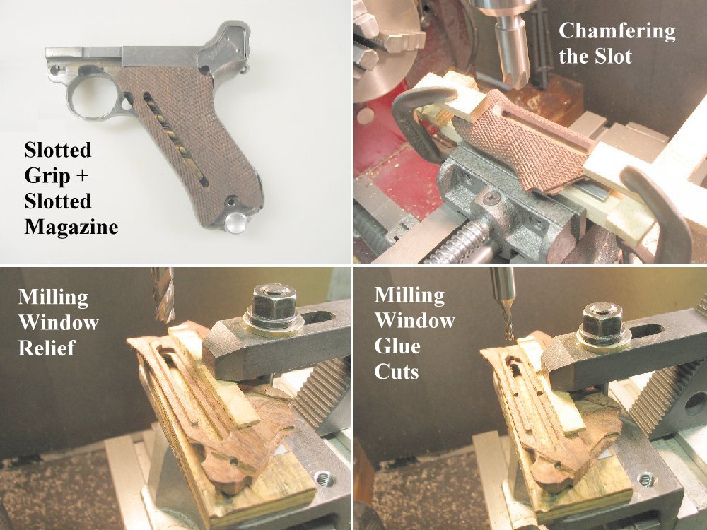

Continuing my Gonzo Grip Mod, left grip has the slot milled to line up with slot in modified magazine. Mine won't have the numbers or the offset slot to read them, or the offset mag button extension. It'll just show rounds in the magazine.
Here's a mockup of the grip and magazine with a couple rounds inserted...And chamfering the slot...I don't know if 'real' cartridge counter grips had chamfered slots, but it looks sorta nice...
Flipping the grip over and milling a relief for the polycarbonate 'window'...And also milling four small cuts for glue to hold the window from popping out...

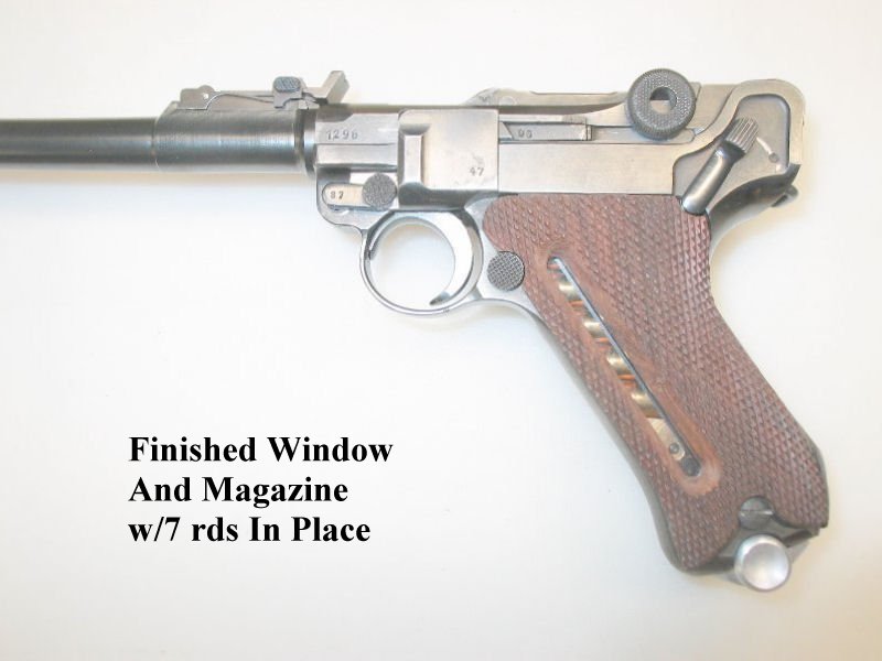

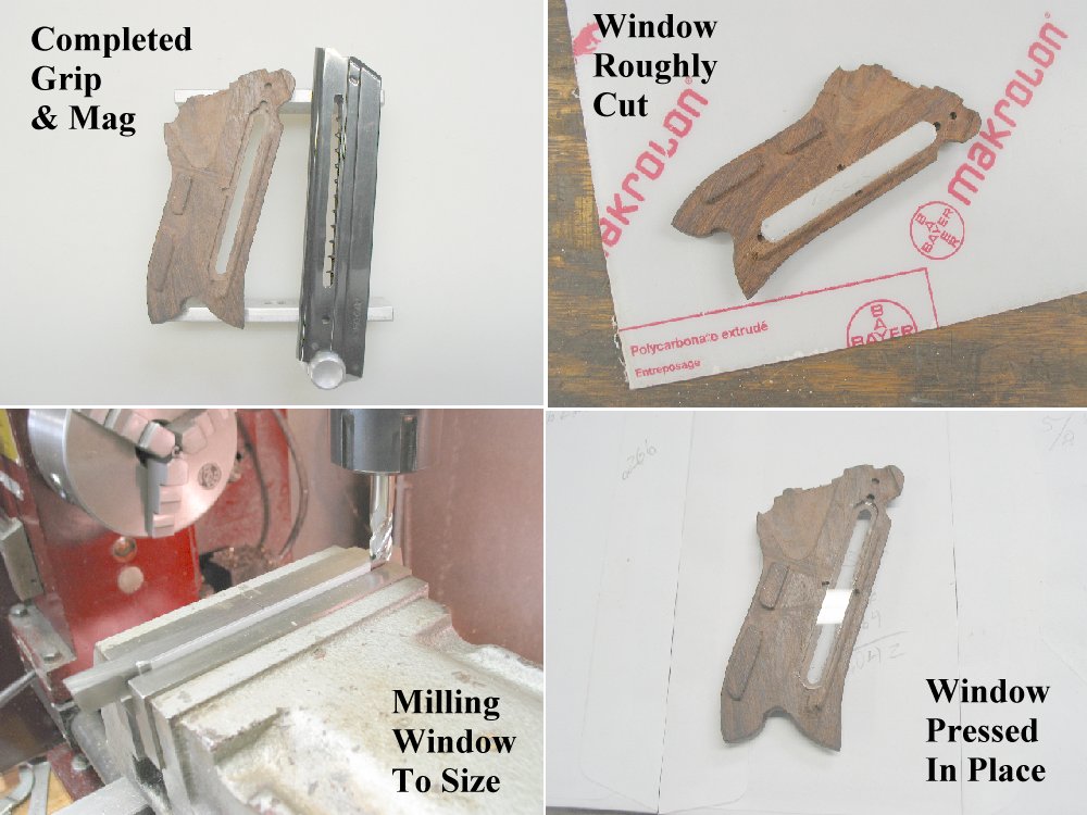

The grip alterations are complete. The magazine modification is complete. Now for the window.
Rough cutting a 7/16" piece of .060" polycarbonate; milling it down to 3/8"; and pressing it in place.
The finished gonzo grip counter on my artillery Luger. Greg Cote advertises this Mec-Gar magazine will hold eight rounds, but I think seven is more realistic.
I'll wait for Ithacadave to weigh in on what kind of glue/adhesive to use to hold the polycarbonate window in place. I don't want the adhesive to 'spread' or discolor the window, and since I have no experience with this material, I'll wait for more a experienced member to advise me.

I'll confess I've never needed to stick polycarbonate to wood. All my applications of it have been held in place with retainers or fasteners.
In order that the bonding agent not wick to unsightly locations, seems to me you need a high viscosity product that stays where it's put. I Googled a little and came up with a few possibilities:
Weld-On 55 and 56 are thick and clear, but I don't know how effective on wood.
http://www.cyberbond1.com/product-detail/apollo/2400/
Good ol' Superglue gel works on everything I've used it for, so far.
I still have that 8 1/2" X 11" sample sheet of cellulose acetate, if that will help. One suggestion I read on one of the woodworking forums is to prime the needed area on the wood to help eliminate porosity, for adhesives that like smooth surfaces...
Unread 11-09-2015, 12:15 AM   #31
I would consider rubber cement. It is very forgiving as far as spread/ooze goes. pretty much stays where you put it. A layer on both parts..you can rub it off of places it gets to before you mate them together. It doesn't take much to do the job either! Plus you CAN pry the parts apart..maybe..if you have to separate them. polycarbonate may have to be lightly sanded where the glue is to grip well if it's overly smooth/slick.
Superglue HATES clear plastic..I got some near my dollar store plastic glasses lenses once and just the vapors will cloud it.
