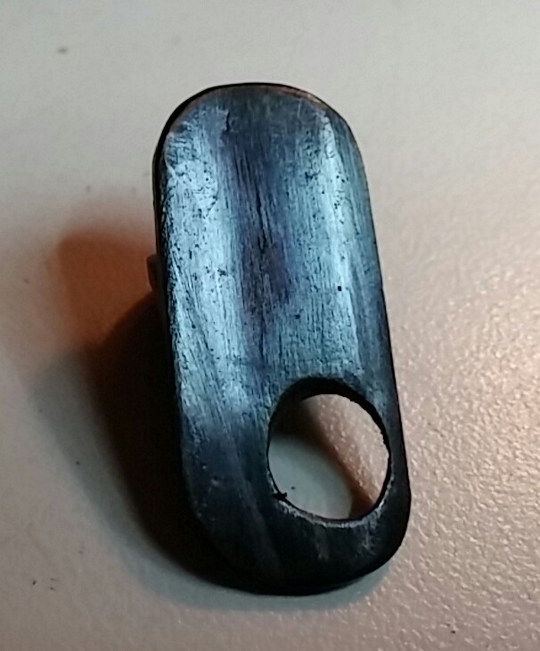

John, there's a "lip" inside the hole for the follower, right?

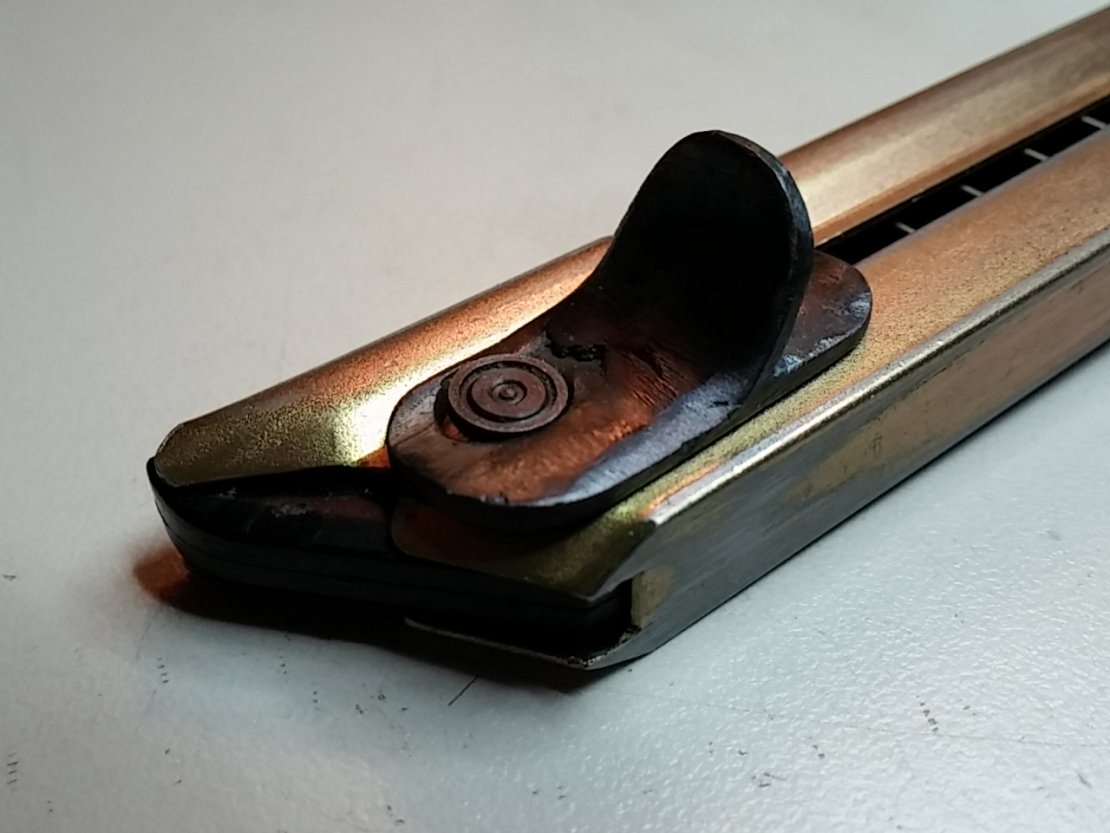

Eric, this might just do the job for you!
Here's the one I made for the mags for my Erma KGP69, contoured to the side of the mag, it works great. (In NY State, we're not supposed to load a mag with more than seven rounds, unless at a range or competition.)

Yes, their is a lip inside the hole. Jerry, I wish you could have been present there this year. There was much good discussion. Virginia? John & Mike

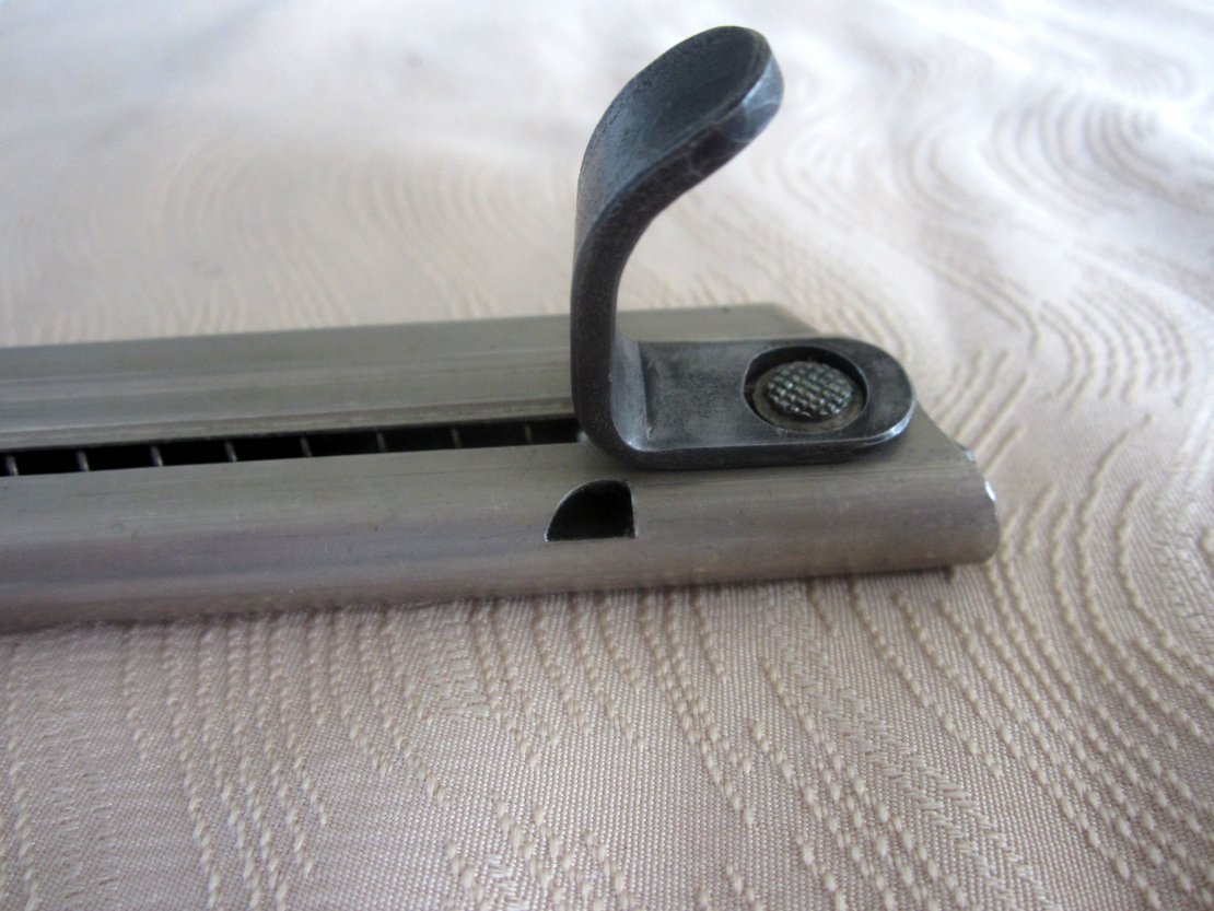

Yeah Jerry, I found the regular loading tool not too comfortable to use, so I decided to try to make one that was easier on the thumb. I think it worked out okay. While I was set up, I made a few extras. I don't plan on making any more though.

Neil sent me his loading tool made specically for lugers. It fits like a glove. The beauty is its simplicity~ No problem filling an entire mag!! Won't slip off! My Hero TKS ~~Eric

ithicaartist - what material is that made from? May try making one myself. I have one from a Bersa 380 that works fine, but it is the type that you push down, load one shell, lift up, slide shell back, repeat; not quite as convenient as the follower style.

Originally Posted by ChrisLL View Post
ithicaartist - what material is that made from? May try making one myself...
Chris, It's plain ol' mild steel, mig welded curved handle, ground to fit the thumb comfortably and ground on the back side to match the contours of these mags. KGP 69 factory mags have a concave channel instead of straight flat sides, and the factory loading tool kept slipping off, mostly 'cause it's flat on the back side, with nothing to keep it lined up/oriented. Also, the originals have a simple hole punched in them for the follower button. Experience showed that a little bit of a lip, like the Luger loading tools, keeps it hooked on; so my creation has one. It is thinner than the Luger tool's lip because there's not as much clearance behind the Erma follower buttons. If you don't have a mill to offset the hole, thereby creating the "lip", just go at it with a carbide bit on a Dremel or Foredom.
The lovely fire-blue/blackened color came right out of the toaster oven, set on "toast" for 10-15 min.
I like it, looks like it works great and has a lot of character. Love the heat/coloring treatment! Good suggestion on the lip, I imagine that makes a big difference. Thanks.
