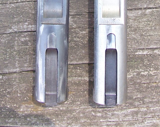

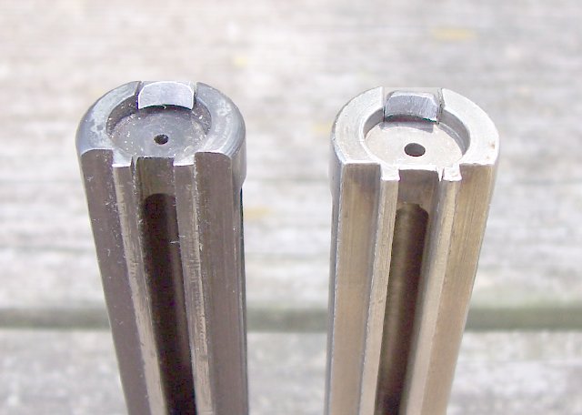

Got my stripped bolt with new extractor back from Don Schlickman today. Nice work! Fits great (hand fitted) and cycles cases flawlessly!
Don's extractor on left; original [chipped] on right on spare bolt.
I have no idea how it shoots. Powder is not sold here anymore.
