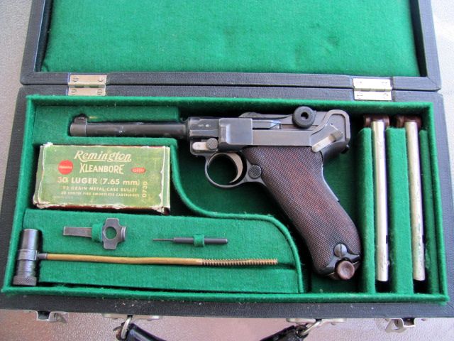

The 1906 French Commercial as seen in Kenyans' book, Lugers At Random, page 106 includes the subject of debate!~~~Eric

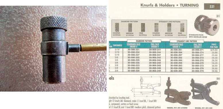

I am interested in knowing how the machinist that did this grease barrel knurled it with a single-direction knurl???
I've attached a pic of the grease barrel and a scan of knurling rollers...there is basically only two knurls; the crosshatch, and the straight knurl...In different pitches, but that's about it...
The only way I can think of to get a single-direction knurl is using two identical sets of knurl rollers, and use both right rollers or both left rollers, of the cross hatch set...
Even then they would have a tendency to 'ride off' to the side while knurling...
(The clamp type tool post knurling tool in the pic is the one I received; replaces the 'run it in' knurling tool I've used up to now - it is much better)...
And looking close, Neil hit it on the head...That grease barrel is crude...

Rich..The single knurling is proclaimed by some in the past to be original and correct but I have never been a proponent of that line of thinking...
The knurl on the barrel top you mean??? Do you know how they did it???

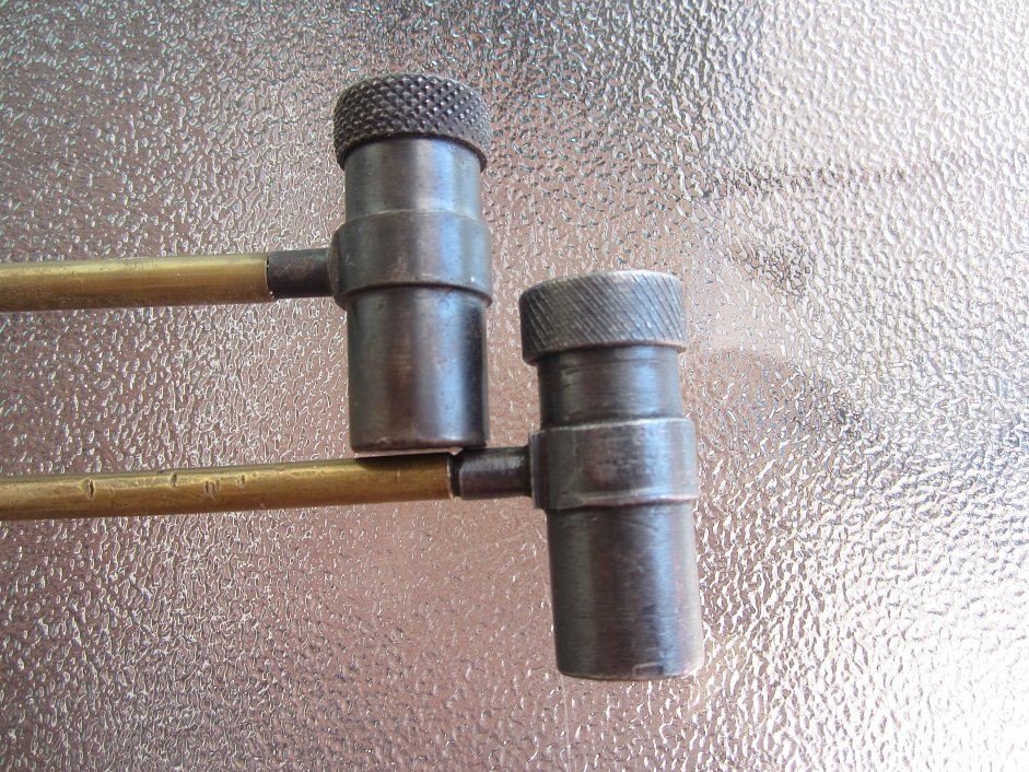

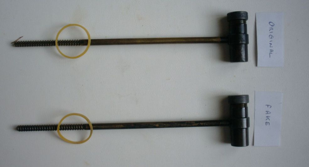

Does the fact that both are different make any difference in anyones' opinion? Do we know from who produced them and when?
Unread 06-25-2013, 09:50 PM   #33
Rich..No I don't.
Eric, Both or your rods screw into the barrel and that is what concerns me about them.

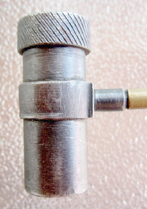

Originally Posted by Neil Young View Post
When you look at that close-up, it is apparent that the work is pretty crude. Even I can do better than that.
I think even Eric can do better than this...I lightened it to show the file marks, emery cloth scratches, gouges, uneven width of clamp...Sorry Eric...
I'm thinking now, from the crude look of the work, that the single knurl cut is from a misaligned knurling tool - only one roller cutting...(Well, displacing the metal actually)...I'm basing that on some of my own mistakes...But I learn, eventually...
By the time I'm 120, I'll have this work down pat...

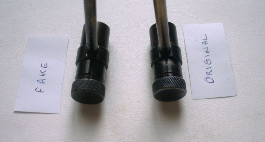

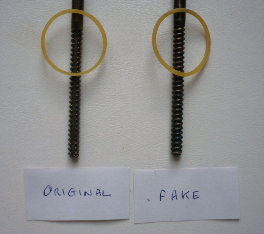

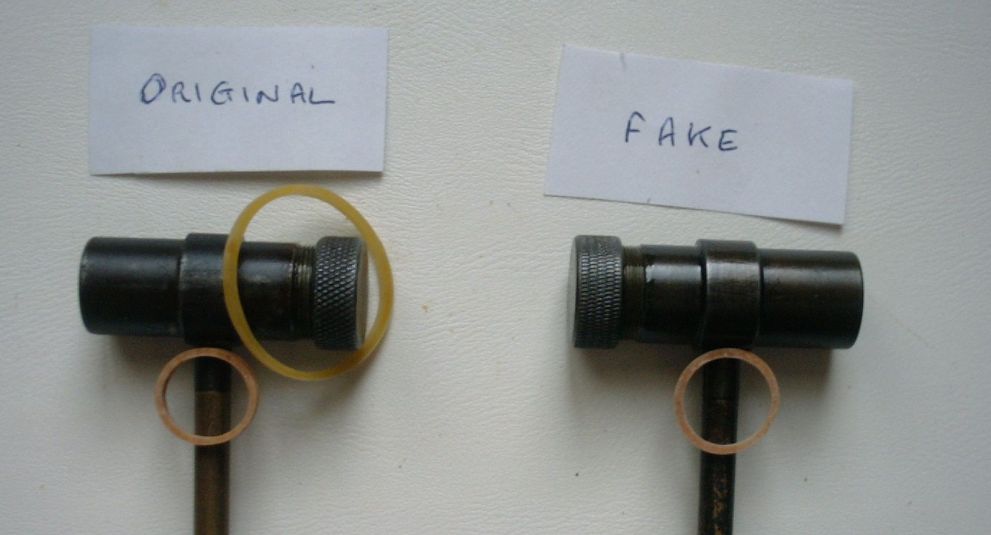

I do some pic in the past about original and repro , here they are from old post :
The following 4 members says Thank You to LU1900 for your post:
...???...Patrice's original screws into the barrel as well...
