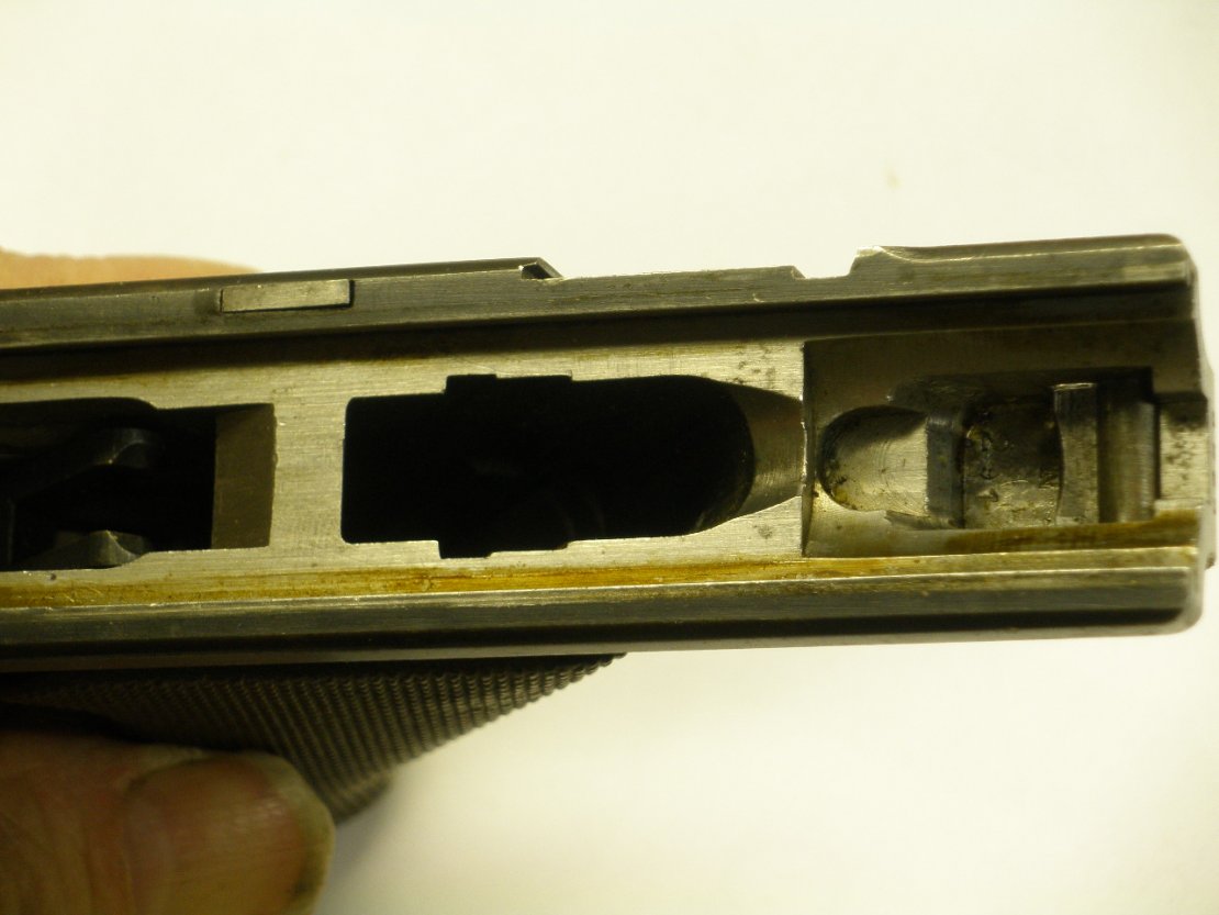

Hi,
Your pistol definitely has an ejector. It's visible on the right side of the receiver.
Are you talking about the lack of a hold open (visible inside on the top of the frame next to the magazine well)? Klaus addressed that above.

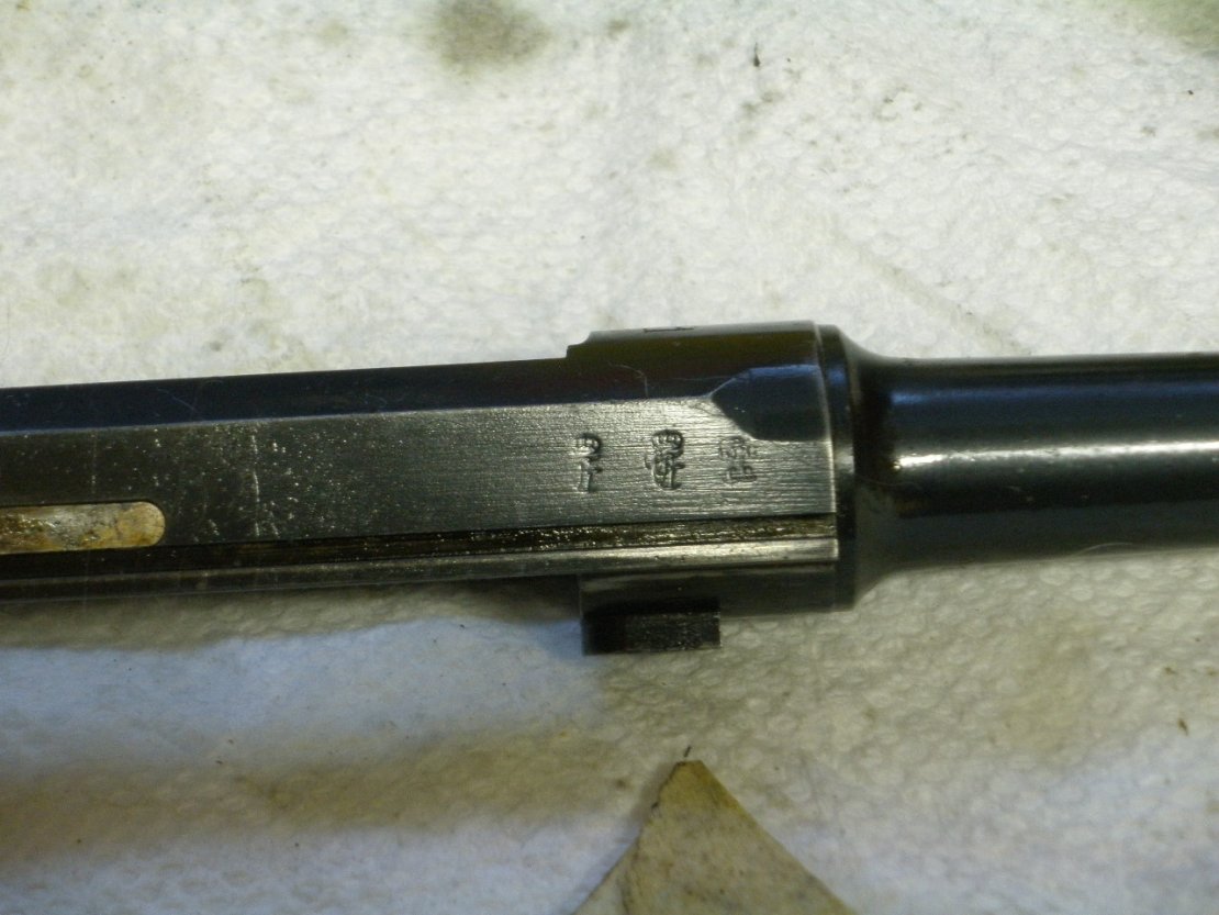

Bad overcast and wind let alone snow and winter so these are the best I can do for now.
I can get more pictures with outside light at some point but it will be a month or so before we have light that is not at a 20 degree angle

Unread 12-30-2012, 09:00 AM   #26

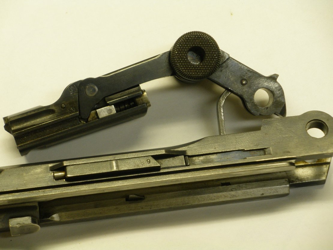

Your EJECTOR (on right side of the receiver) will not be numbered. But the EXTRACTOR (in the breech block) should have the last 2 digits of the serial marked internally. TH
Unread 12-30-2012, 10:09 AM   #27
You don't need to wait a month to take photos. Just experiment with indoor light, you will find something that works. That's the beauty of digital photography. Shoot it, check it, dump it.
Based on that one right side shot I do want more photos.

I can do that, just an overall coverage or specific areas?
And does that photo get the proof markings clearly enough? That is max for close even with the macro setting.

Y
How hard is that to get out? Looks like a small pin to drift over but don't want to assume

My advise, for what it is worth, assume that the extractor matches (almost a certainty) and don't mess with it.
Unread 12-31-2012, 01:57 PM   #31
Ron, Shame on you! Discouraging a Luger owner from knocking every pin out of the lady like that!
It's actually one of the easiest pins to take out. The extractor is held in by this pin..a little hook on the bottom and the pin slides thru it to capture the extractor. I recently took apart a very beautiful Krieghoff to authenticate it for matching numbers and with a small diameter brass rod it's pin just pushed out with a slight hand pressure. I was fascinated by the craftsmanship of the Krieghoff pin even..so beautifully made..rounded over so nicely on one end. The Germans in this period of gun making were true artists.
At any rate it's stupidly simple and if you have any eye hand coordination skills at all just do it. The spring behind the extractor is under some pressure but not enough to launch parts. Just sort of pushes into place, line it up and slip the pin back together. I always take pins out of a Luger from right to left unless it is obvious they have been peened over or some other indicator like a flat and a round end..push on the flat end. .
Or if you have no eye hand coordination skills Take Ron's not that bad advice! and don't mess with it. On my Friends Krieghoff it was an absolute necessity for authentication.

Proof marks on barrel under magnifying glass look like the
3, 2 and 4 symbols from this post
http://forum.lugerforum.com/showthread.php?t=27872
Barrel has an 8,82 behind the serial number and just in front of the index mark
A bit off center and to the right on top of the barrel is the 4 proof sumbol again. again.

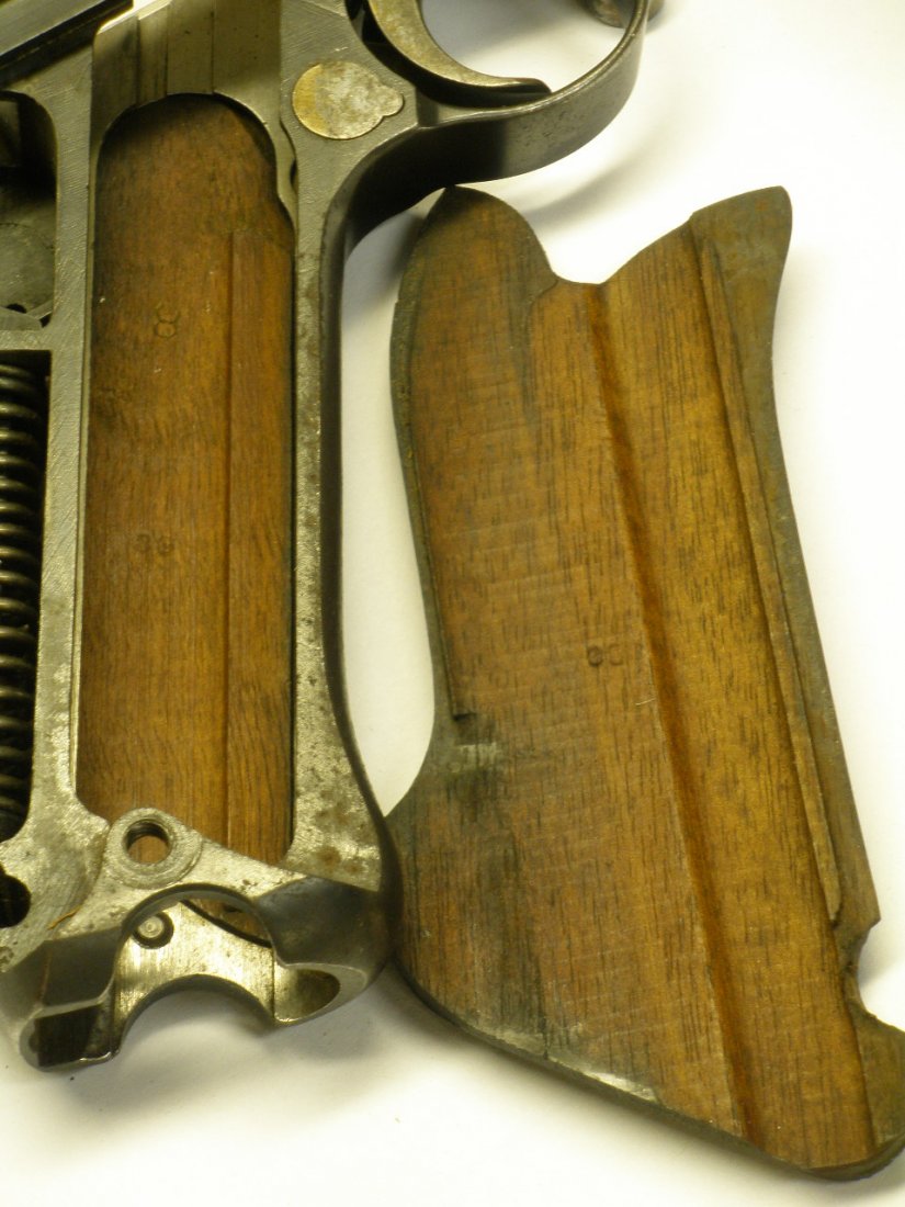

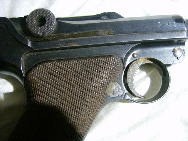

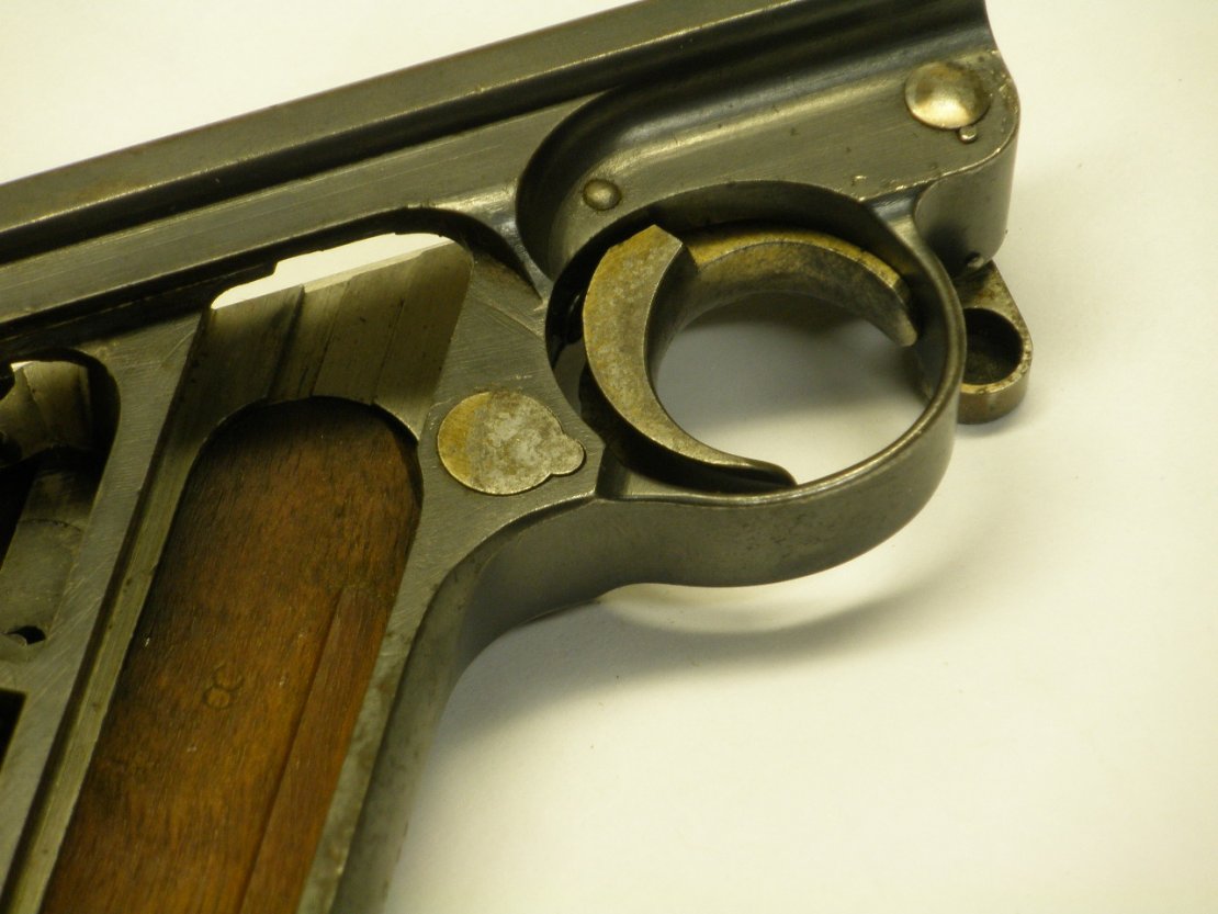

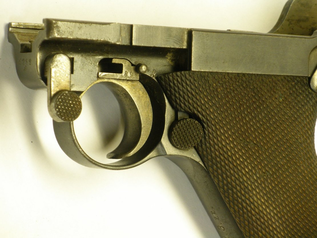

Here are more pictures with macro and better light
RC20 is offline   Reply With Quote
The following member says Thank You to RC20 for your post:

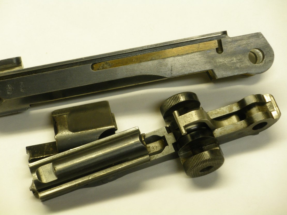

And a few more
