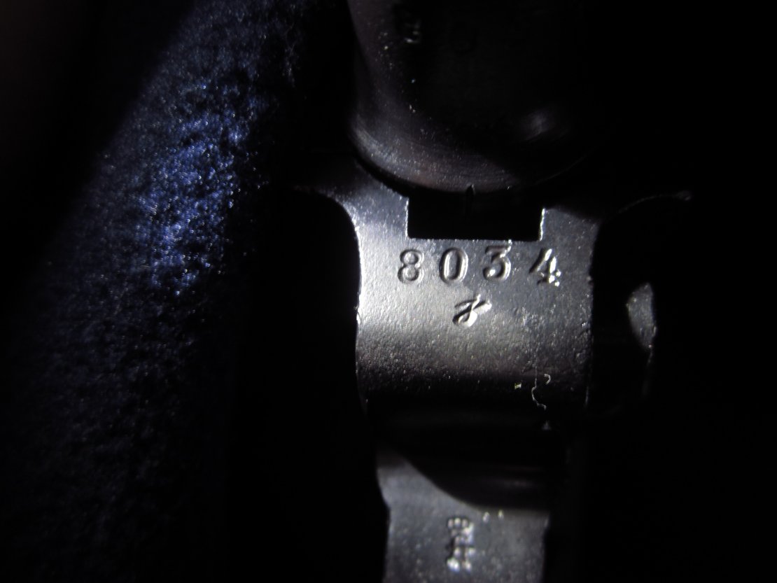

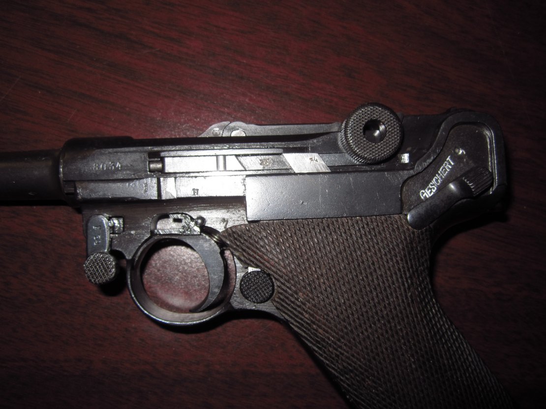

He Bill. I have a RC 1916 (I think Erfurt by all the imperial stampings compared to DWM that dont have them in the same places). Serial number 8034j. All matching on the bottom portion of the gun, except sear bar which has the SN marked out. Toggle is totally different being a S/42 toggle. But this luger has the relieved safety.
Im assuming a Erfurt luger. Let me know if its not.

The bottom portion is Erfurt

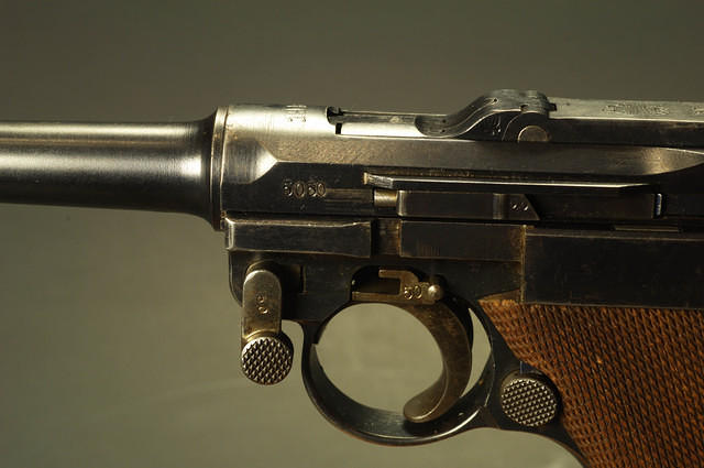

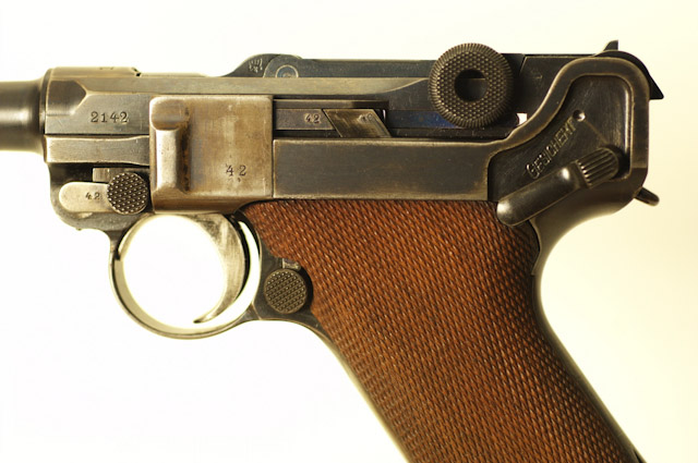

Default DWM 1916 Lugers UnRelieved and Relieved Sear Bars.
These are both 1916 DWM Lugers. The first is s/n 2142a and has an un-relieved sear bar. The second is 5050n and has a relieved sear bar. Both are numbered in the same location.
