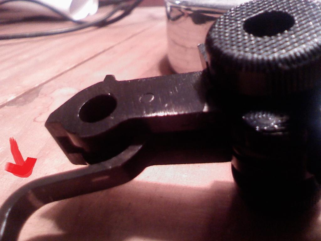

So I just noticed that all the other lugers I've seen have a silver safety bar thing I've seen (the piece that pops up when you put the safety on) and mine seems to be black; did some come with black ones?

No, this would be a serious indication of a reblue. Are you sure that it hasn't simply darkened from skin oils over time?
With the top cannon removed, raise this bar and look at the backside to see if that's in the white.
nope it's definitely not dirty and the back is also black.. the finish on that bar seems better than all the other parts :/

Based partly on the safety bar and firing pin being blued, I believe your pistol to have been refinished.
Do you think the entire thing or just those parts? Would there be a good way to tell by looking at the markings on the luger and checking for quality, clarity, etc?

The L shaped lever in the back of your side plate is normally in the white and not blued. Also, the S shaped rear toggle coupling link is normally in the white.

That is why I said "normally" in the white. One never knows what has happened to these guns in their lifetime. Now I believe the trigger plate lever PIN should be blued.

hmmm I thought I was buying an original finish luger. Guess I should have came here first! This L shaped thing on the back of the side plate, is that the trigger plate lever pin? Also, I did a quick google on rear toggle links and some come up blued (or at least black) on all of them.

No, the "L" shaped thing is the Trigger lever itself. The Lever pin would be the little bent rod, that holds the trigger lever into the sideplate at the bottom.
I'm not sure what you looked at when researching "toggle links", but what the members here were referring to was the tiny little pin, which secures the larger toggle axel pin in place. This little pin can be seen on the top, left hand side of the toggle joint, next to the knurled finger knob when looking down on the toggle. This tiny pin is supposed to be in the white, not blued.

I was referring to the coupling link here.
Oh ok I was looking at a different part of the toggle action. Still new to lugers so I guess I don't know what everyone is talking about.
