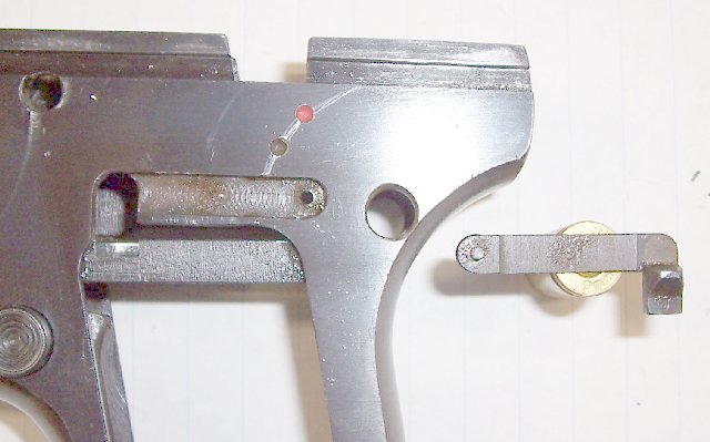

Actually mine actually doesn't have the safety issue most talk about but maybe it was from the amount of use it got before...
I did a bit of filing & stoning on the safety surfaces; also stoned the sear engagement surfaces. They were pretty rough...I have it functioning correctly now. Still has an awful trigger pull; I'll work on that next.
ETA: "Slick" posted the fix for the safety in this thread...
I punched out the magazine disconnect, I loathe those things. Pic attached if you feel the urge as well...

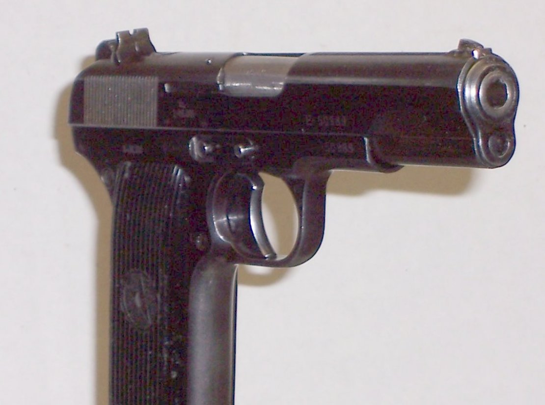

Check out this sight alignment...
The top of the barrel at the muzzle is .175" below the top plane of the slide...The barrel hood [at breech] is .040" below the top plane of the slide...and the rear sight is .280" above the top plane of the slide...
That's some locking lug engagement!!!
I also measured the trigger pull with my spring gage...It was a bit over 9 #...
