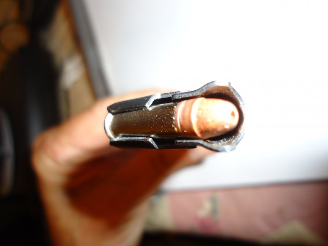

here are a few more pictures that you requested. If you tried the new mags and a good cleaning and polished the chamber you have done about all you can, lets face it these are not great guns ,maybe why they stopped selling them. good luck. this is a steel framed one and it started to jam right out of the box,

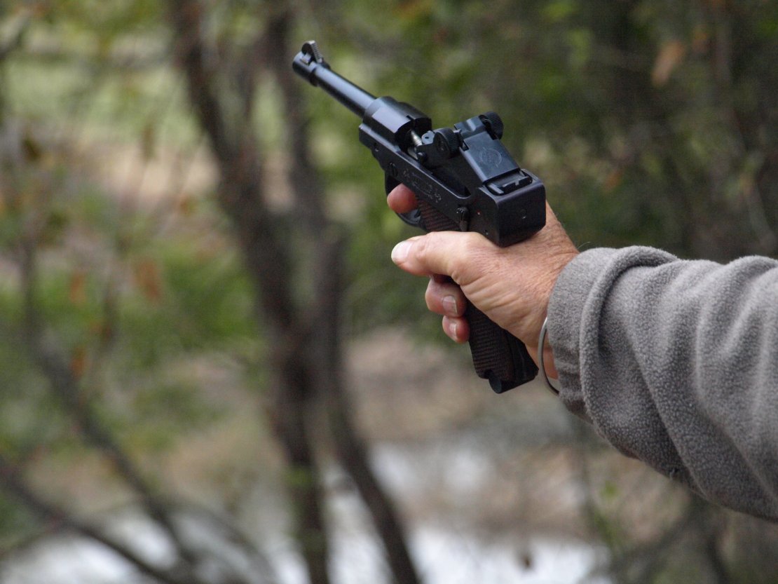

Think these were made to jam, this one did right out of the box. It now rests deep in the back of one of the gun safes, i doubt it will ever be fired again.

I would surely counsel using the lightest loading that would function the pistol, otherwise excessive pounding of parts can occur. One might think that an alloyed framed pistol would be more prone to super hot loads.
Originally Posted by padredan View Post
this pistol tends to like cci stingers, but it hasn't been fired with anything else. good luck.
STINGERS?! holy mackerel, these things are 40 gr and over 1600 fps...There is a correlation between firing less than a handful of these in three different Ermas with zinc uppers, and the front toggles that have broken--one on each gun. I'd even refrain from using them in any .22 auto pistol, unless directed by the mfgr., for fear of hammering the action against itself. These things definitely were not around when the Stoegers or Ermas were developed. Feed them what they were born to eat--standard velocity--or maybe less, if the springs are a little wussy. Mine have not snapped a toggle since I've stopped using anything perkier than CCI Minimag, and that is my absolute max. at 1230 fps.

Well guys, thanks for all the advice and the pictrures - much appreciated. After observing how the guns jammed with the original OEM magazines that I got with the guns when I purchased them, it looked like the mags weren't feeding correctly, so I picked up two new OEM mags - the guns performed a bit better with the new mags, but still jammed more than I was happy with, so I figured some feed lip adjustments would solve the problems - I learned pretty quickly that I don't have any capabilities when it comes to adjusting magazine feed lips. So, as of now, one of the mags (one of the new OEMs) works fairly well, and the other one is pretty much ruined and the two other original mags that came with the gun ar at a local gunsmith to see if he can work any magic with them.
