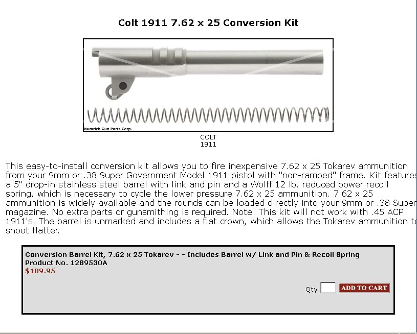

Here's something you might be interested in -
http://www.gunpartscorp.com/Products/1289530A.htm
Colt 1911 7.62 x 25 Conversion Kit
I'm interested myself...If I only knew if my RIAC bid won or not!!!
Unread 12-03-2012, 12:37 PM   #34
Just remember, in addition to changing the barrel, to change the mag, reoil spring & EJECTOR. TH
Oh Lord, something else for me get interested in. I am sooo weak when it comes to this type of thing. So far, I don't own a Govt. size 1911 in 9mm/38Super. I am more interested in a Commander size 9mm.
