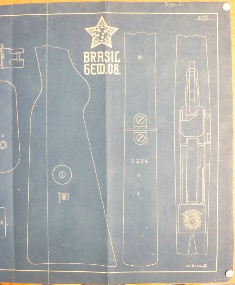

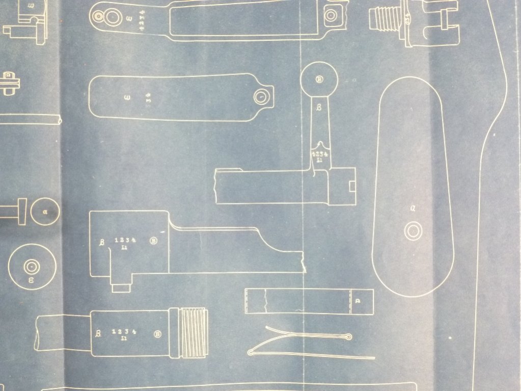

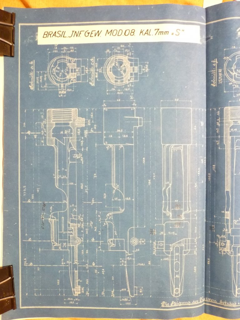

Unread 05-11-2021, 11:05 AM   #33
Douglas Jr.
Douglas Jr.'s Avatar
Location: South America
Posts: 948
Thanks: 598
Sorry my late answer on this topic, but I had to answer it on the other board.
So, I will just paste my answer to Albert's theory, as I wrote in Jan Still's forum.
______________________________________________________________________
Dear folks,
I am sorry for my delay to jump into this topic, but I have been busy with some new articles and the work at the museum.
After reading the messages, I must say that, with all the due respect to Albert, his theory does not hold up against some historical facts. Other military firearms contracts entered by Brazilian Armed Forces, shows that the "Circled-B proof" is not "related to a cartridge caliber" while other Foreign contract of very similar firearms does not bear the same marks.
First, we should remember that, at the very same time as Brazili was purchasing its Parabellums, Portugal was doing the same. And the Portuguese Army was not only buying the same number of guns (5000) but also in the same configuration: 7,65 mm Parabellum caliber, 4.75 in. bbl. and grip safety. However, even when chambered for the same caliber, the Portuguese guns have a completely different set of proofs (the "circled-Triangle").
It just makes no sense - from the point of viewn of a proofing system - to have this kind of "warning" concerning a "cartridge caliber" used in some guns while not using it in others, from the same time frame.
Now, let's take a look at the well known 1908 Brazilian Mauser Contract (chambered to 7 x 57). This contract is of special meaning as this purchased was made at the same time frame as the Brazilian Lugers and 3/4 of the total amount of the rifles were made at the DWM factory in Berlin. Every each of the 400,000 rifles of this sizable contract (fulfilled between 1908-1914) has the "circled-B" stamp (example below). Blueprints from the Mauser factory - from Jon Speed archives - present the "circled B" as the proof for the "Brazilianische Infanterie Gewehr 1908". It is worth mentioning that such mark has not been seen in any other foreign contract of identical guns (as the Mauser Model 1909 made for Argentina, chambered for the 7,65 x 53) or for the same cartridge (like the Mexican Mauser Model 1910, also chambered for the 7 x 57) just to mention two examples.
On the other hand, "circled-B" proof was also used on other Brazilian military firearms as Anthony Vanderlinden mentioned above.
Those facts clearly show that the "Circled-B" proof was intended to be used by DWM (and Mauser) factory inspectors to identify both rifles and pistols made for Brazilian Military, at least initially. The appearance of this marking in barrels (and barrels only) made at the same time is yet to be explained, although Ron and I have different opinions on this subject.
Greetings,
Douglas.

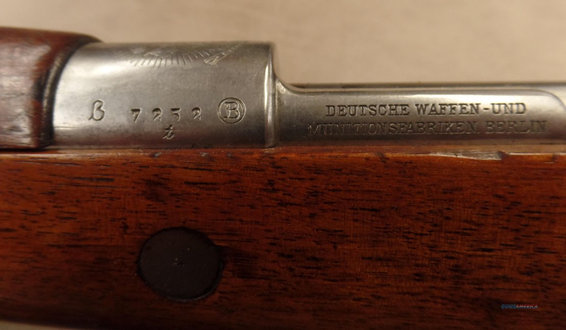

Unread 05-11-2021, 11:34 AM   #34
Doubs
Doubs's Avatar
Location: Byron, Georgia
Posts: 1,744
Thanks: 828
Thanked 1,794 Times in 592 Posts
FWIW, here is the receiver of an 1895 Chilean Mauser made by DWM that I used to own. The serial number is 519 and no suffix. It was an interesting rifle as the rifling and muzzle crown were distinctly different than other 1895 rifles I've owned.
