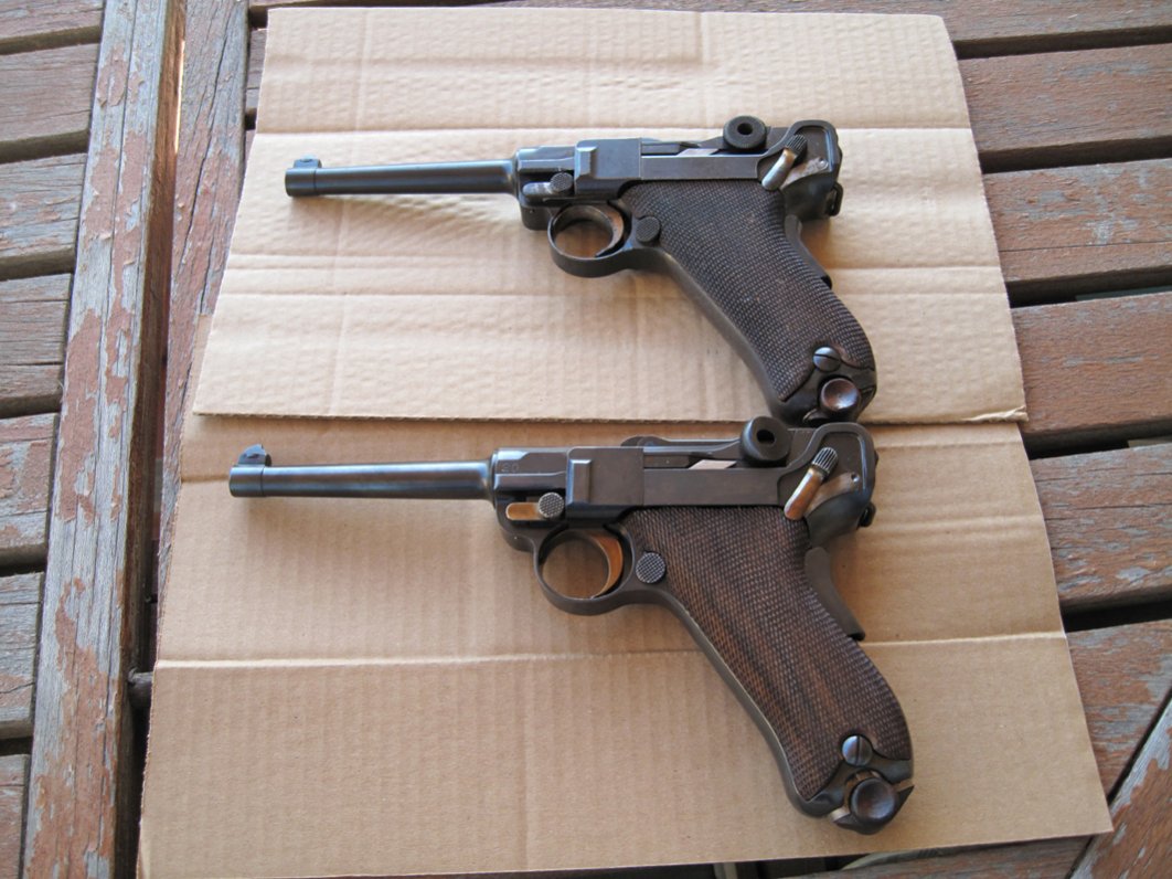

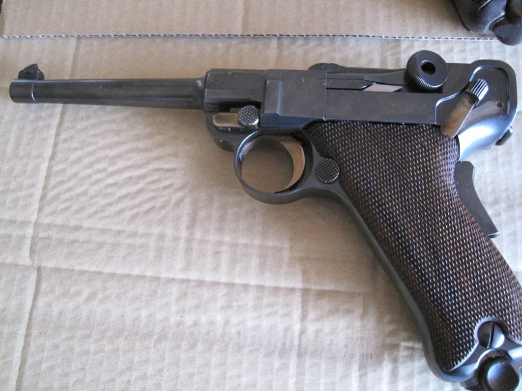

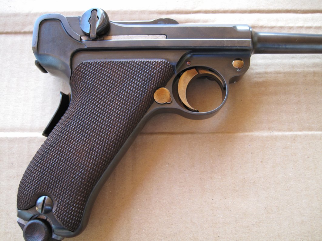

"In my “ignorant” opinion, this is a refinished gun with replacement parts and an obvious forgery that is an attempt to replicate an early Portuguese test piece. I also find it amusing that an outstanding restoration could not be made in Portugal…there are “artisans” in every country!"
Pepe,

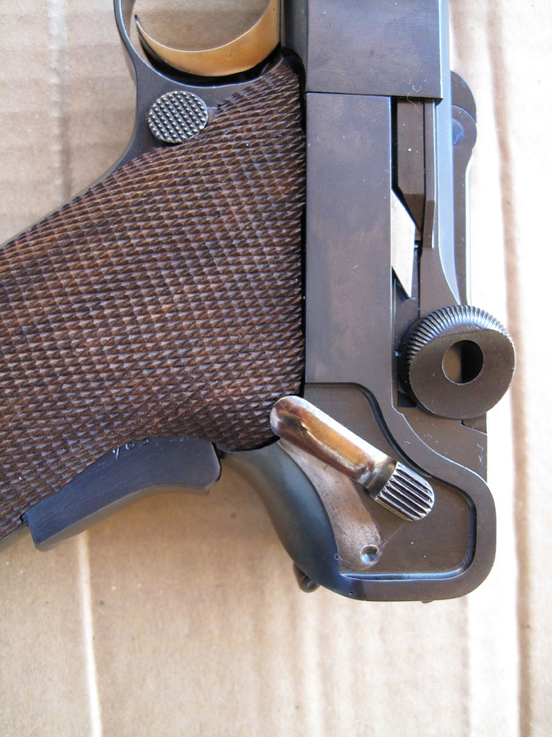

At the risk of being ignorant, jealous, ill informed, pregnant or brain damaged. I'm not an expert on the mechanical aspects of 1900 Lugers, but I'm with my friend Ron. Your Luger is a beautifully done, restored 1900. It is a nice Luger, but not original. The finish is too dark (black) and the straw on the trigger and safety is too bright, like brass.

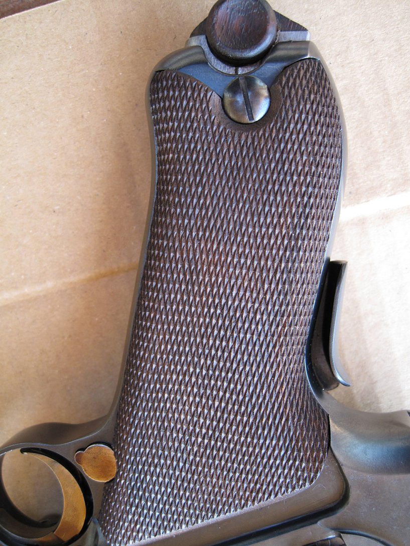

The new photos are better. They make the poor fitting grips that much more obvious. This is a restored gun with new, replacement grips.

I truely am ignorant and still a student..Why is the upper left corner of the sideplate rounded? Are 1900's this way? I don't own one so it looks odd to me...
No.

I'm guessing Rons' point about the toggle knobs might involve those flats....looking at my 1900, there is only a bare hint of one on the lock side, on the other side, the scallop cuts all the way into touching the serrations.

After reviewing the better images, I suppose that I can now make the following comments without rushing like other people. Remember that "you are innocent until proven guilty":
  1. The trigger, safety lever and takedown lever are restrawed; the ejector and toggle lock appear to be original straw;
  2. The left grip is a replacement and the right grip appears to be fine;
  3. The front sight appears to be fire-blued, but difficult to determine if it is original;
  4. I suppose that the major parts of the pistol has been refinished, with the restorer paying attention to specific details.
Lastly, this pistol is not a total 'fake', instead it has been partially restored; it has not been altered to enhance its rarity. Considering that these pistols are forbidden in certain EU countries such as Portugal (and France), I sometimes wonder which expert does an excellent restoration without creating to much exposure in that country.
Albert

Hi Albert, I know nothing about 1900 Lugers, so I'm not going to comment about this particular gun, I'll leave it to those who do. However, a type III safety on an early gun sounds like more than a "partial restoration". Also, to me, being partially restored is like being slightly pregnant, the end result is the same. Best regards, Norm

Pepe,
Si me puedo dirigir en Espanol, Tu pistola es un "Shooter' pero de la mejor calidad. Tiene ciertas deficiencias pero vale facilmente $1,000 US y quizas un poco mas.
Saludos,
Unread 05-16-2011, 07:54 PM   #39
Pepe,
Yes, it is worth $1000 or "un poco mas". The indiviual parts are probably worth that much. It is collectable at a basic level as an example of a Model 1900. It looks very nice and would be acceptable to hold a place in a beginning collection until a better example could be found. It is unfortunate that it has been improperly refinished, because an example that early is very difficult to find and would be worth much more if properly restored.
