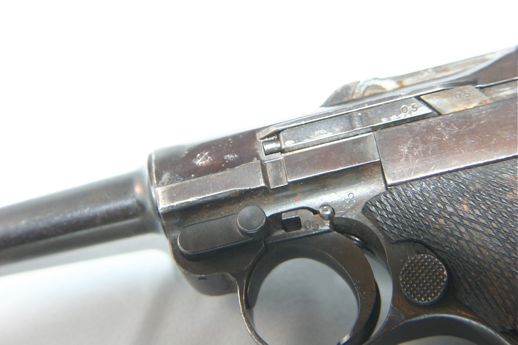

This is a mismatched gun with some problems: it appears to have been heavily buffed and reblued, I speculate that the chamber date and receiver SN have been "scrubbed," and the barrel appears to be a replacement. However, the basic gun seems to be a military DWM Luger produced in early 1914 to early 1916.
EVIDENCE:
Traces of military proofs on right side of receiver.
Lack of “extra” proofs and “L-P08” receiver cut rules out Erfurt production
Frame serial number 5905 without suffix and most visible parts #05 – early production for whatever year.
Stock lug on frame (introduced later 1913) rules out pre-1914 production
Unrelieved sear bar (relieved introduced later 1916) rules out post early 1916 production
This gun is a mess but it is a piece of history and if I am correct, it was carried by a soldier in the Great War.
KFS

On the left hand side the only readable marking is a Brit proof house stamp (Birmingham proof stamp - crossed swords).
On the left hand side there is an indentation, but not anything thats near a serial number, just looks like a ding that was too deep to rub out.
On the right hand side, there is, what's left of a S, almost like a dollar sign, towards the barrel, there's, what looks like a bell on its side.
I've taken some pics of the left and right side and although my camera skills aren't that good maybe you can pick out what they are.
On a closer look, the barrel does look like a replacement, the blue is a lot newer, but again, the stampings have been rubbed out before it was blued.
Are there any comments on the wooden bottom magazine, is this the correct period for this Luger?

The magazine appears correct to me (but I am not an expert) and it appears to be in beautiful condition. The "S like a dollar sign" in your initial post looks to me like the remains of a Gothic S. If so, that is significant. It would be part of one of three receiver acceptance stamps (originally with a crown above). If I am correct, and I may not be, along with the "evidence" I cited above, this would make your Luger a 1915 or 1916 DWM. As I stated, the evidence would make this an early 1914 to early 1916 Luger. According to Still's Central Power Pistols (pages 439-440), pre-A block (no SN suffix) 1914 below SN 9360 had XQF letter stamps (no S); but pre-A block 1915 had SES stamps and pre-A block 1916 had HSS stamps. Based on the location of the mark directly under the receiver opening, it is probably the first letter of three - making this 1915 DWM 5905. Again I am not an expert and would welcome a real expert to tell me that I am on track or full of s***. KFS

The takedown lever is either a Swiss 06/29 one, or a post war Mauser one.
Forum menber Tom Heller has had excellent reproduction sideplates available. Dropped one on my 1917 LP08 which had a trigger pull from hell and it cured it immediately. Blue matches the gun blue perfectl.

It is a mismatching Luger, as said above. Numbering is in military style, there are remains of military acceptance proofs on the right side of the receiver and there is the notch for the Artillery rear sight over the receiver.
My bet is that this guns started its life as an Artillery Luger (LP.08) during WWI and was rebarreled with the more conventional 4 inches (100mm) barrel afer the war. Probably it was at this time that the toggle was changed in order to have the correct rear sights (fixed) for its new barrel. It was most likely aimed for civilian market after WWI.
Anyway, it would display nicely in a shadow box of your father's belonging and awards.
