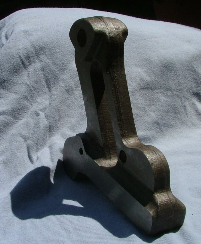

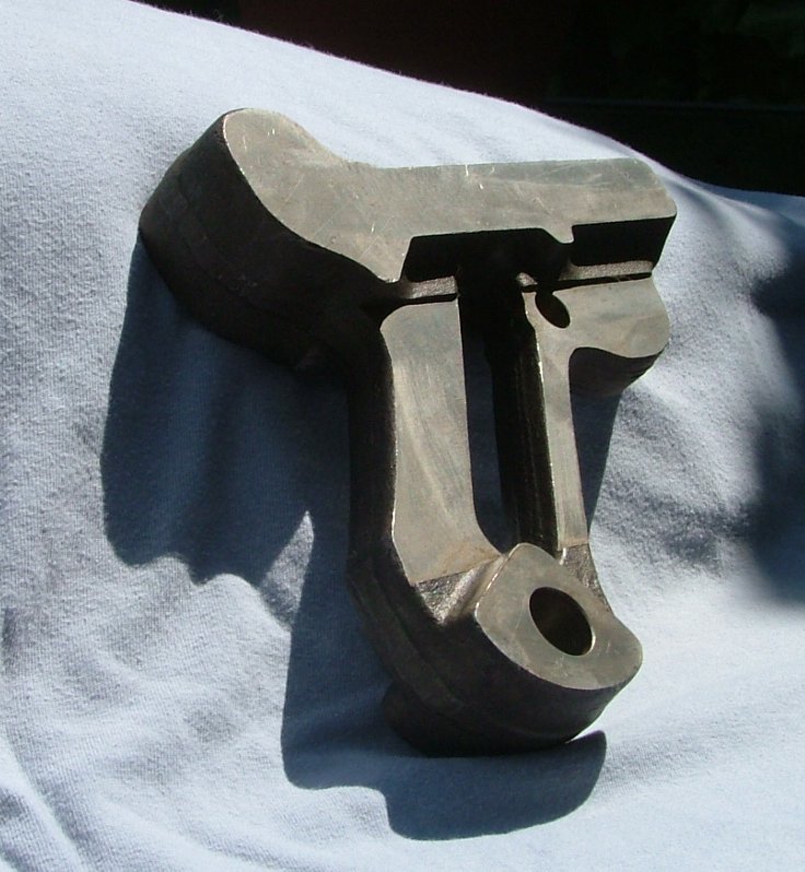

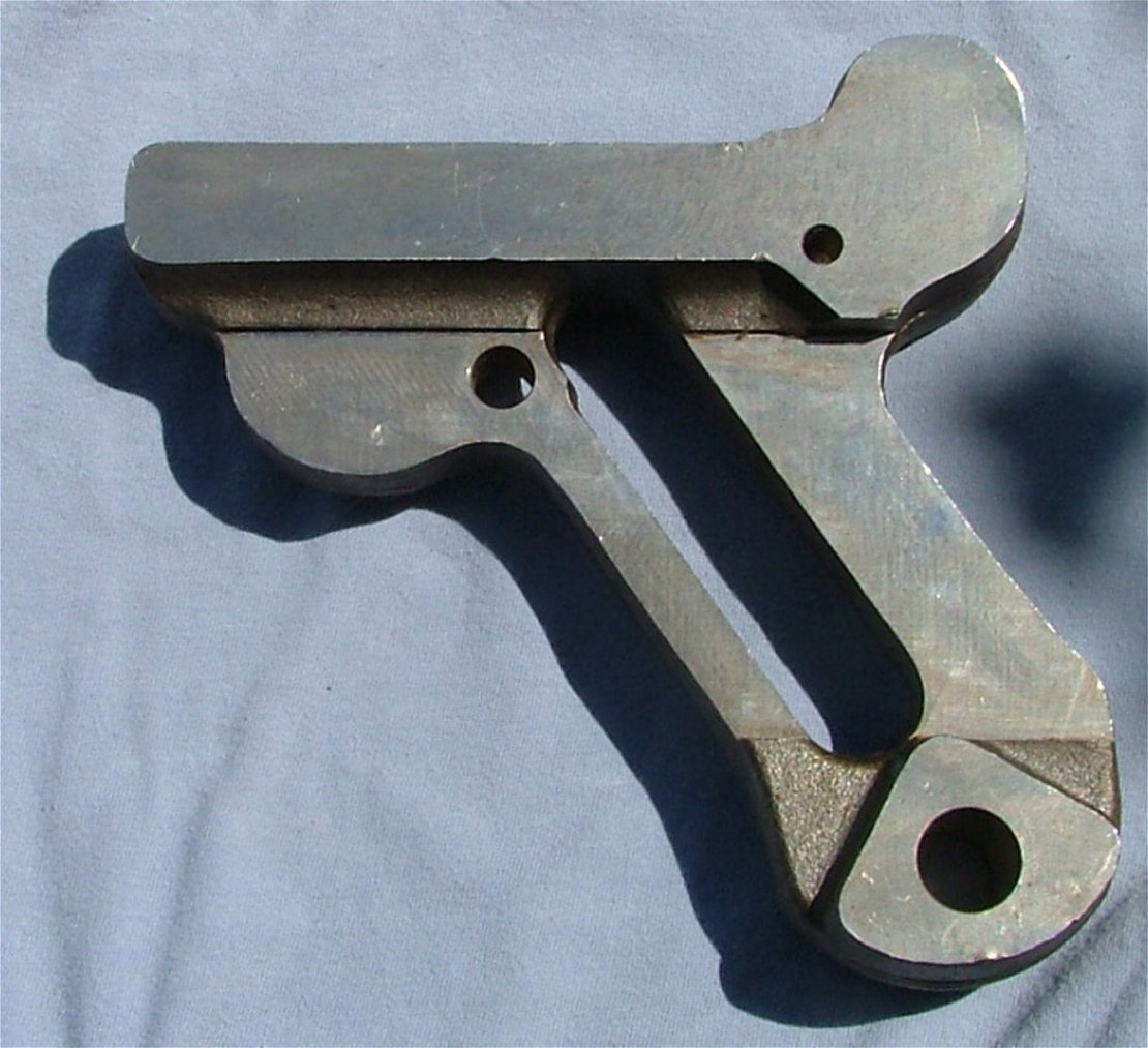

Unread 06-12-2009, 02:31 PM   #23
Here's a Mauser forging that surfaced a few weeks ago. This is a postwar 1972-ish 06/73 frame in the making.
