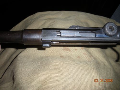

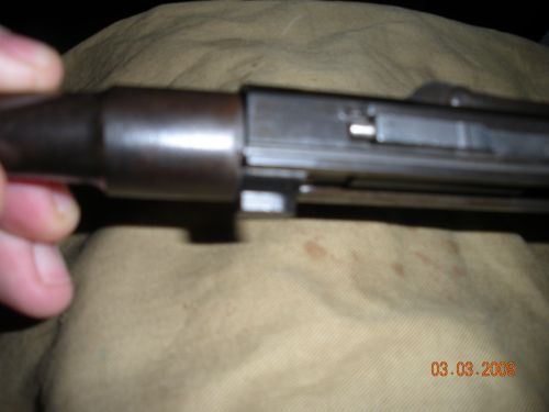

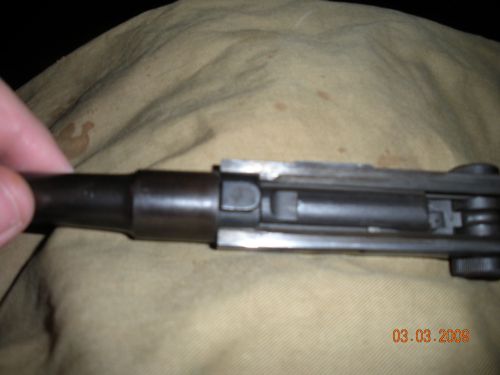

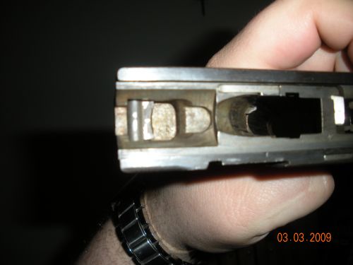

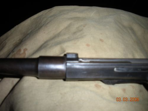

This is weird but I haven't noticed it anywhere poking around the forum my luger has a "nub" under the barrel where I think the witness marks should be that fits into a knotch when reassembled I haven't seen this anywhere the barrel's I have seen are rounded there with the witness mark am I wrong or is this another mystery I can add to the list for this gun.
Thanks!
Mike

This is a WAG...but the lack of front sight and rounded conical barrel make me think it is intended to insert into something...maybe firing a blank cartridge...an igniter...or maybe a launcher for something...
I'm thinking that something might clamp onto the barrel, at the rear...or maybe the pistol itself is clamped into something...for signaling maybe???
Definitely something that bears investigation...

Mike..don't bother to look for witness marks..a large portion of your top Cannon/fork has been ground away and replaced by the oversized barrel. I would say at least 3/8ths or more. This means your chamber area..where the date would normally be... must be quite narrow.
I would consider this to be a severe structural breach bordering on what the heck were they thinking?
Regardless of any serial # on the barrel...this is not a real Luger anymore. It has been severly comprimised.
I don't remember from reading the thread if you ever mentioned the calibur. Is there a hole in the barrel? What size it it and is there a chamber area? Have you ever seated a round in it?
I just re read the thread.. John Sabato says-by machining off the face of the upper and using a homemade barrel... This is not a factory modification in my opinion. This exactly my opinion and I sure would NOT fire a round in this weapon.
Ed Tinker says this looks like a proof barrel and I disagree. Any Luger made with a stronger thicker barrel could start where they all do..no need to grind off the face of the top cannon in the breech area..simply make the barrel fatter. In your pistols case they ground away metal and then replaced it with the same amount. No gain there.
Besides which.. a fatter stronger barrel defeats the purpose of proofing. A proof cartridge is made 50% hotter to proof the barrel. In other words.. with much more pressure will the type of barrel made and used stand up to extroidinary pressures? Makes no sense to make a bigger fatter barrel.
This looks very much like a Bubba hack job to me.
Another important aspect to consider, if this were some special factory test piece it would have SOME markings indicating something about it.
I have a 1917 Imperial Navy that has a very large V stamped over the chamber. My belief is that it stands for Verschucs(spelling?) or test. Of course test can also be Pr�¼fung. This and one other 4" pistol I discovered in Europe were marked the same way. What they were testing I can't say for sure but it might have been the change from the truncated cone cartridge to the ogive shaped ones.
The front sight is likely missing because bubba did not have the machine skills to mill it on there. He simply carved out a barrel from round stock and left the sight off to be silver soldered on later.

Mike, I believe the nub you speak of is the stop on the bottom of the barrel. The witness marks would be towards the muzzle end a quarter inch or so, This is the portion of your pistol that has been ground off.
There is actually no reason for witness marks on your barrel. These were ostensibly to align the sight to the top dead center. Yours has no sight to align.
Why would someone do all these things? The longer you look into Lugers you will find many bored machinests did this and much more. Why? Because in days past these pistols were worth much less than they are today and were a machinists playground. Just as the thousands of 98 K rifles that were converted into hunting rifles. Now worth a couple hundred bucks but if not monkeyed with are worth thousands.
As far as your serial # goes..It's difficult to argue one way or the other because they cancel each other out. Anyone capable of machining and installing this barrel certainly has a set of number dies laying around. Everything else is numbered 24..why not my new barrel? Who's to say?
Here's another thing to speculate on..The chamber got ground away because the bored machinest couldn't quite get a proper fit on the new barrel in the chamber area so the easiest place to take up the slack is to grind away the receiver untill it snugs up.
One can speculate untill the cows come home and it's mostly a guessing game of conjecture.
All I know is no competent gunsmith would willingly grind away that much of the receiver, part of the structural integrity of the original design. Not no how, no way. Bubba did it.

Are the numbers on the barrel the same font/size as the other numbers on the pistol?
