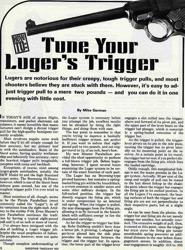

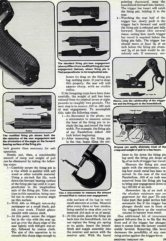

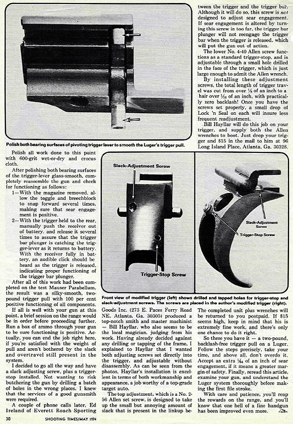

I suppose after 28 years no one will get their knickers in a wad if I post .jpg images of the Shooting Times article on trigger adjustment. They are a bit fuzzy but I think they are OK for folks that have enough gunsmithing skills. If you can't grasp what the procedure is, you probably shouldn't be messing with the gun in the first place. I assume absolutely no liability for any modifications to any Luger using this aricle...it is provided for information purposes only and should not be attempted by anyone other than a qualified and licensed gunsmith.

Good article.
My 1937 S/42 had a very, very strong trigger spring in it, which forced me to build up so much pressure that I would twist the gun slightly sideways and downwards. Quite annoying. A simple fix was the installation of a softer (Swiss 06/29) trigger spring. Made a world of difference.
So before bringing out the drills, taps and screws, try the simple approach first

I suppose after 28 years no one will get their knickers in a wad if I post .jpg images of the Shooting Times article...
Way to go, Ron! Take a walk on the wild side...
In that article's first page, the upper pic of a Luger barrel...What model/make Luger is that??? Is that the Mauser (with a 6" barrel) that the author was referring to???
Unread 07-29-2012, 11:27 AM   #26
I should have posted that after I took a nap...it has been 38 years since the article was published.

Excellent! Thank you! Any chance you can Re-post this article in a fresh thread and have it stickied? That would be invaluable for all current and future members.

Making a Luger trigger mimic that of an M1911 is a fool's errand. In effect, this method eliminates the first stage of the trigger action that was designed and built in a two stage pattern. It is an unsafe procedure that cannot be recommended under any circumstances.

Originally Posted by Hugh View Post
by SLIGHTLY bending the front tang of the trigger outward and/or VERY SLIGHTLY bending the trigger lip that engages the trigger lever downward.
Someone had done this to my 29/70 Mauser. I carefully straightened it out to regain the famous mile-long pull!
I challenge that statement. What evidence do you have to support any of that?
I would hardly qualify the Luger as having a "two stage" trigger. A proper two stage trigger divides the total pull between the two stages, requiring a greater and longer pull in the first stage, and requiring a shorter but much lighter (not to mention crisp) pull in the second. The Luger's pull consists of taking the slack out f the mechanism, which takes a couple ounces, and then the full 7-8lbs in the last bit of movement. I also fail to see how such modifications are unsafe when done properly. If the instructions are followed to a T and the user does not over adjust the trigger to break on a hair, the pistol should work perfectly fine and be 100% safe. I'm sure Herbert Werle does a very similar procedure to this, and he seems to enjoy a very good reputation, both here and abroad.

I am not sure what you are saying, but in the terminology of the article under discussion, the mutually bearing surfaces of the trigger bar and the firing pin are cut at an angle so as to interlock, for reasons of safety. If anyone here is foolish and reckless enough to try this modification at home, I'm willing to bet that I can fire his modified Luger without touching its trigger.
